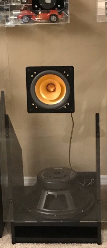

I am working on a Pass SLOB (Slot Loaded Open Baffle) with a 15" Eminence driver on the bottom and a Cube Audio FC8 full range driver on the top. Jeff McCabe will build the cabinets for me. The baffle board itself is 1/2" thick clear acrylic which has better damping than MDF or plywood, and you can see through it !
The X-Over will be built into a DIY preamp using PC boards from DIYAudio, and Pass's LxMini and NuTube circuits. The NuTube will provide the gain, volume and balance controls and input selector switching. The LXMini will provide the crossover and EQ, based on Pass's experiments at his studio in Sea Ranch, CA. Level setting between the upper and lower amps will be accomplished using pink noise, an iPhone hosted RTM app, and the Studio Six Digital iTestMic2.
Amplifiers: Low pass: Aleph 5 (90 watts) and DIY First Watt F5 Turbo V2 (140 watts). High pass: First Watt J2 (25 watts), DIY Pass / Sony VFET (15 watts), and an Elekit TU-8600 (9 300B watts) I am building. It should be ready for audition later this fall. I plan to have a GAS Music Session sometime in November (after Halloween). I'll keep you guys and gals posted.
Here's some pics:

The baffle size is set for the full-range driver - it is sufficient for its range but not so big as to screw up the room acoustics - a big issue for big baffle and panel speakers. The bass driver is slot-loaded so that the impedance of the forward face is several times that of the back face. This gives a 3dB improvement in gain at the listener position. EQ in the electronic X-over takes care of the rest. The speaker / X-over combination is essentially flat from about 35 Hz to 20Khz.
Big baffles have limited utility because of the very wide spectrum of wavelengths loudspeakers must cover, (>50' to <0.5") Below 100 Hz (~10' in wavelength) you are in the acoustic Rayleigh region where all speakers become omni-directional and the room acoustics dominate, thus the effective lower limit for dipole operation is about 100 Hz unless you are in free space (say, your backyard). Hence baffles larger than 20" x 40" are pretty much a waste of lumber.
This particular speaker was designed jointly by Nelson Pass and Siegfried Linkwitz (RIP). I trust their judgement. Herb Reichert of Stereophile has heard it and speaks very highly of its performance.

This is, EXACTLY, Pass's baffle size and design - 20" x 40". He gave me a copy of his drawing.
I will not give it to you - you need to get a copy from Pass directly. Good luck !

They sound wonderful. You need either a miniDSP 2x4 HD or an analog EQ / crossover to bi-amp. The Cube Audio only needs about 15W. I use a First Watt J2 for the high pass. The woofer needs about 100W. I have used both a Pass Aleph 5 (60W into 8 ohms) and a FW F5 Turbo V.2 which makes about 140W. Here is a new picture. The 1/2" thick acrylic baffle lets me keep an eye on the cat !
