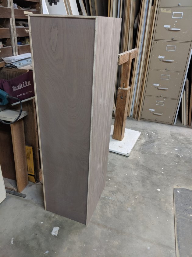

The planning to get everything just right requires a fair amount of forethought. All pieces are cut at the same time, so the settings on the saw blade are maintained throughout. It's really the only way to keep things uniform. The sides were marked and glued with a few pin nails to help keep things aligned. Again, if I did it again, dados would be my weapon of choice.
The mid cab enclosure glued in place
The mitered corners I was complaining about. Getting this perfect was terrifying. You only get one shot to get it right, and if it goes south, I would have to reveneer it, completely losing the continuous grain and the colour would be off. Don't use preveneered ply for speakers!
The continuous grain!

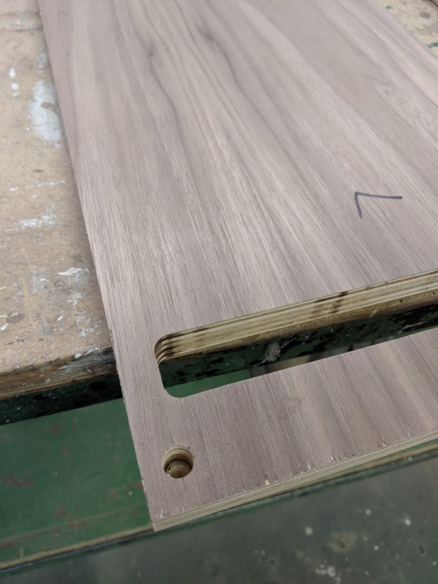

The front baffle was tricky business. At this point I can't cut the woofer holes in the front part of the baffle, as I wouldn't have enough material for a router bit bearing when routing the hardwood edges that will go in after the baffle has been glue in place. But I can't chamfer the rear of the driver hole if I cut the hole after the baffle is glued in. So I had to pre-cut the woofer hole in the rear piece of the front baffle but not the front pice. So here the woofer is being test fit
The front piece of the front baffle. The holes are drilled from the back to place the grill magnets about 1 to 2 mm from the front surface. The slot port was cut in both the front and rear pieces of the front baffle at this point, by laying each one in place in the cabinet and using a flush trim bit with the router. The front and rear baffle slot port cutouts have to be cut individually as the flush cut bit isn't long enough to cut 1.5 in of material and still have the bearing follow the slot of the cabinet.
Doweling glued in place to hold the magnets in place and fill the voids.
