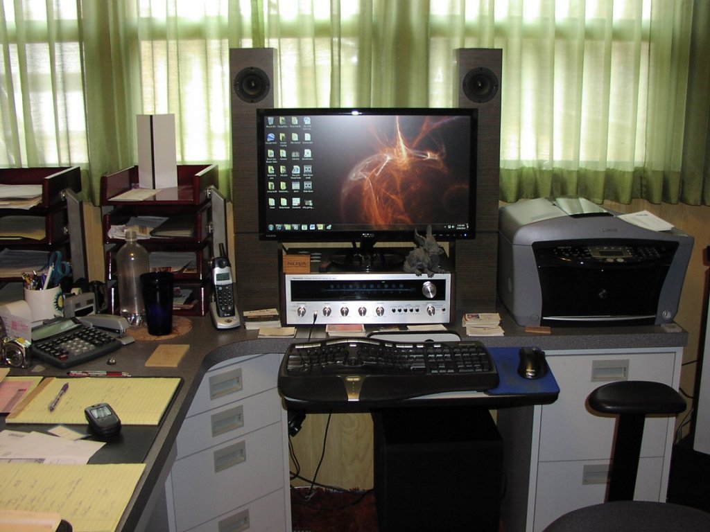

Something to consider: just because you have have had trouble integrating a sub doesn't mean it has to be that way. I have the LGK 1.0s on my desk with a servo controlled sub underneath and the integration is seamless. It just sounds like the LGKs play all the way down. As an example, when I hooked up a new unbroken-in pair of X-LS Encores to check out, I was amazed at how good the bass was. Then I realized I had forgotten to turn the sub off.
If you don't want the width of a 12" servo sub under your desk you could go with Rythmik's F8. While it doesn't play as low as the 12, it's 4" narrower. On the other hand, since it has two drivers it is taller. At 20" tall it might not fit under your desk but could fit beside the desk or in a corner. Then again, the 12" sub doesn't have to be under the desk either.
When I tried larger speakers like the N1X and X-LS Encore on my desk I was never satisfied. Sitting that close to them, they didn't image near as well as the LGKs. Also, they took up a lot of real estate on my desk. Way more than I was willing to give up.
