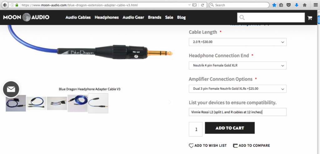

Moon Audio to make you a cable (I recommend 2 feet long, with a L/R split at 12 inches) that converts from
(2) 3-pin XLR female plugs to (1) 4-pin XLR female plug.  See attached screen shot from their website.
The pin out is as follows:
L XLR:
Pin 1 = Not connected
Pin 2 = L+
Pin 3 = L-
R XLR:
Pin 2 = R+
Pin 3 = R-
4-PIN XLR:
Pin 1: L+
Pin 2: L-
Pin 3: R+
Pin 4: R-
If you want to have Moon Audio ship it to me, I will test it for you and will then include it when I ship.

I can confirm that running your headphones from the XLR out's works well with my Ultrasone headphones with a 4 pin XLR termination.  I had a similar custom cable made up from the guys below (useful alternative for European customers) and it sounds great, although I still need to listen properly to evaluate its sound.  Cost about £41.  I have a useful volume range.
