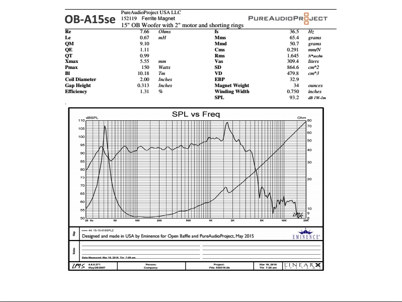

For compare an hi power pro-audio freq grafic to a 1W/2.83V hi-fi audio chart see these images below, this first below is the Alpha15A hi Wattage chart suited to pro audio custumers:

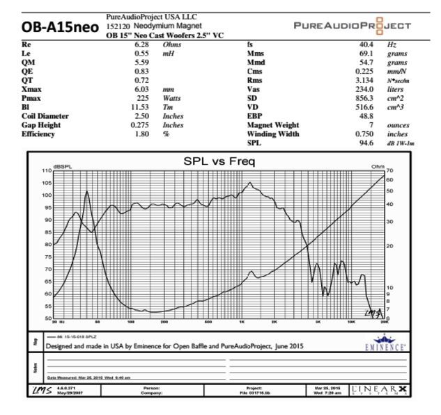

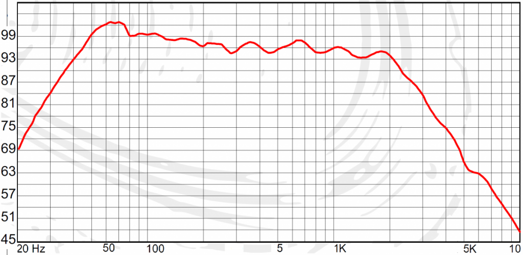

This second image is the PAP 15 Ferrite (an Alpha15A clone)
and the next 3º image below is the PAP15Neo that they say use the Alpha 15A cone + Neo magnet in a 1W 2.83V response, it show a very different look from the linear hi power chart.

In addition to making sure you are comparing the drivers at the same VOLTAGE level (2.83V RMS), you must also compare them with the same coordinates. The vertical range on your 1st graph is only 40dB while the second and third graphs it is 60dB range. This is a type of “vertical smoothing.” It also appears that there is more horizontal smoothing in the 1st graph.

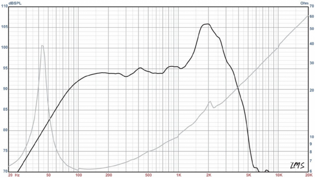

You mean the Kappalite? Alpha looks very different.
