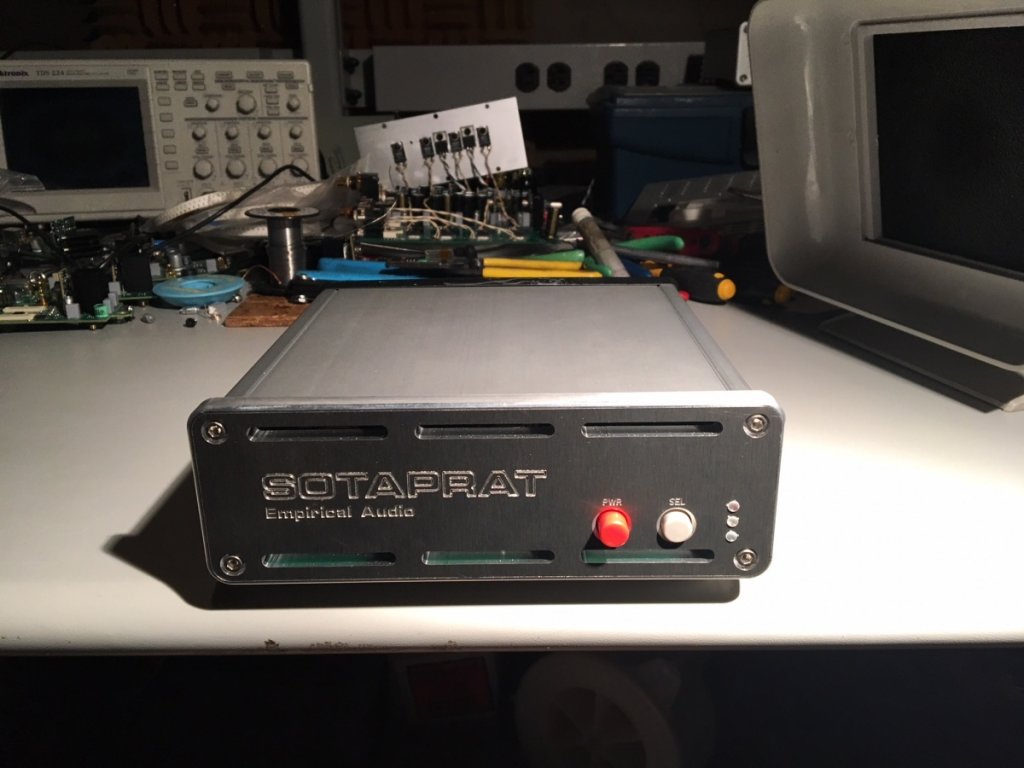

audioengr
Re: SOTAPRAT DAC updates
« Reply #31 on: 13 Nov 2019, 02:20 am »
New version:
Steve N.
path73
  • Posts: 34
« Reply #32 on: 19 Nov 2019, 09:19 pm »
Why not include the word "DAC" on the front plate?
At least the function of the unit would be explicitly stated.
"SOTAPRAT", could be just about anything (source, amp, reclocker, DAB receiver, ...) and I'm not sure PRAT is the only area where Steve's products shine.
I always tend to stay away from qualifiers like "SOTA" or "New" or "Latest", since these are time related and are a bit self-evident. No one is going to bring out a new product which is not trying to be state of the art art.
Why not something more easy on the ears, e.g.
simply "DAC" or if SOTA is really required "SOTA DAC" or more spot on would be "statement DAC" or to stay in automobile racing spirit "pace DAC" or "pacer DAC" or "carve DAC"?
Just my 2 cts. By the way, I am really interested in this new product!
/path
audioengr
« Reply #33 on: 21 Nov 2019, 07:06 pm »
This product is SOTA is several areas, but mostly the voltage regulators, which have only become available this year.  Without these, I would not have this product.  The D/A chip is newer than my Overdrive, but still fairly old.  Chosen because of the great SQ.  The Ethernet interface and XMOS interface are also very new in my product line and excellent performers.
I was actually reluctant to put too much on the front panel.  I have had complaints in the past about "Empirical Audio" on the front panel.  I mostly want it to look a bit sculpted.
Steve N.
