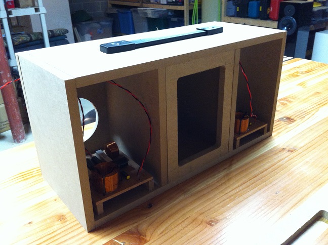

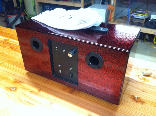

A while back I designed a pair of OS into a bluetooth boombox and I'm thrilled with their sound.    I drive them with Dayton's KAB-250 amplifier and a handful of lithium batteries.
And yes, the 'bronze/aluminum' cones on the HiVi drivers clash horribly with the absurd red metal flake finish I put on them.  :duh:
As Tyson pointed out, the low sensitivity makes them sub-optimal for portable applications, but I can still run it for an hour or two at offensive volume, or all day at more normal levels.      Everyone who has heard it is amazed at the sound quality, I guess expecting more typical portable speaker performance.
I also built a pair of Paul's MTM version as a gift for my in-laws.   They sound very similar to me, but with the two mids it takes a bit less power to get some ruckus out of them.
