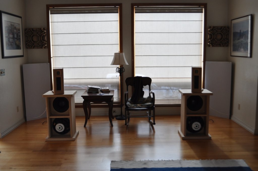

Other subs will work in a pinch but they won't blend properly. That's what I did for six months while I saved up for the subs when I got my first OB monitor kit. You'll want the OB servo subs.
that's what I am afraid of.  :lol: :lol:
I spent a fair amount of time and energy designing and building the cabinets. so I want to enjoy them longer before moving on. maybe a 6 months+ after if I get the S7 monitor / super mini.
  • Posts: 11646
Re: Super Mini's up and playing over here.
« Reply #161 on: 15 Jan 2020, 05:24 am »
Yes. I currently have a pair of JBL 15" woofer in large cabinets that I initially plan to pair them with. but if they end up too slow, then I will have to get the OB servo subs.
Ah gotcha.  I rather like the JBL woofers, a friend of mine uses a 12" pair in a sealed box with a ribbon tweeter in a waveguide from Beyma - really excellent sound.
I'd say try it!  It if works out, then great.  If not, then the OB subs will definitely work.

Yes, flat packs will be available for the  4 x M165's.  Danny  has a pack  , he's just been busy and hasn't  had time to   set it up.
Servo 8's are not in  stock  right  now, I think  Danny  is working on a  new order / run of them.

What is the intended/anticipated frequency range for the 4 - M165's in this cabinet ?
TIA
« Reply #163 on: 15 Jan 2020, 07:22 pm »
Hi Jay,
Very cool cabinet design.
TIA
200hz and down  to the  70-40ish range depending on room. Very similar to the  NX-Otica   4 lower  M165/M165X's  but in a slimmer  cabinet to better match  Super Mini/Wedgie cabinets
