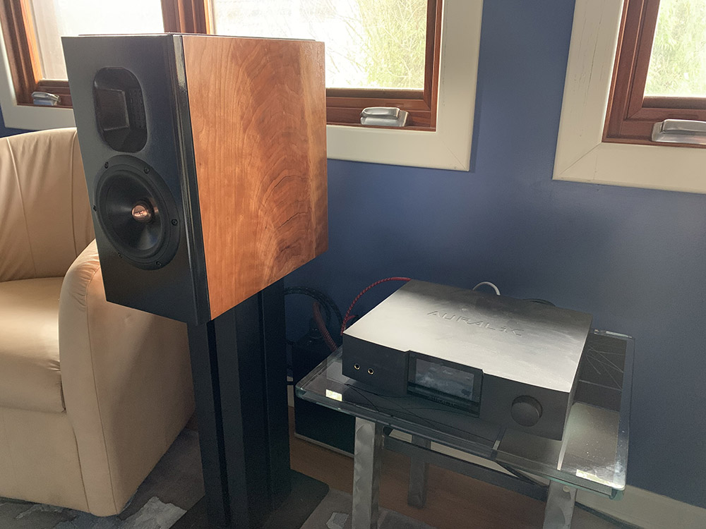

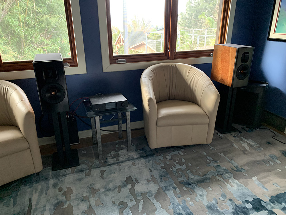

I've been meaning to post some photos of my new NX-Studios for a while now. Mike built the cabinets for me, and I assembled the crossovers and installed the drivers. These were for my bedroom system.
This system is pretty simple, using an Auralic Vega G2 as the source (Roon Endpoint) feeding a DIY Purifi amp https://www.audiocircle.com/index.php?topic=171798.msg1869116#msg1869116.
Mike did a beautiful job building the cabinets (much better than I'd be able to do), and they are sounding very nice in this system.

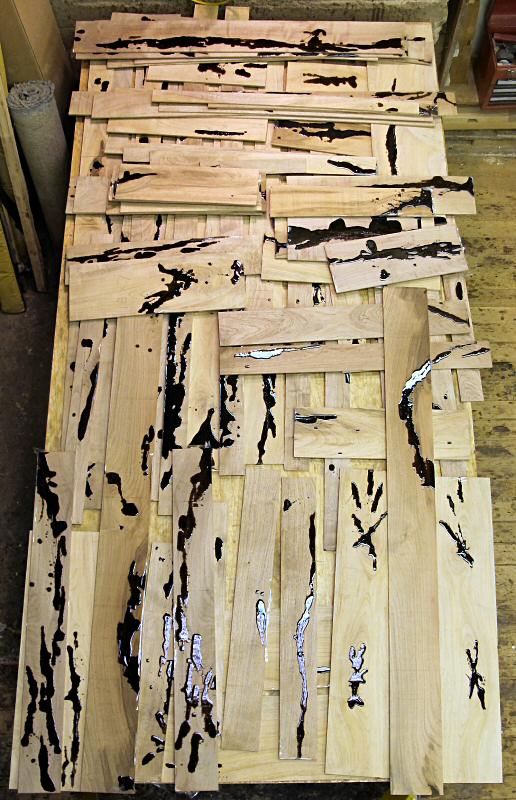

I recently ran across this site and am starting on my first build.  I see most all the builds are with MDF.  I was wondering if there is any sound difference with MDF and solid lumber.  Woodworking is my hobby, so I know there are issues with expansion and contraction with lumber.  But what about the affect of sound quality between the two?  This topic has probably been covered, but new user so can't search.  Thanks.
Hobbsmeerkat
  • Posts: 2741
Re: Mike Lundy for cabinets and completed speakers
« Reply #54 on: 6 Apr 2022, 01:53 pm »
Hardwood is more resonant than MDF or quality plywood. So best tip would be to use 1/4" hardwood over 1/2" MDF. It'll give you a nice solid cabinet without the resonance issues of bare hardwood.
WGH
« Reply #55 on: 10 Apr 2022, 04:46 pm »

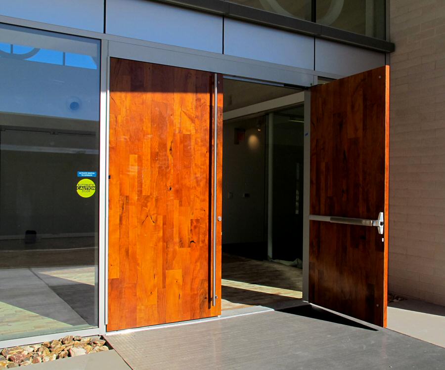

1/4" hardwood may work on small speakers but I wouldn't try it. 1/4" veneer acts like solid wood and expands and contracts with humidity changes. 1/2" MDF doesn't move the same way so there will always be opposing forces. I have seen strange thing happen to projects laminated with 1/4" wood.
1/8" wood acts like veneer, the substrate is strong enough to keep the veneer locked in place. I would also use either 3/4" or 1" MDF. I make my own 1/8" veneer and have laminated 100's of projects from exterior entry doors to furniture with zero failures. Two factors contribute to a successful lamination: glue and clamping.
I use Titebond Cold Press Veneer Glue for interior projects and West Epoxy for exterior. My mesquite veneered speakers use the Titebond veneer glue and the laminations are still perfect after 11 years.
The original Titebond will work too (it sets up too fast for large panels) but avoid Titebond II and III. The waterproof Titebond glues are more flexible which aid in keeping joints secure in wet conditions when wood swells but that flexibility also creates a raised glue line during periods of high humidity. Sanding down the raised glue line doesn't help, it will re-appear, the Titebond II and III glues creep too much for fine furniture use.
Even clamping is essential. I use a vacuum bag veneer press. The clamping pressure is even and veneers come out flat as a pool table top. Clamping using thick platens and cauls can work but I can always feel ripples in the finished veneer where the cauls were placed. For me that is totally unacceptable. The ripples would definitively be seen with a high gloss finish.

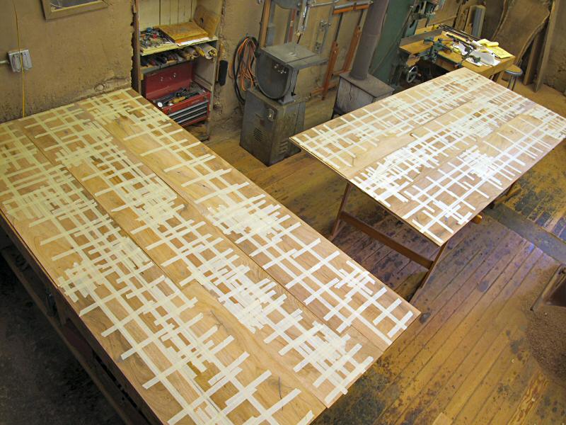

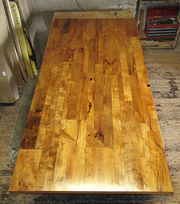

The doors for the Mesa Community College Art Gallery below was one of my more complicated veneer projects, each door is 4' x 8" with over 200 pieces of veneer. The architect wanted a random looking patchwork design but actually there in nothing random in the layout and the inside and outside are mirror images.
The mesquite veneer is first filled with black tinted West epoxy.
The sanded pieces are held together with masking tape ready to lay on the core
One of the finished doors ready for delivery, not a ripple can be seen or felt and no raised glue lines, this project used West epoxy as the glue.

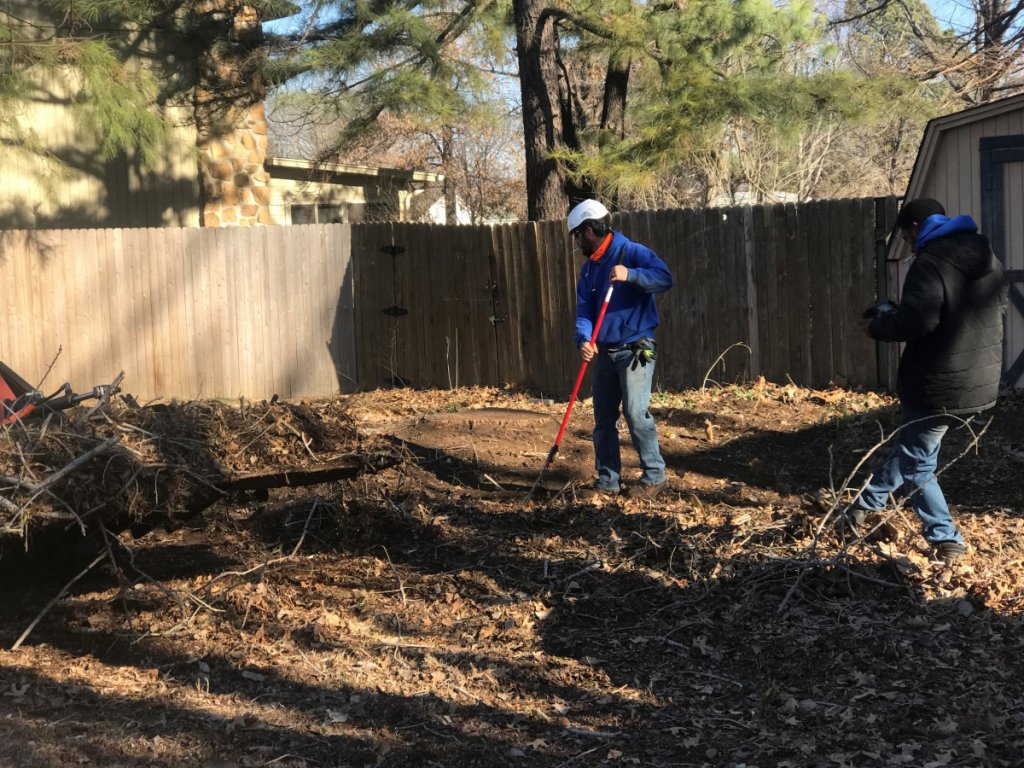

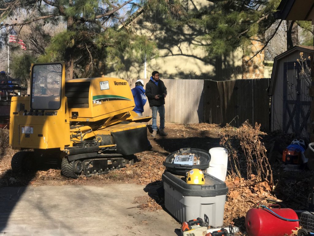

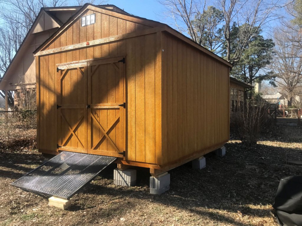

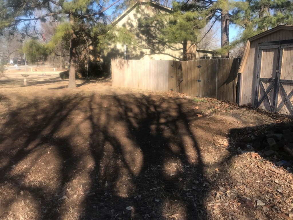

Phase 1: a large cottonwood, the existing garden shed, and a fence are where the new workshop is going to go. They all have to be removed and/or relocated. It begins with the removal of the large cottonwood seen on the left side of the picture

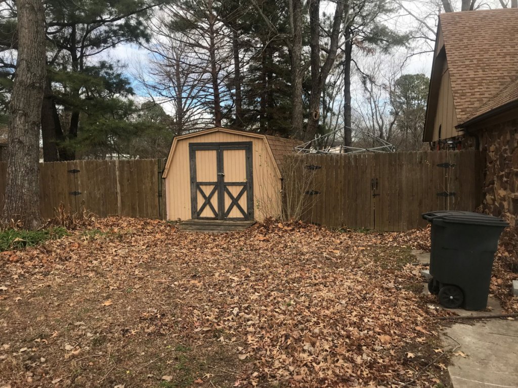

The old garden shed is really too small so a larger shed was purchased and put in the back yard. This required removal and re-installation of the fence as the building was too wide to go through the gate.
Due to the slope of the ground, the building had to be set higher than normal. This made the ramp too small to be effective. I have replaced it with three pairs of ramps designed for use with pickups. To make them work, I had to build a ledger on the shed, screw the ramps to the ledger then bolt the six individual pieces together into one piece. I'll get a pic of that this weekend.
The next steps are to move everything out of the old shed, put up a temporary fence to keep the dogs in the yard, remove the front fence, then move the old shed to a different location. Then I'll be ready to layout the foundation.
