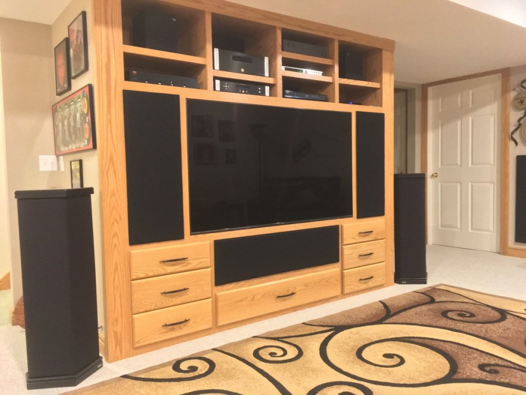

Hi All
I wanted to share some pics of my latest speaker build. I love to see what others are doing but I never take pics of anything that I am doing. So this time I thought others may find these useful because I always get ideas and help from other people build pics. Its been about 10 years since my last speaker build. I have been rehabbing some classic speakers here and there but nothing from the ground up.
First some info about myself. I am what you call a bang for the buck stereo and home theater guy. My system is what most would call mid level and I am OK with that. So after doing some research and reading of others comments on here, I settled on the X-Statiks. They are done in pomelle makore veneer and curly maple acsents. This will be my first OB speaker experience.
Secondly I have not really been in my wood shop building anything, normally some type of furniture, in about two years. All I can say about the experience is.......man am I rusty.
You may see some of your ideas in this build. I got so much good info and ideas from so many of you.

Its funny you should ask that. I have been digging out past speaker builds so I can free up some money and some space. As I have pulled the old speakers out I have been giving them another listen. They all sound good too me. But when I connect the X-statiks back up I realized what I have been missing. So the short answer to your question is I love them. But like you I came from a box speaker, and the X-statik is a different sound, but I have come to really appreciate it.
I was looking at the pics you posted in another thread with you tektonics. The X-statiks do need room behind them and like you I have a similar problem with space. I only use the X-statics for Music two Channel because I have others in place for home theater. When I listen to music I move them out about two feet in each direction so they have space behind them to get the best sound.  But when I feel lazy I dont move them and they still sound good too me. Take a look at the pic I attached. The speakers in the pic are DCM 1A's that I replaced with the X-statiks.
Jmitchell3
Re: My X-Statik Build
« Reply #27 on: 30 Dec 2019, 01:19 am »
Alex thanks for your response. I’ve never heard open baffle at all but I’ve heard good things especially about Danny’s designs. I like the xstatik because the bass area is sealed/boxed and probably will blend better with my potted svs sub (zero room for tower OB subs with external amps :/ ).
yeah it looks like you weren’t joking about your room that looks to be only mildly more inconvenient for speaker placement than mine lol.
Glad to hear you are enjoying your speakers! Carry on and happy new year!
