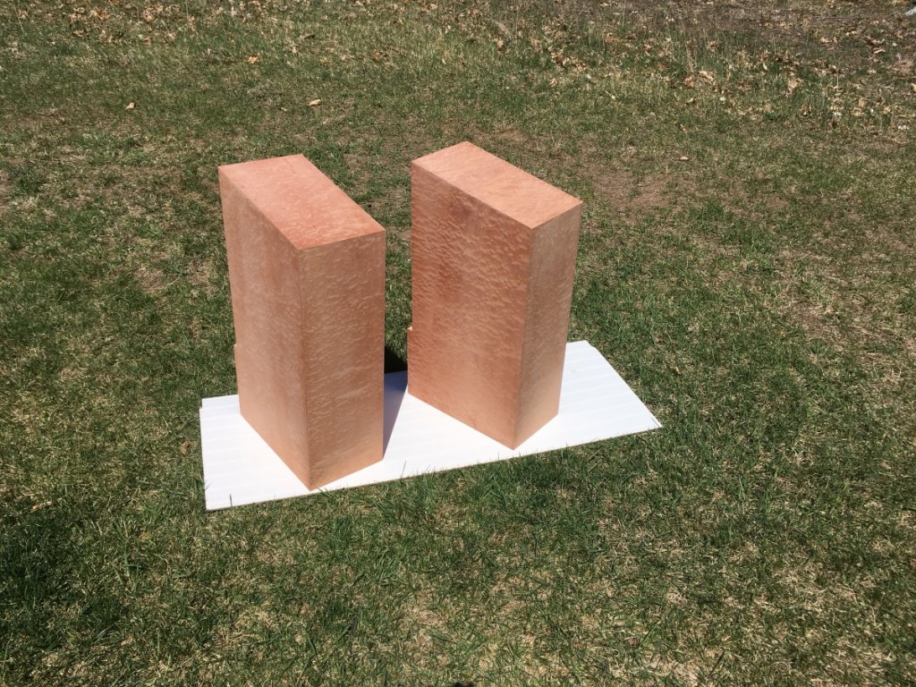

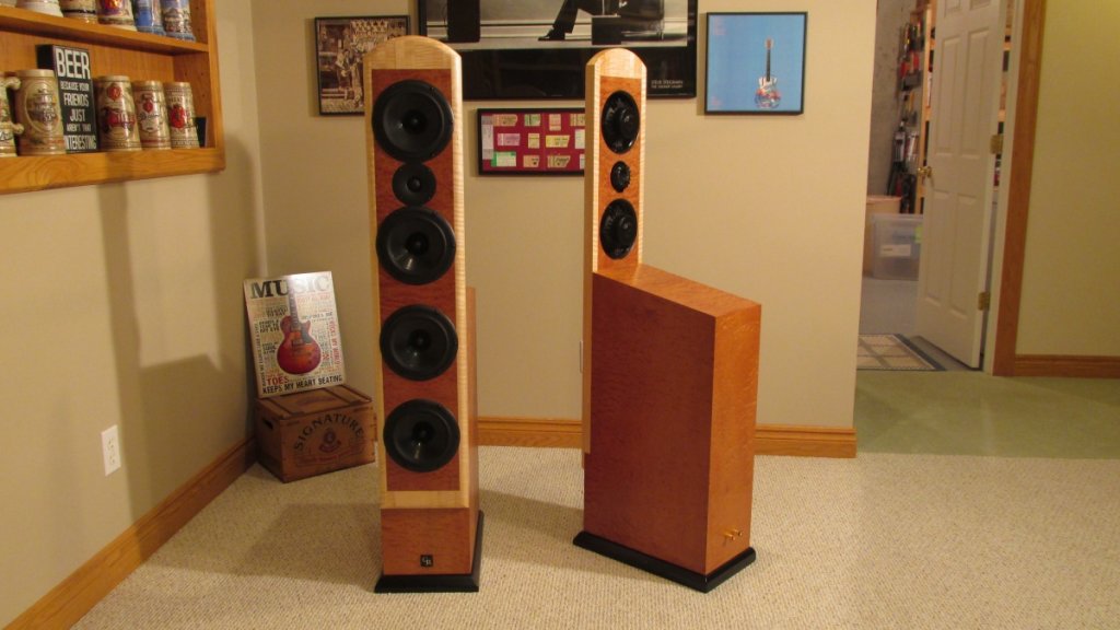

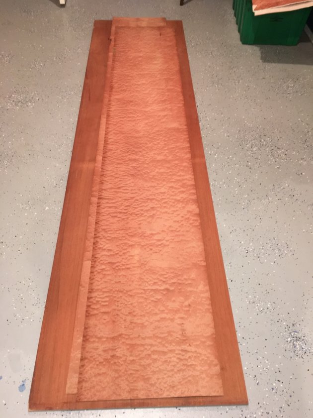

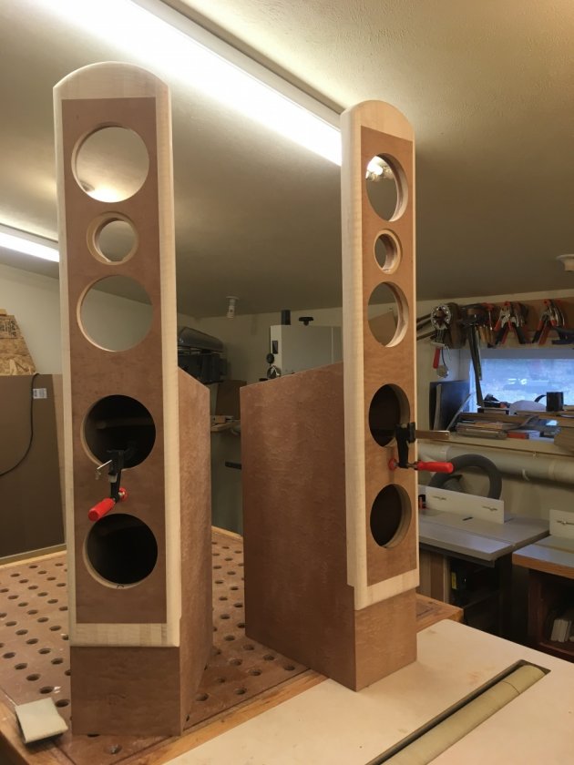

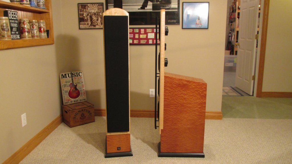

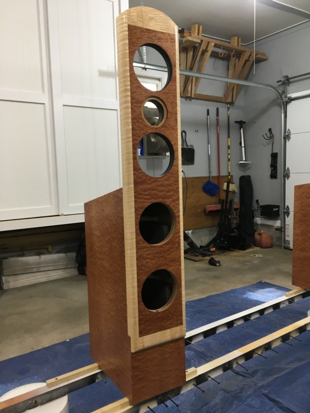

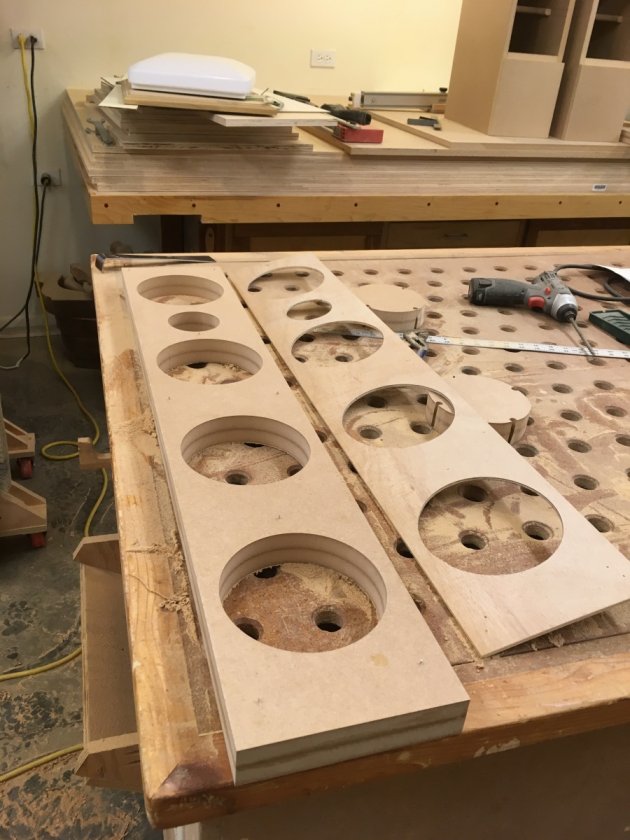

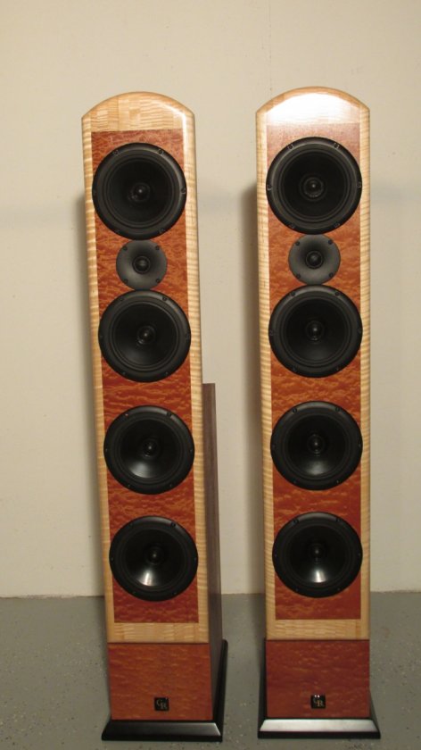

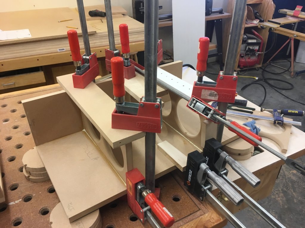

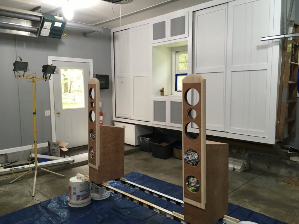

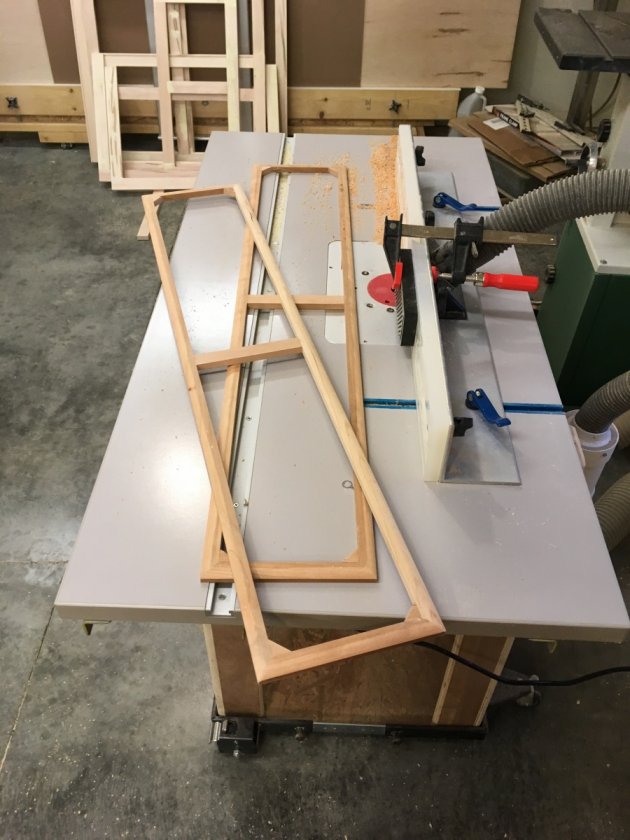

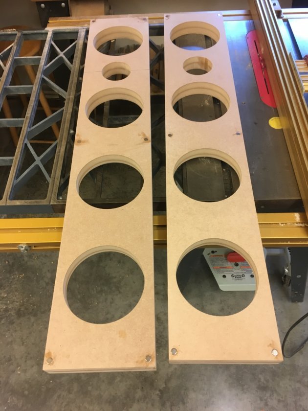

Hi All

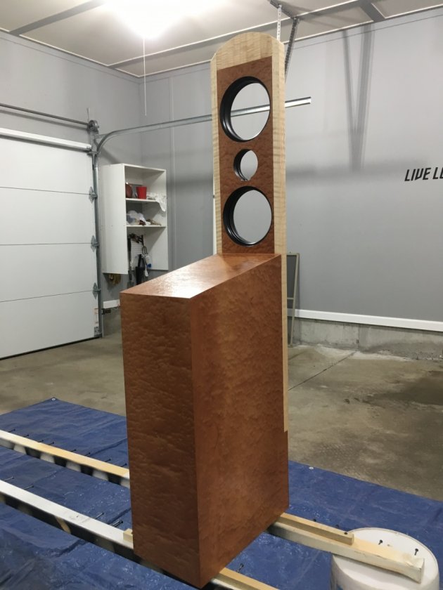

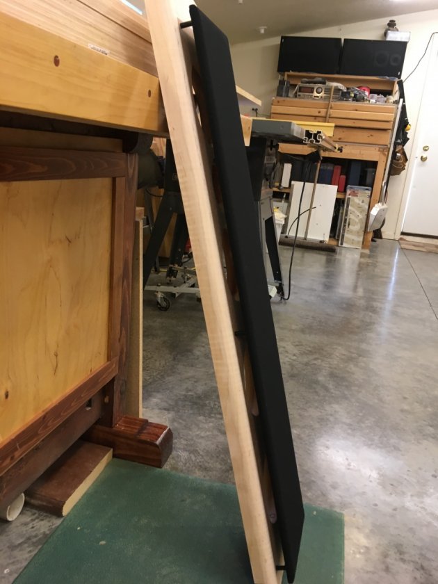

I wanted to share some pics of my latest speaker build. I love to see what others are doing but I never take pics of anything that I am doing. So this time I thought others may find these useful because I always get ideas and help from other people build pics. Its been about 10 years since my last speaker build. I have been rehabbing some classic speakers here and there but nothing from the ground up.

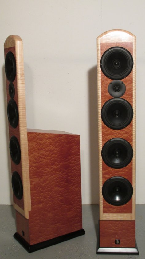

First some info about myself. I am what you call a bang for the buck stereo and home theater guy. My system is what most would call mid level and I am OK with that. So after doing some research and reading of others comments on here, I settled on the X-Statiks. They are done in pomelle makore veneer and curly maple acsents. This will be my first OB speaker experience.
Secondly I have not really been in my wood shop building anything, normally some type of furniture, in about two years. All I can say about the experience is.......man am I rusty.
You may see some of your ideas in this build. I got so much good info and ideas from so many of you.

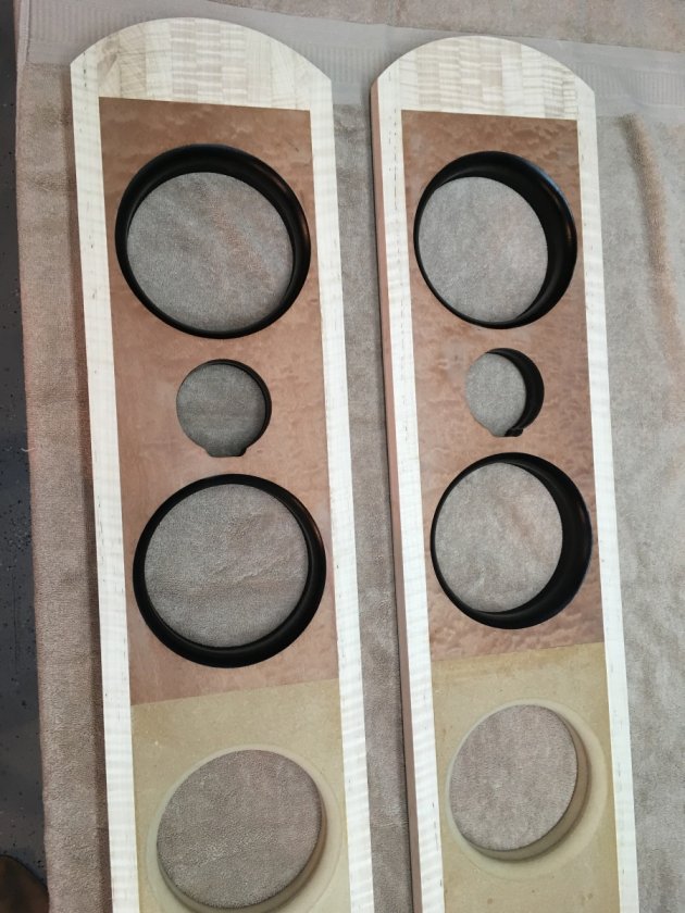

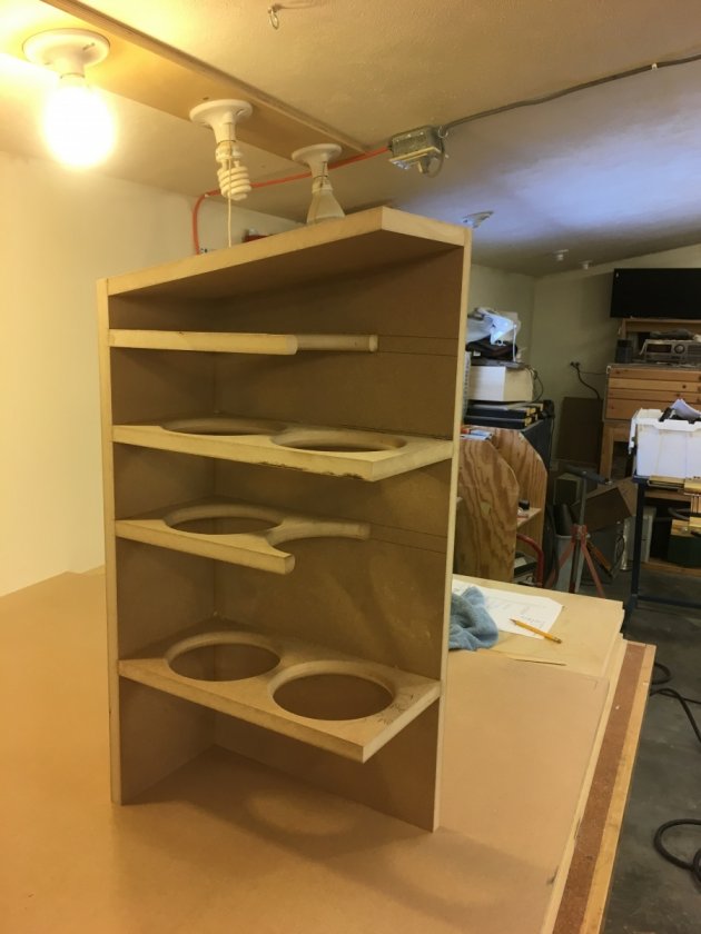

Those look fantastic! I hope you remembered the No Rez. Love the one piece cover too!

Thanks everyone. I appreciate the compliments. And yes I included the no-rez, but went with the standard crossover.

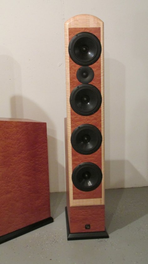

Beautiful build. You have skills. How do they sound?

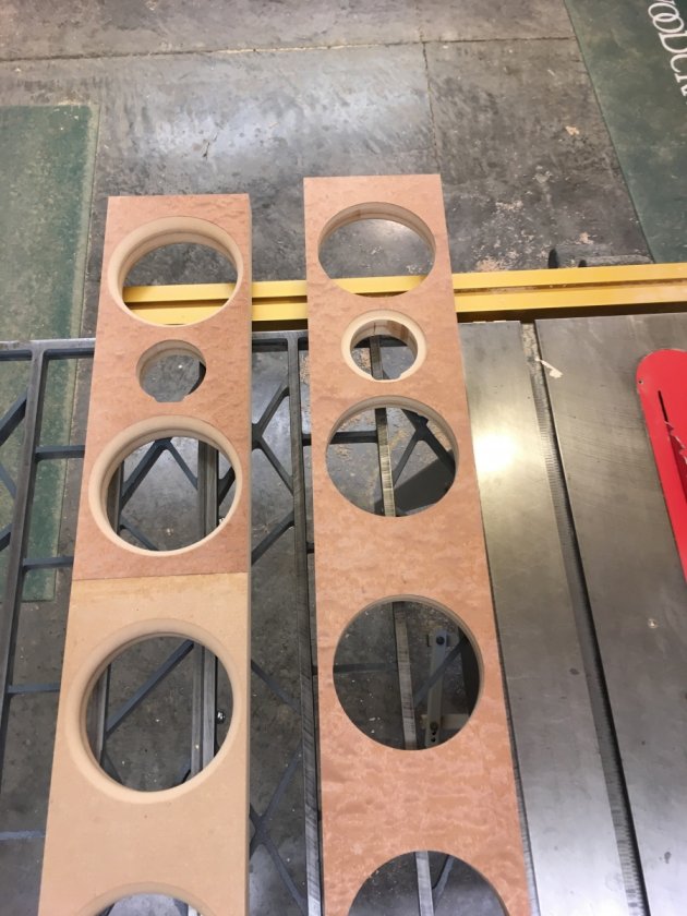

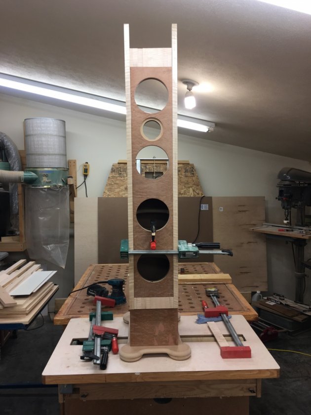

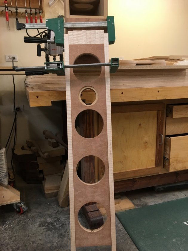

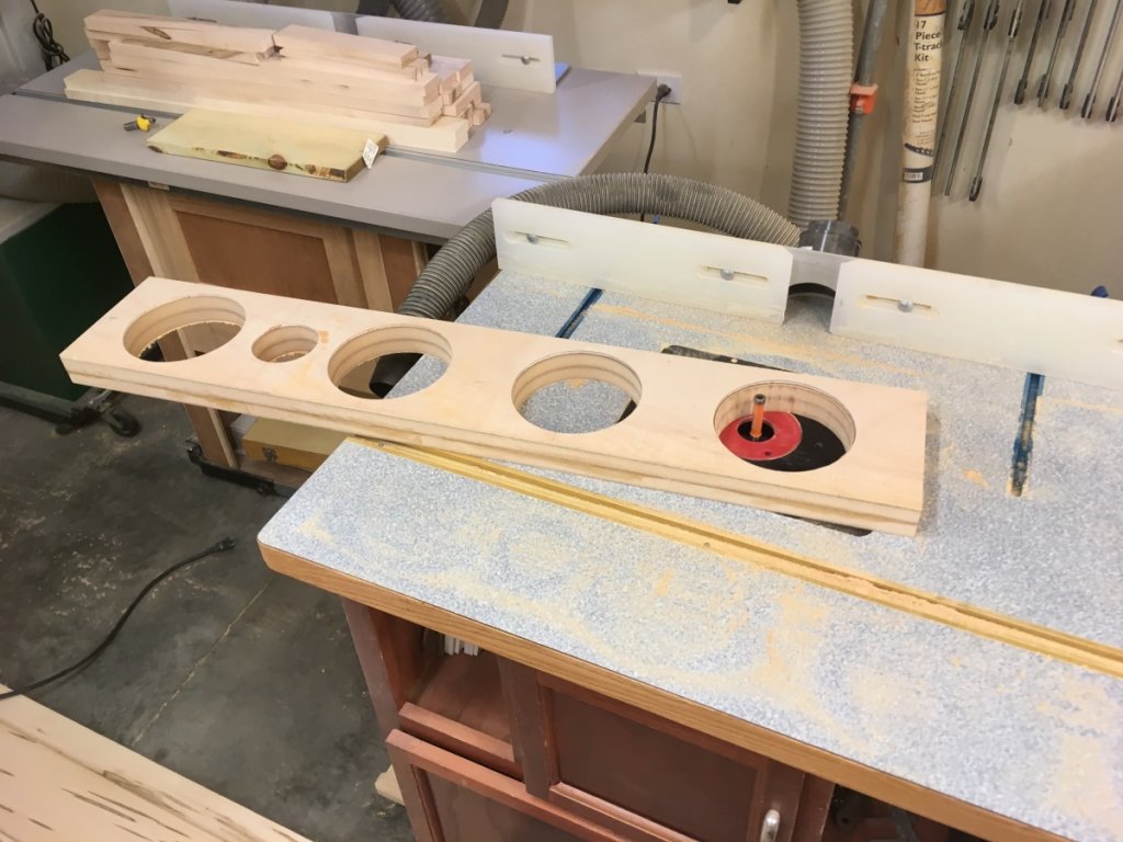

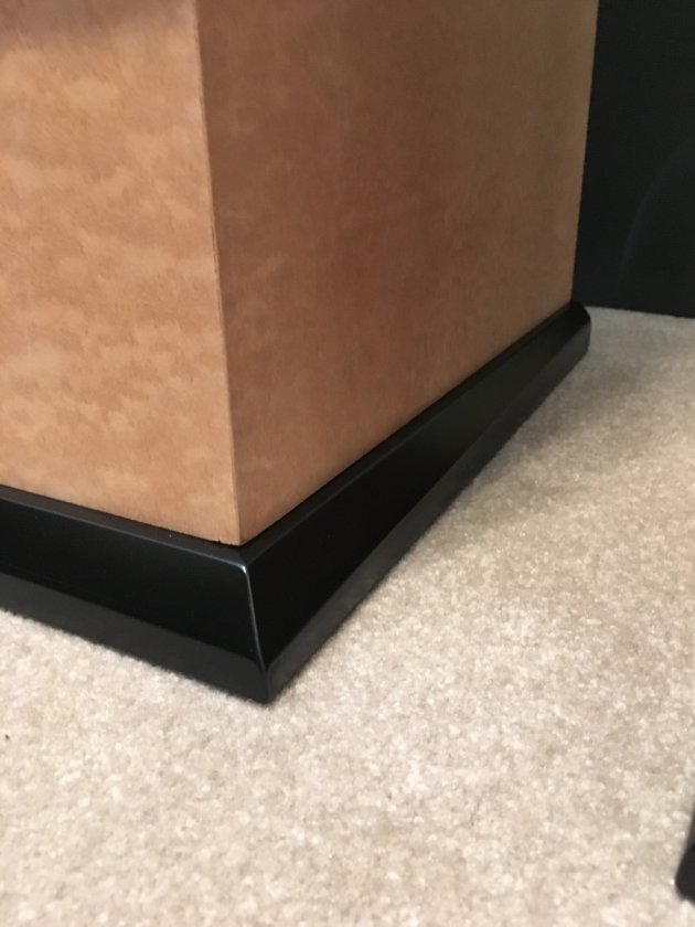

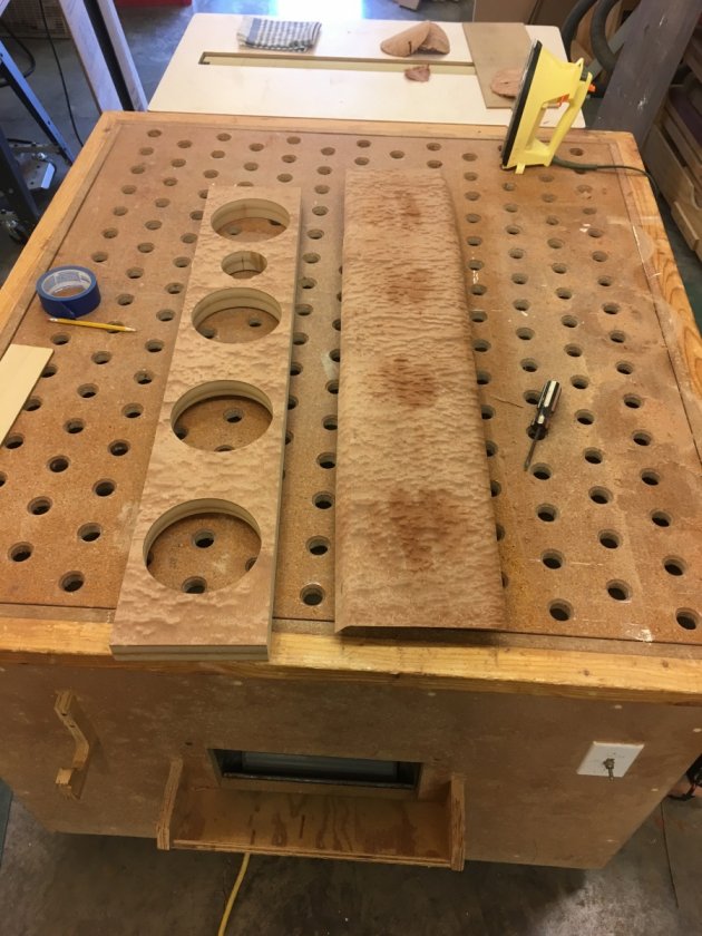

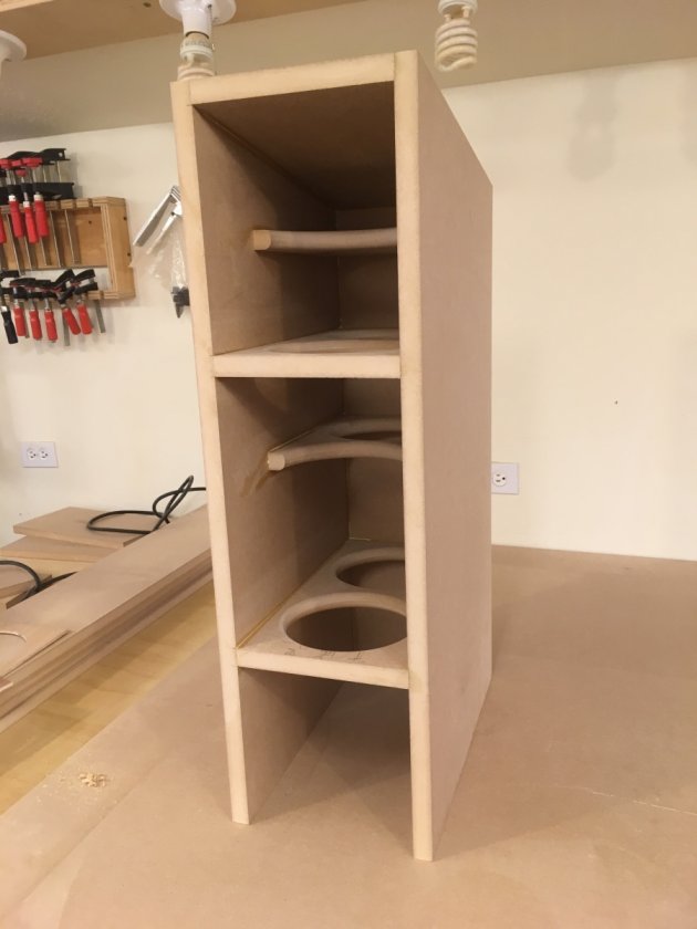

How did you cut the recess for the tweeter with the through hole already cut?

jeffh... They sound vvvery nice. They dont have much run time on them but I have already decided to get rid of my DCM Time Windows I rehabbed a couple years ago.
mlundy57... I made a template and used a pattern bit to cut the recess. Remember when I said I was rusty. After I cut the through hole I called myself a few names.

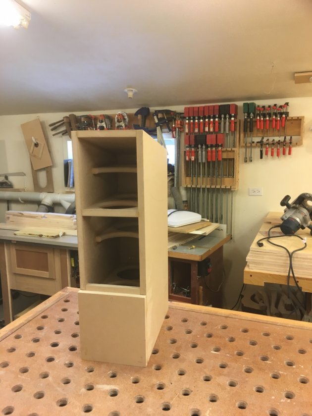

By the way I think it was you who had suggested to someone they try the Medex MDF. I really liked working with it much better than the standard stuff we have in this area. The bases are made from two layers of Medex sanded up with a coat of Z poxy for sealer and they painted up nicely.
Thanks again with all the complements.

And yes, after using the Medex, one won't go back, most of our flats are all made with it now aside from any 1.5" material. Still like the solid 1.5" MDF for some parts.

The 3/4 Medex in a 4 x 8 sheet was heavy enough. Can't imagine the weight of 1 1/2
