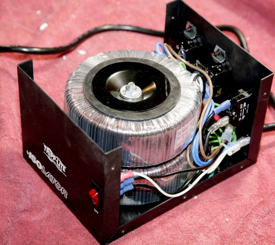

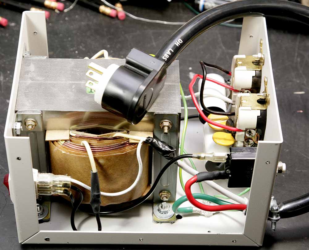

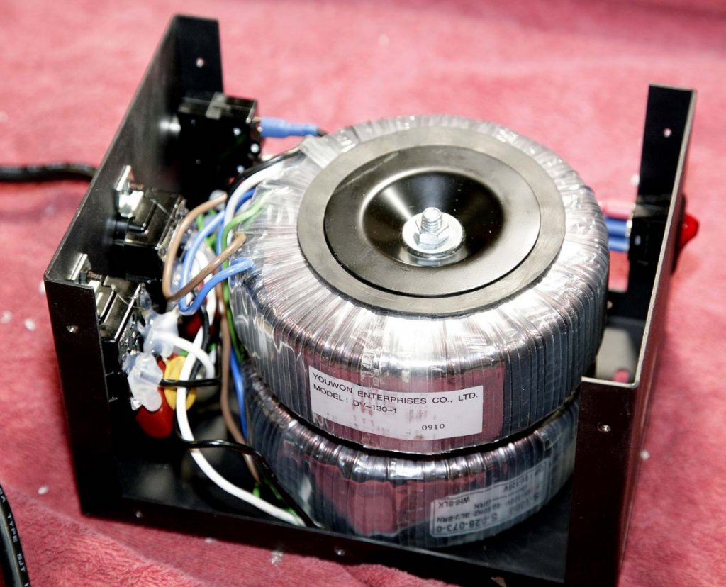

Years ago, before I bought hi-current p-cons, I owned 250-, 500-, and 1000-Watt versions, all purchased used.. The two smaller sizes had single rectangular-frame transformers (this is a 500 which I had improved)...
...while the 1000 had a pair of toroids stacked.. This latter model hummed (mechanicaly) an audible amount.. I tried to eliminate or reduce that but couldn't and gave it to my buddy, who told me he managed to quiet it (and he's still using it maybe-10 years later)..
They're made quite inexpensively, with thin bent-metal chassis, Chinese parts, etc. and are definitely NOT hi-end pieces.. I gave a 500 to another buddy who, after changing other equipment, didn't need it and gave it back.. Probably I'll find a place for it somewhere.
I'm sure they do an adequate job of reducing EMI on the line and damping Voltage spikes, but I certainly wouldn't buy another one.
