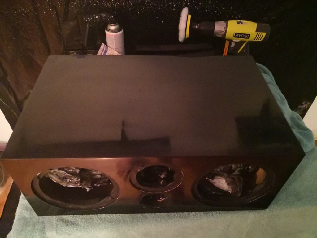

« Reply #26 on: 23 Sep 2019, 11:20 pm »
Last pics before the install. After the rubbing compound and glazing compound and buffing.
It's not perfect and what they say about the finish showing every imperfection is correct. But more than two feet away, it looks pretty darn good.
Now the last leg before I get to actually listen to it!!

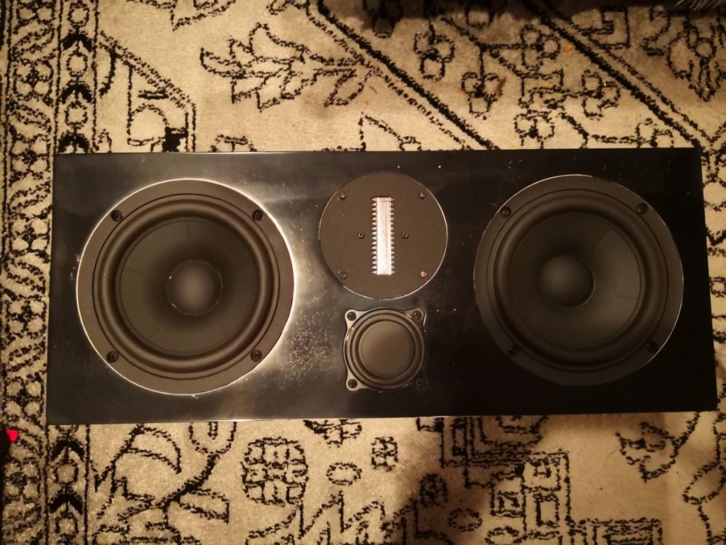

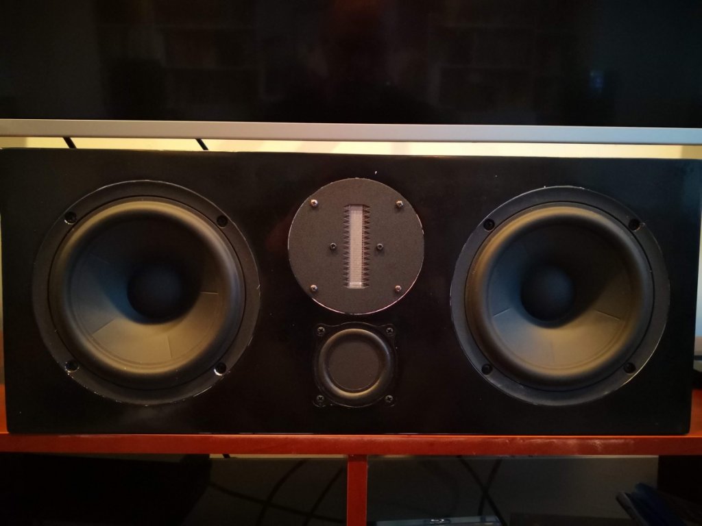

« Reply #29 on: 26 Sep 2019, 04:03 pm »
I did NOT take pictures installing the crossover boards and drivers. However here are a couple pics of the finished product. The first one, the flash highlights the blemishes in the finish - probably makes it look a little worse than it really is as that's not noticeable to the eye without light at an angle.  The second shows it on the shelf under my TV. It's still a closeup. Sitting on my couch about 9 feet away, it looks fantastic.
I've not listened MUCH as yet since I just got this finished last night and, in the process of setting it up in my system, I discovered one of my subs was not putting out any sound so I spent an hour troubleshooting all the typical things - cables, sub outs, etc., and not coming up with a solution. Appears to be some kind of amp fault.
Obviously I've not rerun Audyssey so I've got it turned off and just roughly level matched the center with my LRs using an SPL meter. As I got the levels dialed in the blending with the LRs started to become seamless. The center I was using is the Emotiva C2 and always struck me, with multi-channel music, is a bit of an edge in the highs. The BMR-CC eliminates that "edge" altogether. All I've had a chance to really listen to is a track or two off of Nils Lofgren's "Acoustic Live". I'm looking forward to listening to a lot more, especially my multi-channel recordings and videos. I'll post more impressions over time as they occur to me. As of now, chalk me up as a very satisfied customer!!

Great - thanks for the pictures and update!
