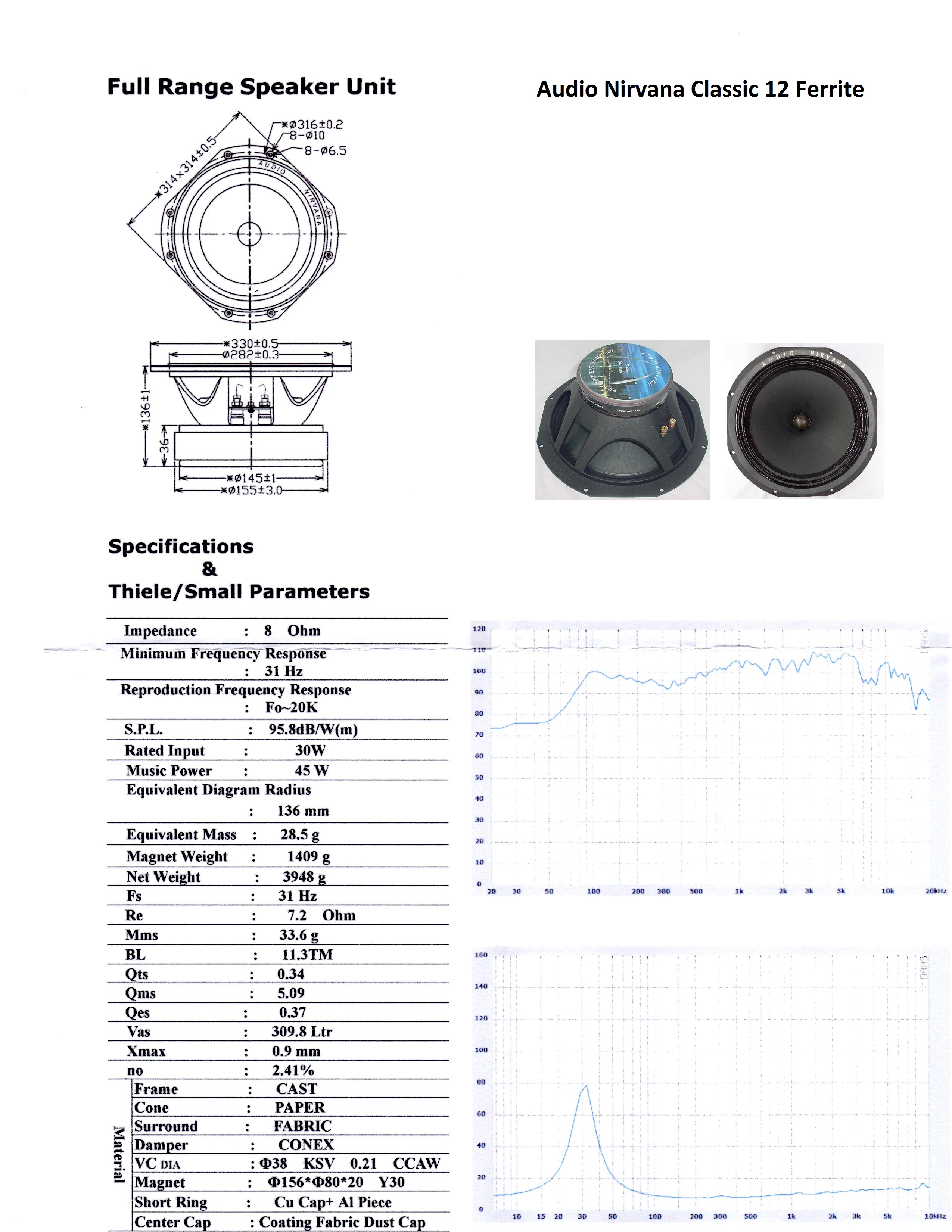

« Reply #6 on: 14 May 2019, 06:03 pm »
Worth to mention the Classic12Ferrite bass has a huge drop at 100Hz.
So avoid these drivers, you will need a helper woofer.
https://www.commonsenseaudio.com/an12classicspecs.jpg
The cheaper Classic10Ferrite bass is much better:
https://www.commonsenseaudio.com/an10classicspecs.jpg
If interested PM me I have a big 180L BR project for this one, CommonSense have his own free projects though.
