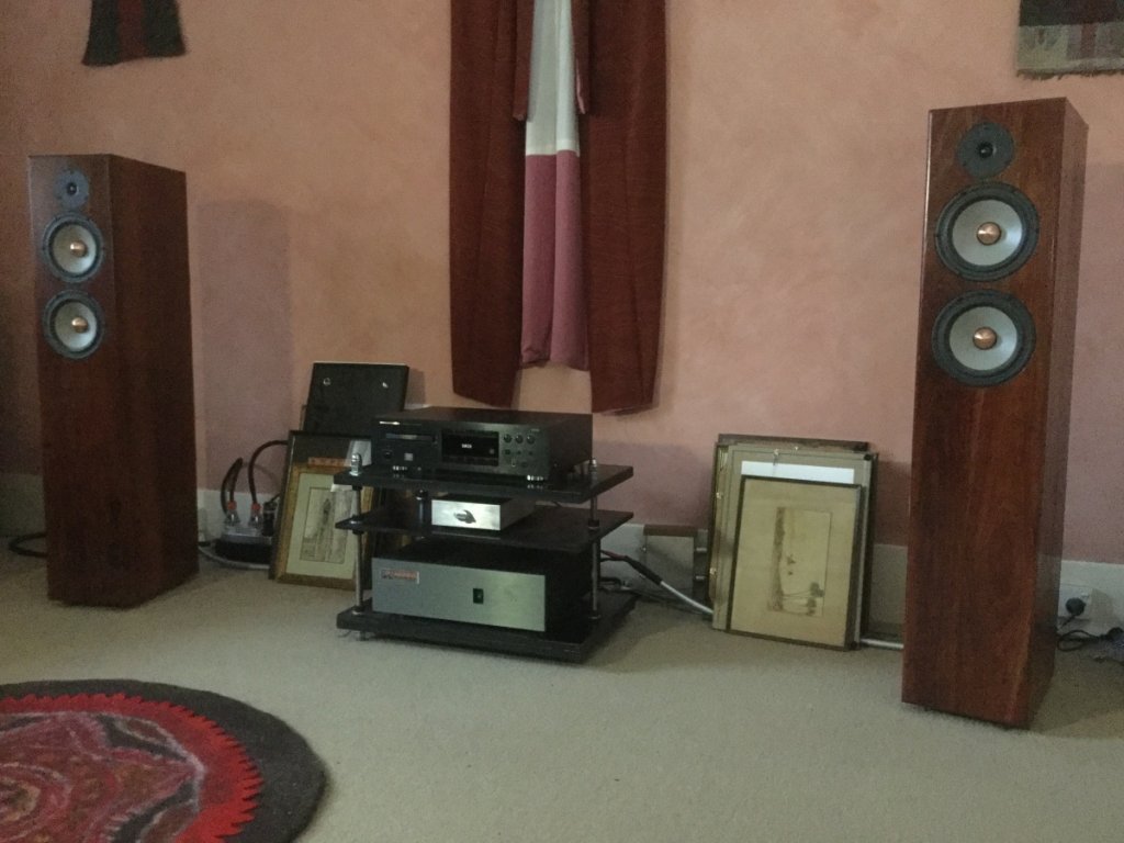

Okay, here is a pic of my new setup. Pic is taken from my listening seat. As you can easily tell, I'm sitting in front of the right speaker. Pity that I don't have a more wide angle view, but I don't. You can also see that I don't have much toe in, certainly nowhere near as much as I originally did with the Osborn speakers, though over time I did take some of the toe in out.
With regards the diagonal setup............here is something you can try.
Recreate the first step in my set up procedure. Move the right speaker over to the wall, right up against it. If your left speaker is decoupled from the wall behind it, then all sound will be heard as from that speaker only. Anything else means the left speaker is still coupled to the wall and would need to be moved out from the wall.
Because I have never done diagonal walls I really don't know how this would work. This is why I suggested contacting Bob Robbins.

Thanks for the pic. It was helpful for me to understand what you're getting at. Actually though, your speaker positioning isn't much different than mine. The difference is I sit dead center on my speakers. After looking at your pic I went and gave a quick listen to my system with a seat outside the speakers (both sides) as you do. I have to say I was surprised to hear a dead center vocal with the Ballad Of A Runaway Horse track while sitting that far from center. The vocal was centered unless I was positioned pretty much directly in front of one of the speakers.

The trick is to set the first speaker totally decoupled from the walls. Then you can set the second speaker in a perfect phase position to the first speaker. In that small zone of perfection the image stays very stable.
BTW, you can only tell just so much from a picture.

What I can tell from your pic is those speakers are probably too close to the back wall to be fully decoupled from it. Maybe it's an optical illusion and they're further than they look, but I don't think so. Anyway, if it sounds good to you, I say enjoy.

It is an optical illusion. For the record, the speaker baffles are just over 2 feet out from the wall.
It also looks as if I am really close to the speakers, but I am not quite so close.
Decoupling is done by sound only, whether by the first step in the procedure, or by doing like in the Wilson video. The decoupled zone in small rooms is generally about 2 feet out to about 3 feet out from the wall. I have my speakers close to the minimum as the room is so small. I would like to have them maybe a little more out into the room, but that creates other issues and makes it harder to get right. It works and works well where they are at now.

I've seen a few Master Set rooms and they all seem to have the speakers much closer to the wall than I'm used to.  And yes, they are about what you described, front baffle 2-3' out.  IME speakers need to be much further out from the front wall, does the "in phase" principal override the need for more space behind the speaker?

No, it's not an optical illusion. I would've estimated about 2 feet from the wall. As Letitroll98 says though, they're closer to the wall than one would expect, especially for speakers as large as those.

Here is a little tidbit from long ago, right after I first heard Master Set at RMAF2007, and only had minimal information and great desire. I understood that you start with both speakers against the wall. play this Ballad of a Runaway Horse song and then move the left speaker out into the room until all sound comes from that one speaker. I didn't have the song, but I did have a jazz tune that had a one minute double bass introduction which I put on repeat. I moved the left speaker out from the wall and got several inches out before anything changed. Then the bass slowly moved toward the left speaker. Then like real suddenly one move and all sound came from the left speaker with both playing, just like Rod said. I kept moving the left speaker out and about a foot later into the room, the sound quickly centered once again. Thus, when you get the first speaker too far out into the room you go out of the decoupled zone that you need to be in in order to get the speakers set correctly. Just remember those tape marks in the Dave Wilson video for the Zone of Neutrality.
My little above note is why you do not go with what you think "should be", you go with what you hear.
The sound all comes from the speaker baffle. The space behind the speaker box doesn't really matter much, especially with a closed box speaker like I have. With a rear port you would want at least a foot of space behind.
My speakers are not really "That" large.  Actual dimensions are 9x13x44 inches. However the speaker part is 9x13x24. The lower 20 inches is a built in stand. These speakers are re-creations of a standmount speaker Rick Craig designed for me in 2003 when I lived in the US. With this re-creation speaker I debated buying new stands or building stands into the box. I chose the later option.
