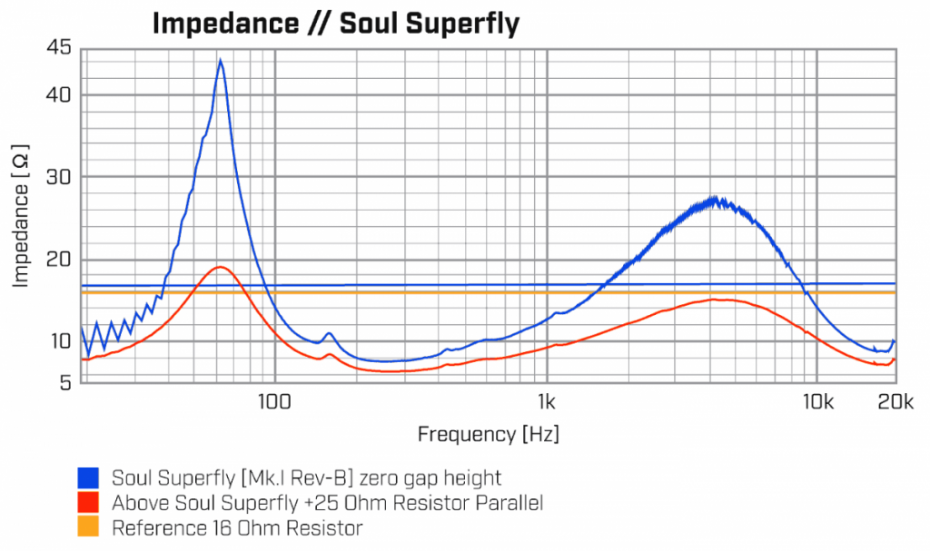

Yeah, I've just recently had an illuminating experience along these lines with my Zu Omen Dirty Weekends.  Zu started offering resistors for sale to place across the binding posts to bring more uniformity to the impedance curve.  This led me to look into the impedance curve for the first time, and found this:
https://www.zuaudio.com/diy/loading25r
So while Zu gives the characteristic impedance, I thought I'd calculate the high and low impedances by hand based on that Superfly graph, since the main driver in the DW's is pretty much the same as the Superfly, with different cabinet loading.  I ended up going with two 25 ohm resistors, which my my calculations brought the high impedance down from 45 ohms to around 9 ohms.  And the low impedance only dropped to around 4 ohms.  So, a 4-9 ohm range from a 7-44 ohm range.
But most crucially, it muted that gradually rising impedance from midbass to upper midrange by quite a lot.  And sure enough, the speakers don't sound nearly as uptight and constricted on my 845 SET amp, which would be the effect of a frequency response imbalance toward the upper midrange, but now have opened up and breathe nicely.  I used to need to use a solid state amp with these speakers to get a satisfying presentation.  No longer.

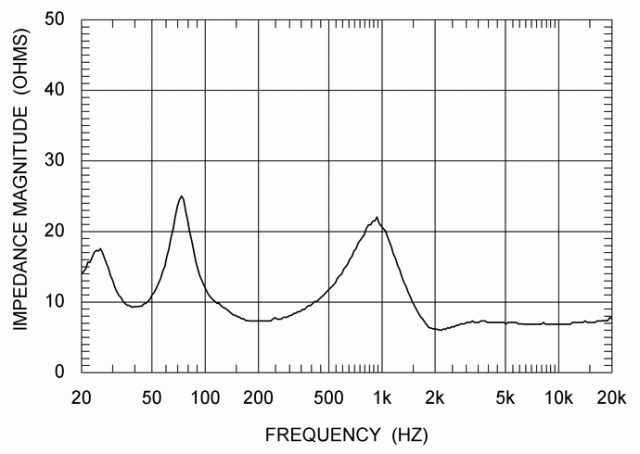

There are certainly some (speakers with crossovers) that get the impedance flat… which is the key for any speaker used with any amp that has a hihish output impedance (most SETs) which is way more important than (often over-) rated efficiency.
Yes, that is very true. The curve below isn’t as bad as it looks, and despite having a crossover and a bump around 900 Hz, these speakers with a SET did the mids and top end better than FR single driver I’ve heard.
