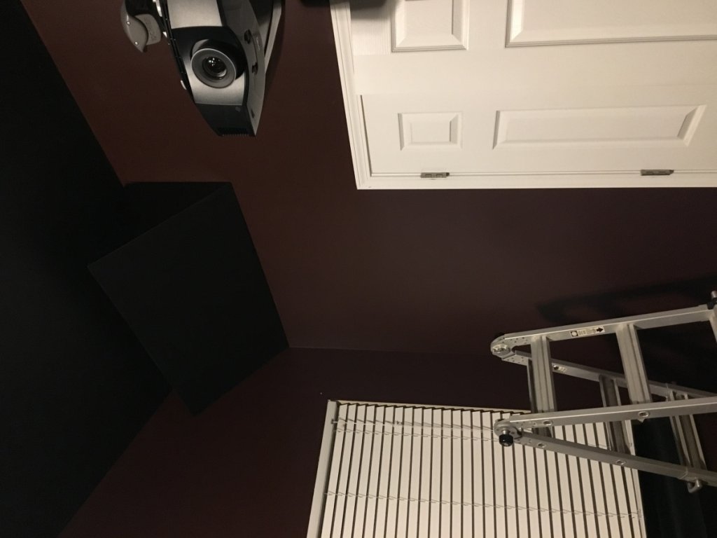

Forgot that the wall/ceiling angle was a bit wider than the trap. Had to improvise a bit, but came out pretty clean.
Thanks for the input all, and especially to Mike Peas, whose studio traps gave me the idea to begin with. I've had these tri traps for several years, and really wanted them to work in this room. Corner stacking wasn't going to be quite as clean as I wanted it.
ajzepp
Re: Mounting Tri-Corner Traps
« Reply #6 on: 28 Apr 2019, 06:56 am »
Sorry, I have no idea why like every fifth photo I post comes out on its side...
