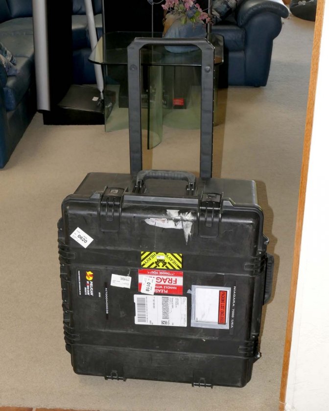

I finally received this morning, after Expona, the evaluation-program Niagara 7000 Low-Z Noise-Dissipation System, hereafter the 7000 or just p-con.. I was rather surprised to see the packaging:

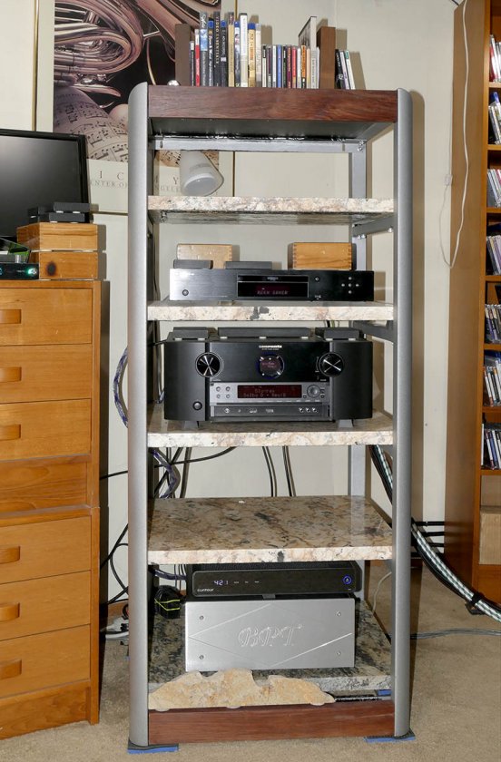

I've never been willing to try to compare P-cons because my older equipment stand didn't have an empty shelf.. I configured the rebuilt one...
...to be more flexible.. The 7000 will go onto the 2nd-bottom shelf, and switching cables will be relatively easy; it even has a 20-amp power inlet, same as my BPT 3.5 Ultra.

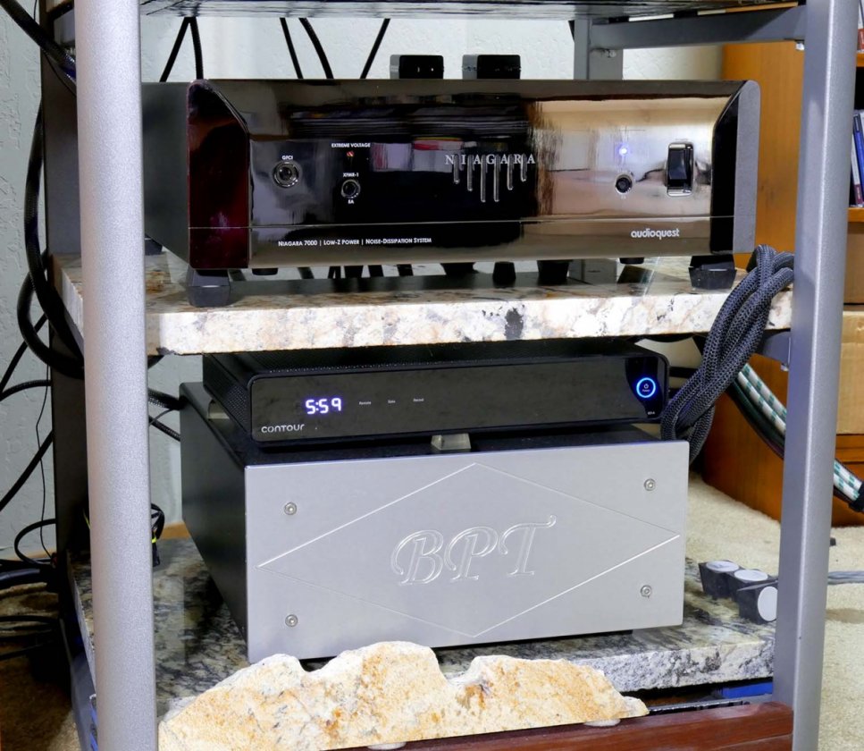

Here 'tis resting on double-high Herbies Tenderfoots.
It's in and running.  The package included an AQ Tornado HC 2M powercord; $1200 RR!!!!  I don't know if that's included in the retail package (v. the Evaluation package I received).

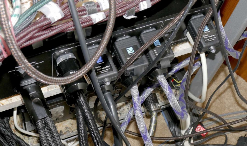

In the pic below, the AQ p-cord on the left is the Tornado inlet cord; it's plugged into the very same duplex output (a Furutech GTX-D [R]) the BPT is; the AQ p-cord grabs VERY tightly on the AQ 20-amp IEC inlet.  The LH p-cords drive the Atma-Sphere M-60 poweramps; the next duplex outlet is driving the 11-channel Emotiva poweramps thru a DH Labs Power+ cable and also since I have room, a PS Audio Noise Harvester* (NH).  The next two single cables, silverish with a purple X around them, are current-generation Noetec 11g. NEP-3002 Mk.III...
http://www.soniccraft.com/product_info.php/neotech-nep-3002-mk-iii-p-4992
...driving the Marantz '8805 preamp and Oppo '203 DP...and two NHs.  The RH outlet is powering an outlet strip with the cablebox, flourescent equipment-rack light, and system flat-screen monitor; this trio of noise generators gets an NH plugged into the far end of the outlet strip AND one in the 7000's outlet.  The light and the monitor are not turned on while playing music or movies.
Each of the 7000's outlets has one X-rated cap of at-least-three different sizes wired across it.  There are two large toroidal transformers of some-7-1/2" diameter inside, below a heavy cover that perhaps provides some magnetic shielding.
(I have NOT yet dressed the digital-signal cables away from the powercords.)   :oops:
* Again, my use of many Noise Harvesters is to reduce contamination by noise generated by equipment plugged into the same duplex outlet as equipment drawing power.  For instance, both the highly digital preamp and DP generate EMI on each's p-cords.  When each individual outlet of a duplex is not filtered capacitively and inductively and hence isolated from the other, each piece of equipment 'corrupts' the power seen by the other.  My BPT has capacitive filtering on each dupex outlet, but all six of its duplexes are wired in parallel, so there's little isolation between/among its outlets.  The audience aR-12 I had years ago...
https://www.audiocircle.com/index.php?topic=106120.0
...uses both types of filtering/isolation between EACH outlet.
