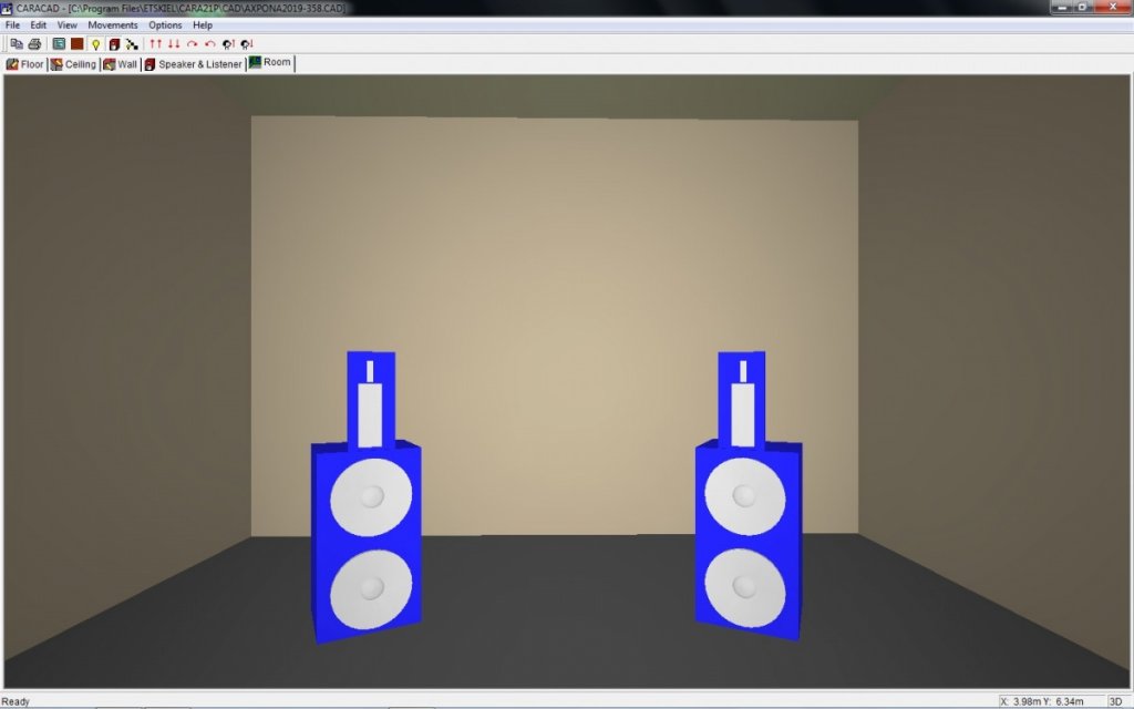

I use CARA 2.2 Plus PC software for room and speaker modeling.  I just get the room dimensions, as I have done The Monoliths speaker model in CARA.
If someone buys a kit, and they have or get CARA then I would be happy to give them the speaker model to use for setup.

HAL
Re: AXPONA and The Monoliths speaker system
« Reply #9 on: 3 May 2019, 12:27 am »
Ed,
Here is an example of the simple version of The Monoliths in the room in the CARA software after you build the speaker model.
You run the optimization and it gives you suggested locations for the speakers to fit within the parameters you setup.
