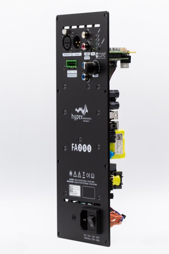

Clayton....presumably then, passive mid/treble means that the customer's amplifier drives the mid/treble while the ncore handles the bottom end?
Also, where would the ncore be located, mounted to the speaker, on the ground behind the speaker or along side you customer's amp and then running to sets of speaker wires to each speaker?
Also, can you shed some light on what 2d baffle means?
thanks!

In the link Clayton provided in the first post above, the last bullet says
Plug and Play Installation - Single Speaker Wire Hookup
I think this indicates the N Core amp is located either in or near the speaker, and you only run one set of speaker cables from your amp to each speaker.
thanks!
Yes - the N Core amp drives only the bass driver, so the range above 100Hz is passive analog, driven by your amp operating at 8 Ohms and 97dB sensitivity. The amp mounts to the machined aluminum base plate with a 2 inch thick spacer.
thanks!
2D baffle = 2" deep.

Just to be clear regarding the hook up of the X3 and X5 with self-powered bass:
There are one set of WBT speaker terminals on the input panel (spade or banana). Plug in your speaker leads as with a normal speaker. Plug in the included power cords for the Hypex amps to the your wall outlet. The Hypex amp gets its music signal from leads coming out the input panel which feed the high level input on the amp.
So, no interconnects are needed - just plug and go.
Clayton
