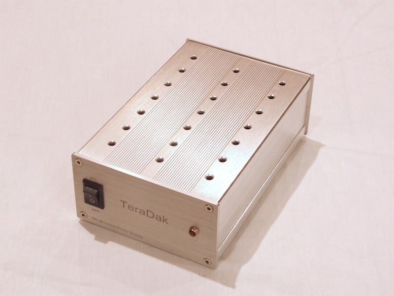

Physical Overview

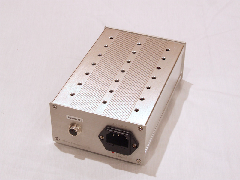

Figure 1. The DC-30 is encased in a high quality machined aluminum chassis. TeraDak recommends a break in period of one week. Clarity and detail improved after 24 hours. I did not hear further improvements due to additional playing time after that.
All those ventilation holes are not there for show. The DC-30 gets hot. Linear power supplies have lower efficiency than switch mode power supplies, therefore more of a LPS's energy is converted to heat. The top cover was 120 degrees Fahrenheit within a few minutes of being turned on. In comparison, the heat sinks of my Pass Labs X600.5 power amplifiers are in the range of 125 to 130 degrees Fahrenheit after an hour of playing at moderate levels (~85 dB-C). Temperature was measured with a Fluke model 561 infrared thermometer.
The DC-30 measures 4.25" wide by 6.5" long by 2.375" high and weighs 2.1 pounds.

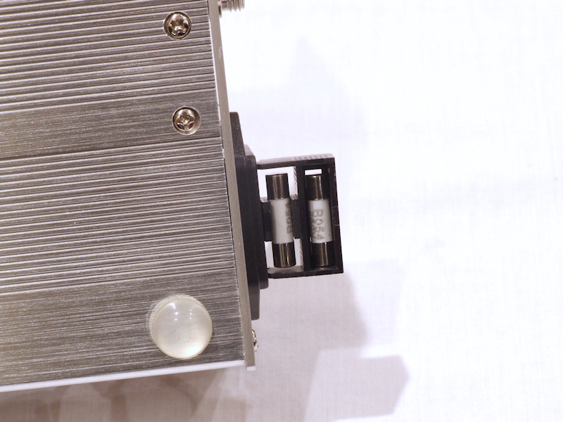

Figure 3. The fuse compartment below the IEC power cord inlet has a spare fuse (the fuse closest to the rear).

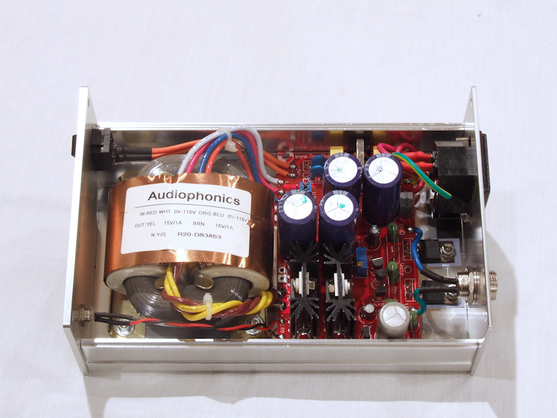

Figure 4. The interior of the DC-30 is dominated by the Audiophonics R-core transformer. The transformer might be a custom design as I did not find this model (R20-DS3853) on the Audiophonics website. The DC-30 is marketed as an upgrade power supply for the Musical Fidelity V90 DAC.
R-core transformers offer some of the sonic advantages of toroidal transformers at a much lower cost.

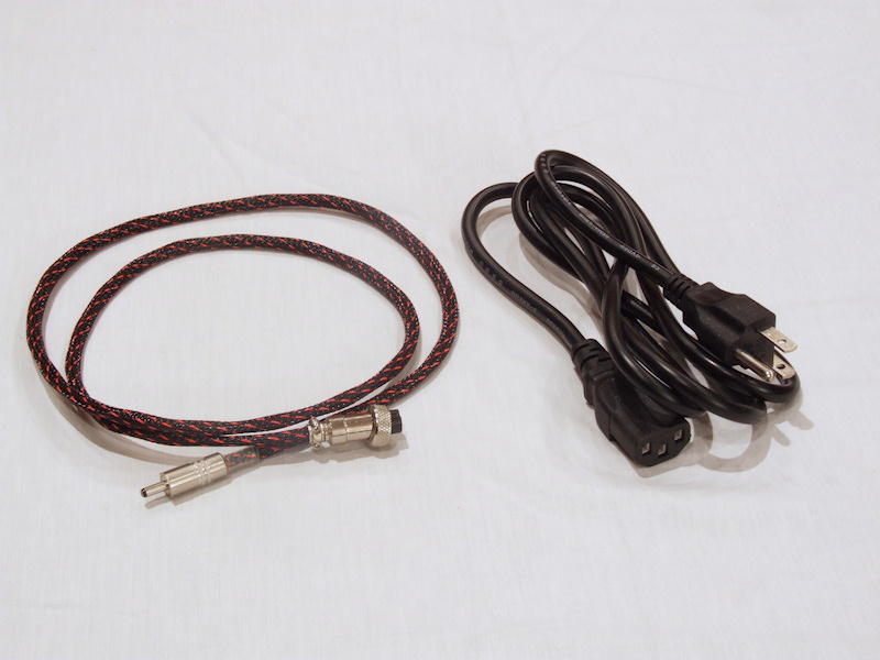

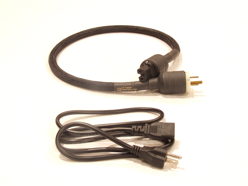

Figure 5. A 1 meter DC power cable and 1.5 meter 18 gauge IEC power cord are included.

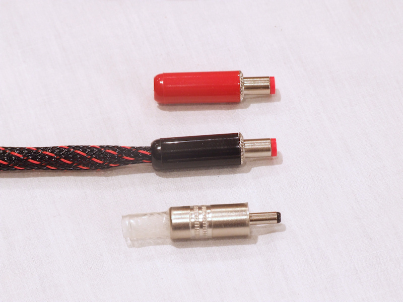

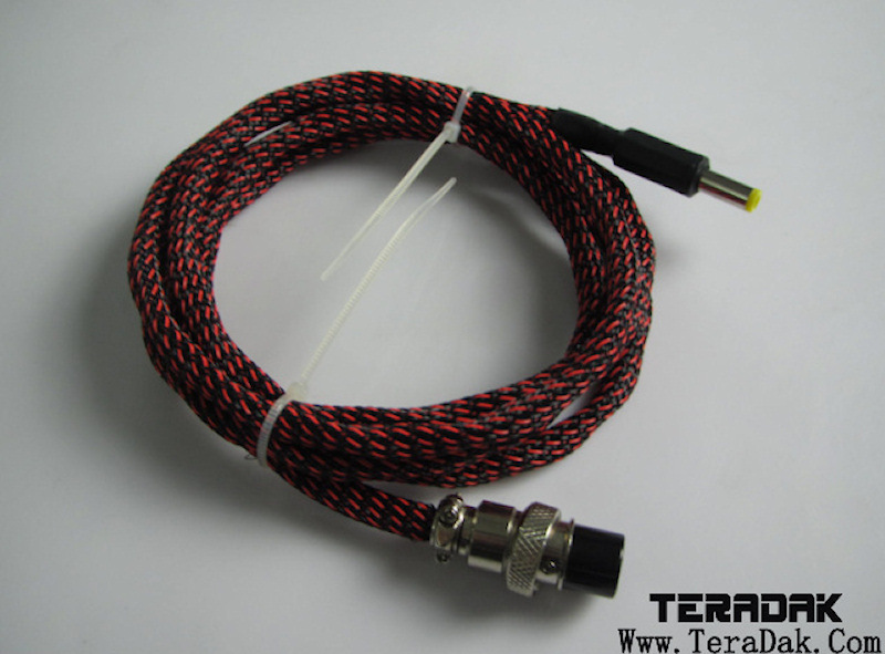

Figure 6. I didn't look closely enough at the picture of the DC-30's DC cable on the TeraDak website to notice it was a little bit too skinny. Standard size in the U.S. is an external barrel diameter of  5.5 mm and an interior diameter of 2.1 mm. The power plug of the cable I received was substantially smaller, as shown in figure 7.
Figure 7. The DC-30's DC power plug (bottom) was too small (3.46 mm barrel diameter) for the Rosewill enclosure's DC power port. I ordered two different color Switchcraft plugs #762 (black) and #763 (red) from Mouser. I couldn't decide which color I liked best prior to ordering.
TeraDak confirmed via email that a 5.5 mm x 2.1 mm plug is available, but it, like the input voltage, needs to be specified at the time of ordering.

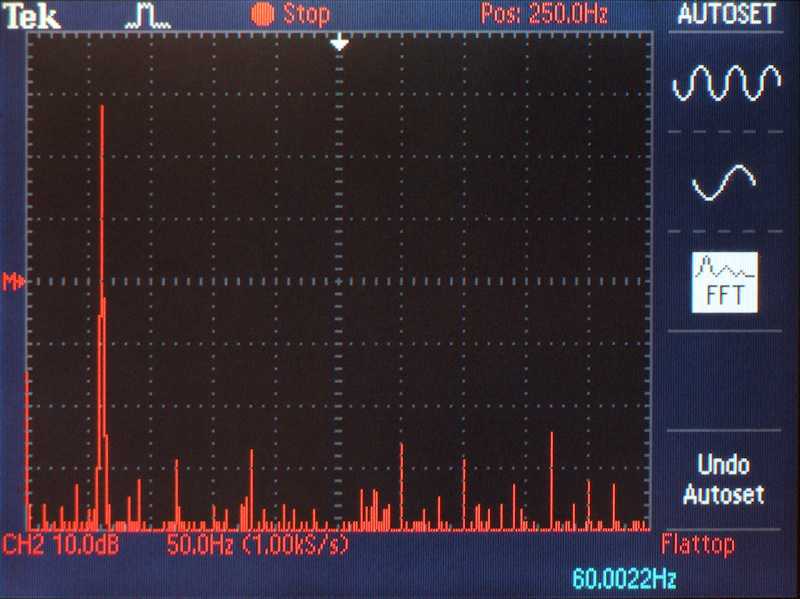

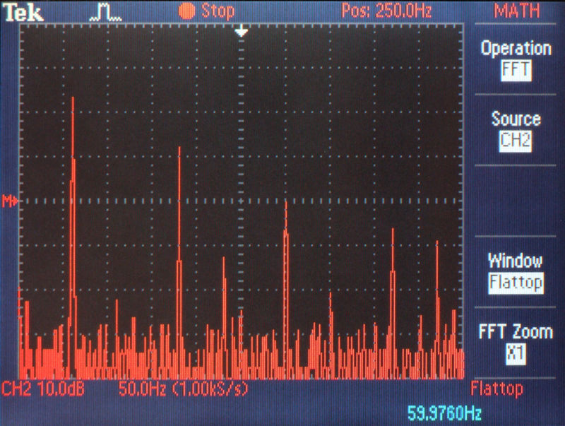

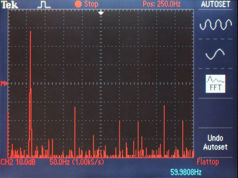

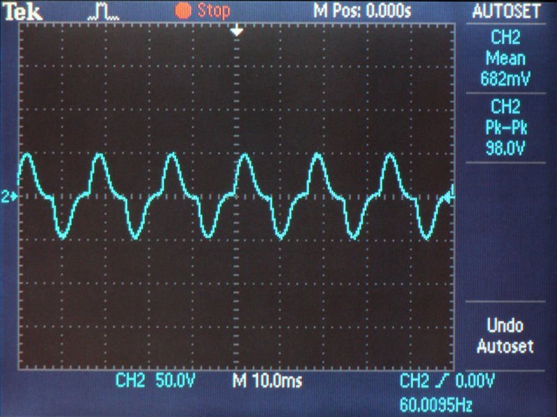

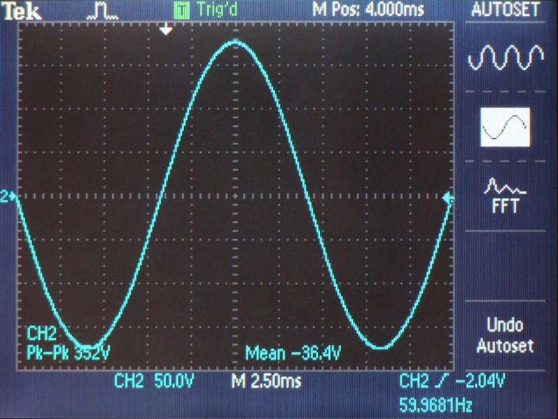

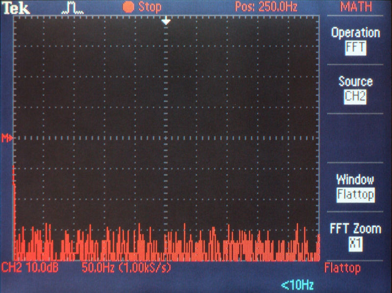

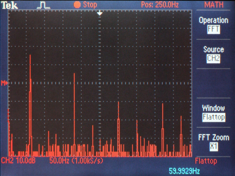

Measurements

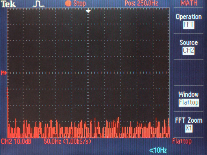

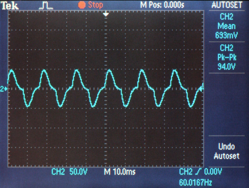

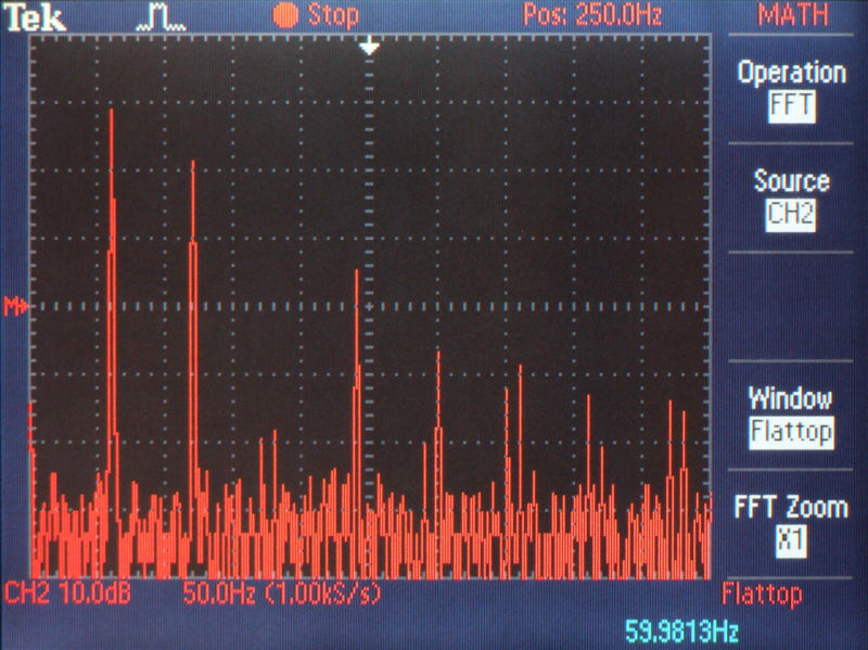

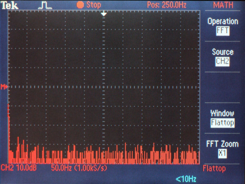

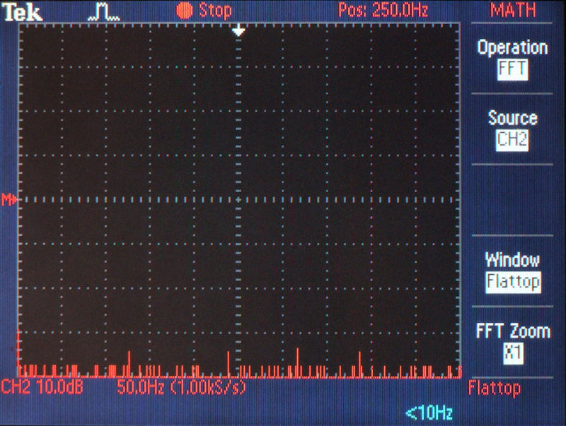

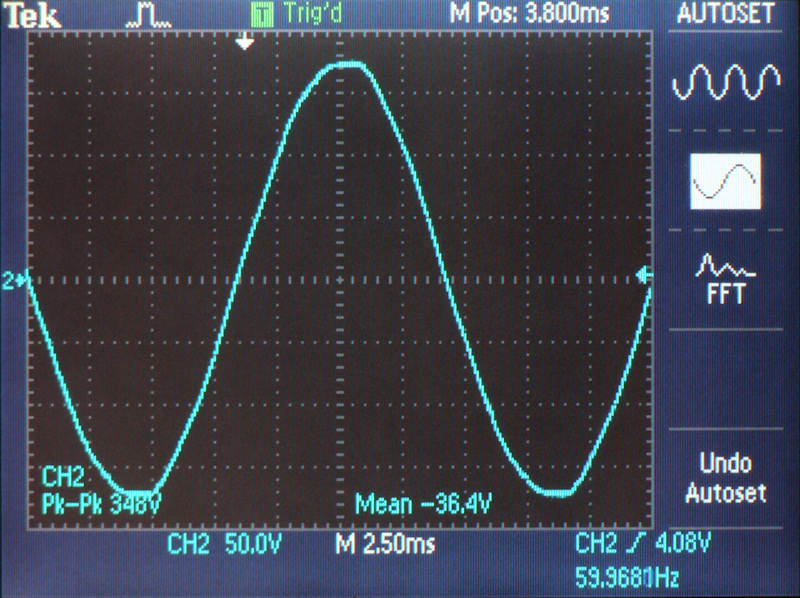

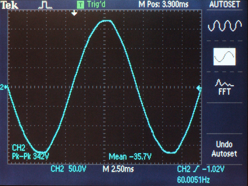

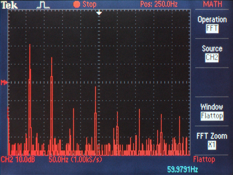

Time domain (sine wave) and frequency domain (Fast Fourier Transform) measurements were taken with a Tektronix TDS-2012 digital oscilloscope.
The TeraDak LPS was plugged into a PS Audio PowerBase noise gate/isolation platform, which was plugged into a PS Audio P10 AC regenerator, which was plugged into a dedicated 20 amp AC circuit terminated with an in-wall PS Audio Soloist SE passive power conditioner.

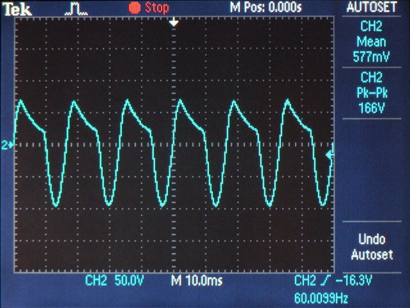

Figure 8. Sine wave plot of passively filtered open circuit AC voltage from the wall. The waveform shows flattened peaks due to harmonic distortion and other power line noise.
Figure 9. Sine wave plot of regenerated open circuit AC voltage measured at the output of the PS Audio PowerBase: A near perfect sine wave shape.

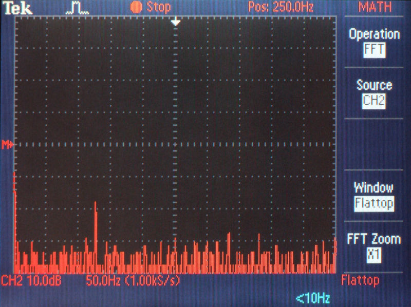

Figure 10. FFT plot of passively filtered open circuit AC voltage from the wall. The only signal of value is the large spike on the left, which represents the 60 Hz power signal. Everything else is harmonics, the power company's 470 Hz signaling tone, and noise.
Figure 11. FFT plot of regenerated open circuit AC voltage measured at the output of the PS Audio PowerBase: Drastic reduction in harmonics and noise.
Figure 12. FFT plot of open circuit AC voltage measured at the output of the Rosewill enclosure's stock Flypower switch mode power supply. This power supply generates even order harmonics, which were not present in the original voltage signals from neither the wall nor the AC regenerator.
Figure 13. FFT plot of open circuit AC voltage measured at the output of the iFi Audio iPower switch mode power supply. No even order harmonics were generated, but the odd order harmonics are significantly greater in amplitude in the voltage from both the wall and the AC regenerator.
Figure 14. FFT plot of open circuit AC voltage measured at the output of the TeraDak LPS. In stark contrast to the switch mode power supplies, no AC artifacts at all.

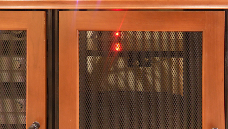

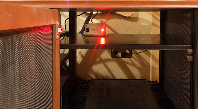

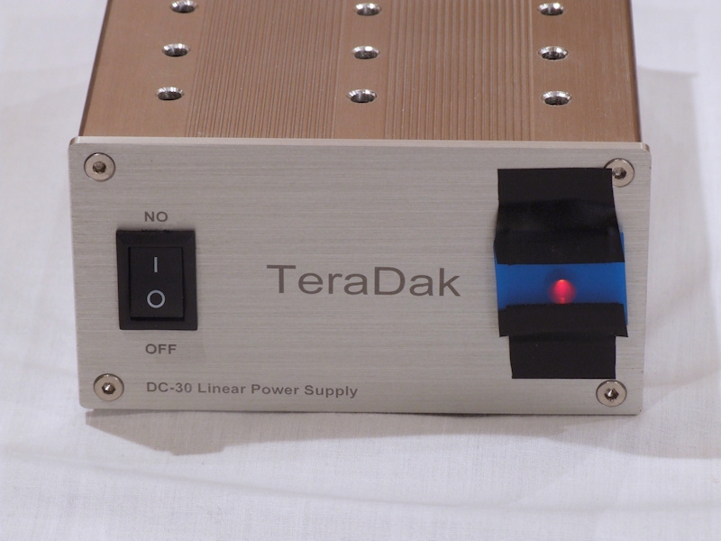

After preliminary listening evaluations were completed, attention was turned toward tweaking. The first thing to address was the DC-30's very bright LED.
Figure 15. Something needed to be done about that "red sun" LED.
Figure 16. Even with the audio equipment cabinet door closed, the red sun still shined brightly.
Figure 17. A double layer of blue film reduced the red sun to a warm, mellow red glow.

Figure 18. The stock 18 gauge power cord was replaced with a Signal Cable MagicPower 10 gauge power cord ($79) that was in my box of spare power cords.
Figure 19. After some audio grade fuse trials, the stock 5 mm x 20 mm Miro R054 1A, 250V slow blow fuse ($0.25), was replaced with one of the HiFi Tuning SilverStar 1A fuses ($40) I had on hand.

The following time domain (sine wave) and FFT plots are with the iFi Audio iPower power supply and TeraDak LPS plugged into a regular household receptacle and into the PS Audio AC regenerator power chain.
All measurements were taken within a few minutes of each other.
The regenerated AC power chain consists of the following:
Dedicated 20 Amp AC circuit==>PS Audio Soloist SE In-wall passive power conditioner==>PS Audio AC-12 noise filtering power cord==>PS Audio P10 AC regenerator==>PS Audio AC-12 noise filtering power cord==>PS Audio PowerBase isolation platform/noise gate.
Electrical Environment Graphs
Figure 20. Sine wave plot of open circuit AC voltage from regular household AC receptacle.
Figure 21. FFT plot of signal and noise spectrum of open circuit AC voltage from regular household AC receptacle.
Incoming power from the utility company has typical total harmonic distortion in the range of 1% to 1.5%, with the lower figure occurring in the early morning hours
(2am - 6am) and higher figure in the daytime and early evening hours. The total harmonic distortion figure of power from the AC regenerator is 0.1%.
Figure 22. Sine wave plot of regenerated open circuit AC voltage measured at the output of the PS Audio PowerBase.
Figure 23. FFT plot of regenerated open circuit AC voltage measured at the output of the PS Audio PowerBase.
Rosewill Enclosure Stock Flypower SMPS Graphs.
Figure 24. Time domain plot of open circuit AC voltage measured at the output of the stock Flypower SMPS plugged into the wall.
Figure 25. Time domain plot of open circuit AC voltage measured at the output of the stock Flypower SMPS plugged into the PS Audio PowerBase.
Figure 26. FFT plot of open circuit AC voltage measured at the output of the stock Flypower SMPS when plugged into the wall.
Figure 27. FFT plot of open circuit AC voltage measured at the output of the stock Flypower SMPS when plugged into the PS Audio PowerBase.
iFi Audio iPower SMPS Graphs
Figure 28. Time domain plot of open circuit AC voltage measured at the output of the iPower SMPS plugged into the wall.
Figure 29. Time domain plot of open circuit AC voltage measured at the output of the iPower SMPS plugged into the PS Audio PowerBase.
Figure 30. FFT plot of open circuit AC voltage measured at the output of the iPower SMPS when plugged into the wall.
Figure 31. FFT plot of open circuit AC voltage measured at the output of the iPower SMPS when plugged into the PS Audio PowerBase.
TeraDak LPS Graphs
These measurements were taken with the TeraDak's stock power cord and stock power line fuse.
Figure 32. FFT plot of open circuit AC voltage measured at the output of the TeraDak LPS when plugged into the wall.
Figure 33. FFT plot of open circuit AC voltage measured at the output of the TeraDak LPS when plugged into the PS Audio PowerBase.
The following measurements were taken after installing an upgrade power cord and upgrade power line fuse. The stock power cord
was replaced with a Signal Cable MagicPower cord. The stock power line fuse was replaced with a HiFi Tuning SilverStar fuse.
Figure 34. After power cord and power line fuse upgrades: FFT plot of open circuit AC voltage measured at the output of the TeraDak LPS when plugged into the wall.
Figure 35. After power cord and power line fuse upgrades: FFT plot of open circuit AC voltage measured at the output of the TeraDak LPS when plugged into the PS Audio PowerBase.
« Last Edit: 2 Mar 2019, 02:24 am by DarqueKnight »

How much is the noise floor of the equipment used? Tektronix TDS-2012.
DarqueKnight
Re: TeraDak DC-30 Linear Power Supply - Review
« Reply #7 on: 1 Mar 2019, 12:20 pm »
-27 dB (0.044 volts).
Figure 36. Background noise of oscilloscope with no input.

DarqueKnight
« Reply #13 on: 1 Mar 2019, 07:05 pm »
Can you adjust the voltage on the Teradak to use with a Regen?
The input and output voltage is set at the factory and is not adjustable by the user.
https://www.teradak.com/products/65.html
That is the DC-30 for the Squeezebox Touch.
My model is the DC-30 for the Musical Fidelity V90 DAC:
https://www.teradak.com/products/89.html
Power delivery instructions:
The main power supply panel default: silver silver shell
The input voltage of two kinds: AC100-240V
(the default 220V, but in other countries, according to the national use voltage is
the input voltage of 110V needs when photographed message notes or explanation with guest)
Power appearance specifications: 108mm (width) x153mm (long) x60mm (high)
