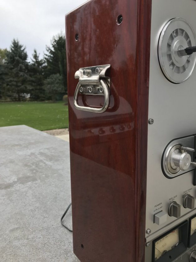

Second on Waterlox. It looks especially good on Walnut.  Easy to apply, although I do it a little differently from instructions. It's got just enough orange-ish color to make the heartwood of walnut look terrific.
This was finished with their satin sheen.
