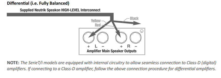

I am connecting Rel T7i on my NuPrime ST-10 amplifier.
How should I treat NuPrime St-10 ? As a class D amplifier? If so, Rel manual says that black wire of Neutrik high-level cable should stay isolated and not connected (https://relsupport.zendesk.com/hc/en-us/articles/115004486607-Class-D-Amp-Connection-Methods):
Some here on this thread claim they connected black wire of Neutrik high-level cable to ground on ST10 chassis:
@rustydogslim , do you know what is correct?
Many thanks.

This issue has come up from time to time. We prefer you directly connect the source signal (if your DAC or preamp has dual outputs) to REL. In the "old days", amps have more distortion; therefore, REL advises using the amp's output to connect to the subwoofer to have the same sound characteristic. This is no longer necessary.
ST-10 has floating ground, we don't recommend connecting REL to the amp's output. But if you want to do that, follow REL's instructions. I think REL has added DC blocking capacitors in their subwoofer so it is safe to do so, but we still don't recommend it.
