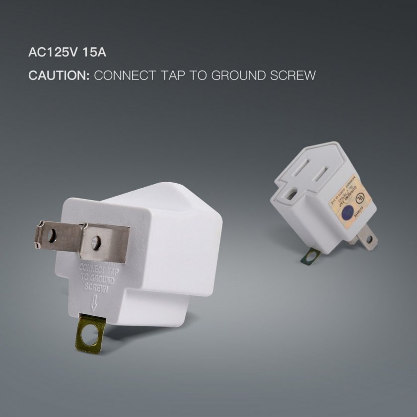

Try to use a AC adapter plug with no ground to see if the noise goes away.
Something like this:

I've already tried the plug with no ground with no success.
