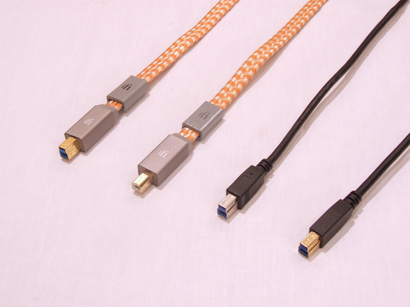

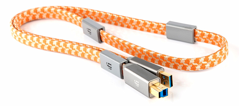

Figure 2. Four USB 3.0 cables - left to right: iFi Audio Mercury3.0 (USB 3.0 B plug connector), iFi Audio Mercury3.0 (USB 2.0 B plug connector), Stock USB 3.0 cable that came with the Rosewill enclosure, Amazon Basics USB 3.0.

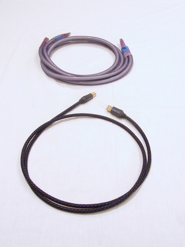

Figure 3. USB 2.0 cables - Revelation Audio Labs Prophecy CryoSilver dual leg (top), Pangea USB PC.
I was quite surprised at how well the stock cable held up against some stiff competition. I was similarly surprised by the sound difference between the two iFi cables. I was most surprised by the poor performance of the Amazon Basics cable.

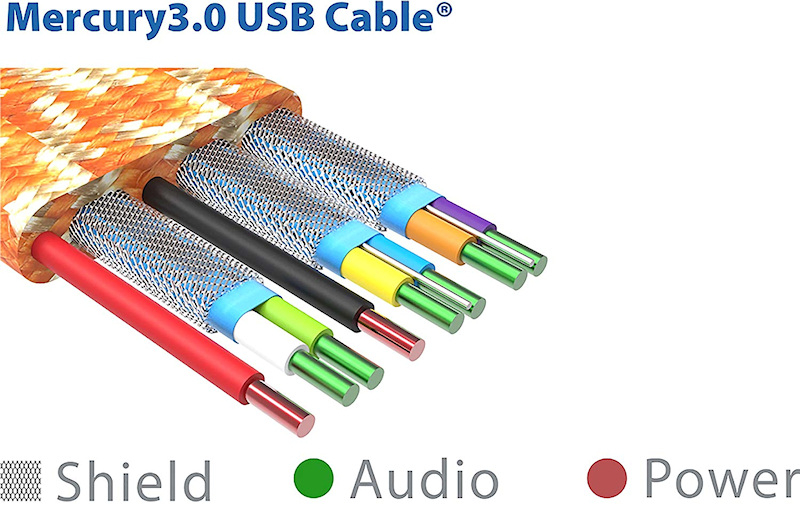

Figure 4. Mercury3.0 uses a minimum inductance parallel conductor arrangement. Some computer grade USB 3.0 cables use a similar arrangement. The flat cable design allows the power conductor to be placed on one end far from most of the signal conductors.
Specifics of the Mercury3.0's conductors:
1. Drawn from 99.99% pure oxygen free high thermal conductivity (OFHC) copper made in a continuous casting process.
2. Copper wires are silver plated.
3. Conductor sizes are 24 AWG (power) and 28 AWG (data).
4. High density polyethylene insulation.
The Mercury3.0 offers the following noise reduction features:
1. Quadruple shielding of audio wires for rejection of radio frequency and electromagnetically induced noise.
2.  Flat (parallel) wire arrangement with power wire located on one side away from most of the audio (data) wires.
3.  Three custom-made movable metal oxide ceramic radio frequency noise silencers.
iFi Audio recommends placing the three silencers at the ends and middle of the cable. I tried the following silencer arrangements:
a) with the silencers in the recommended position,
b) with the silencers all at the B plug end (HDD enclosure),
c) with the silencers all at the A plug end (BDP-3),
d) with a silencer at each end and moving the middle silencer along the cable,
e) with all three silencers in the middle.
I achieved the best sound with the best clarity, detail, and lowest noise floor with all three silencers in the middle.

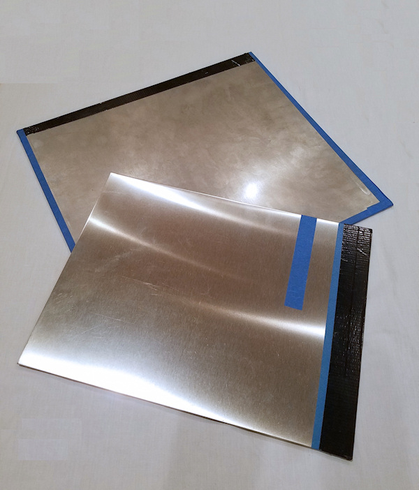

Figure 5. Mu-metal sheet, 13" x 17" (0.062" thick) foreground, stack of four cold rolled steel sheets, 17.5" x 19.5" (0.1912 total thickness) background. More shielding wasn't more better.
I thought if some shielding was good, more shielding would be better. Not this time. The sound character of the instruments did change a little with a stack of steel sheets or a single mu-metal sheet placed on the shelf under the hard drive enclosure and USB 3 cable. With the steel sheets, the pops, snaps, and crackles in the vinyl surface noise of "Saxy" were muted a bit.There was less metallic "zing" in the bell tree flourishes. The weight and overtones of piano notes were diminished and overtones were truncated. With the mu-metal sheet, the sound level balance between background and principle instruments was changed. For example, on "Saxy", the vinyl surface noise and background percussion instruments like the bell tree and shaker were lower in sound level and had less overall detail.
The mu-metal sheet was very effective in shielding my former Pass Labs XP-25 phono preamp from hum induced by the EM field of the X600.5 power amplifier below it. It didn't work well in this application.

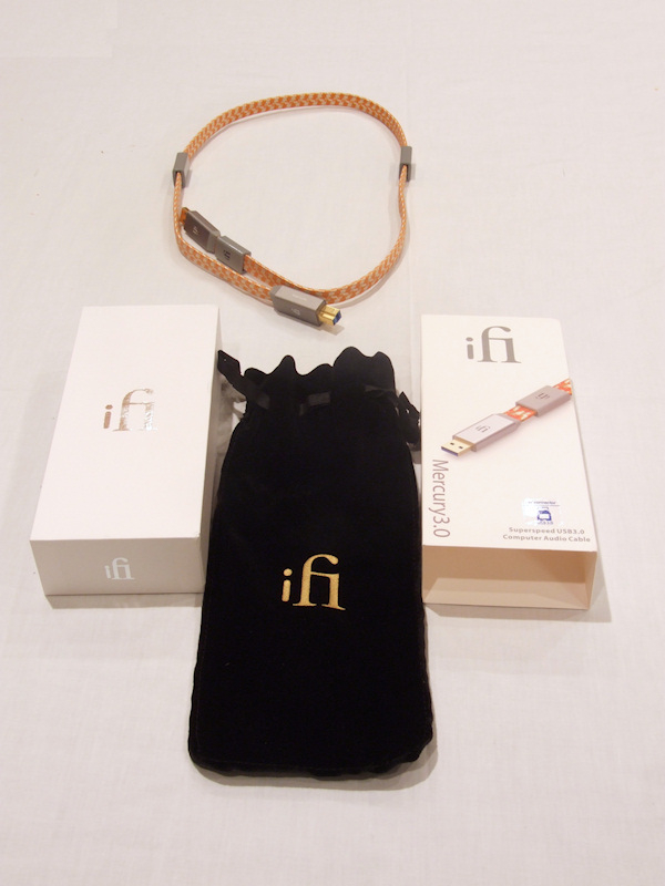

Packaging And Aesthetics
Figure 6. The Mercury3.0's packaging consists of a slip-cased heavy cardboard box and an embroidered velvet bag. The metal ends and ceramic noise silencers were wrapped in small clingy blue plastic sheets.

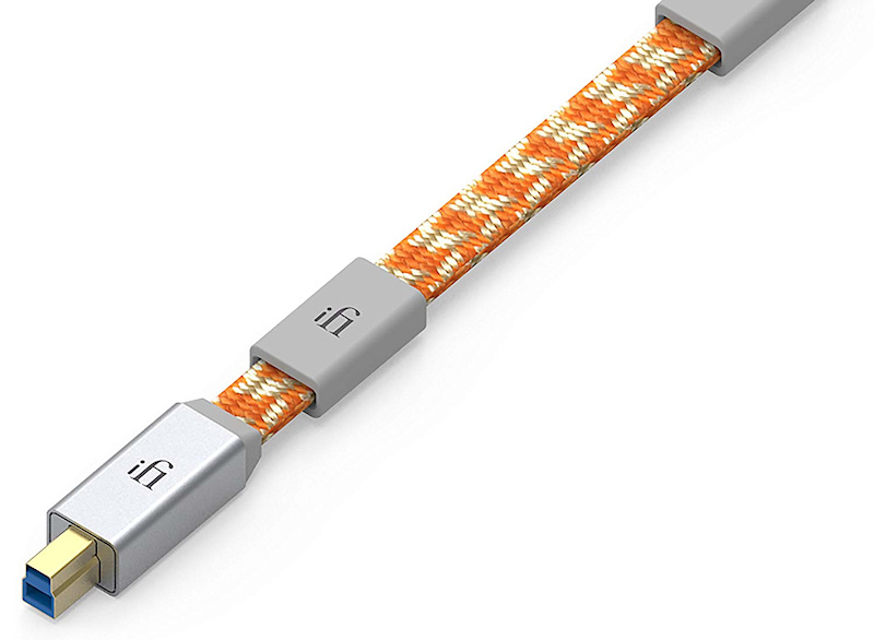

Figure 7. The Mercury3.0's connectors are machined entirely from solid, aircraft grade aluminium and provide end to end radio frequency shielding.
Figure 8. The Mercury3.0's jewel-like connectors and exotic orange and champagne colored silky jacket braid fit in well with my two channel stereo's assortment of boutique audiophile interconnects and power cables.  :)

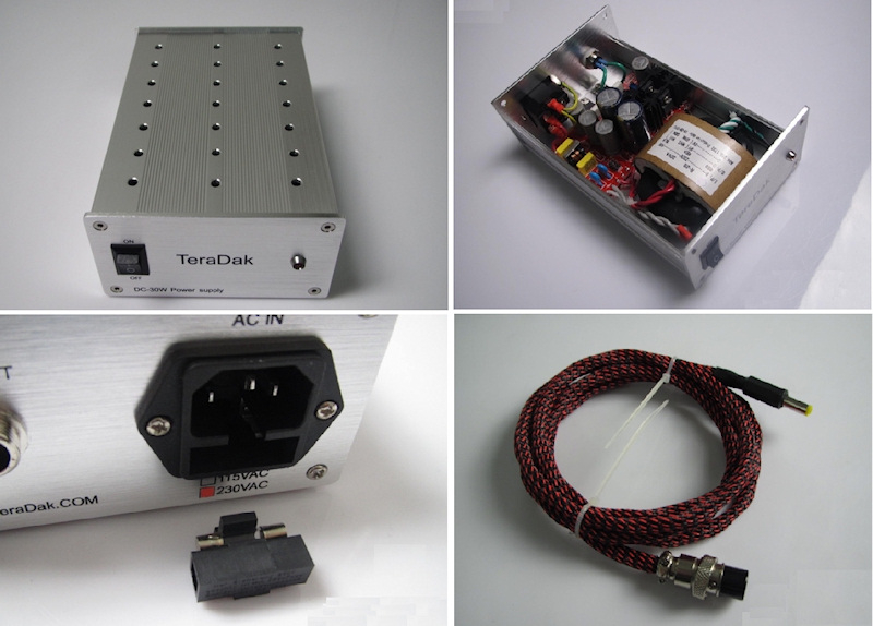

Further Study
A TeraDak DC 30W linear power supply (also known as the Musical Fidelity V90-DAC HiFi linear power supply) that outputs 12 volts and 2 amps is on order. It will be evaluated as a possible upgrade to the ifi-Audio iPower power supply that currently supplies power to the hard drive enclosure. The TeraDak, at $150, is three times the price of the iPower. As its informal name suggests, it was designed as an upgrade power supply for Musical FIdelity's V90 DAC ($299).
Figure 9. I am looking forward to hearing what the TeraDak DC 30W linear power supply can do.
