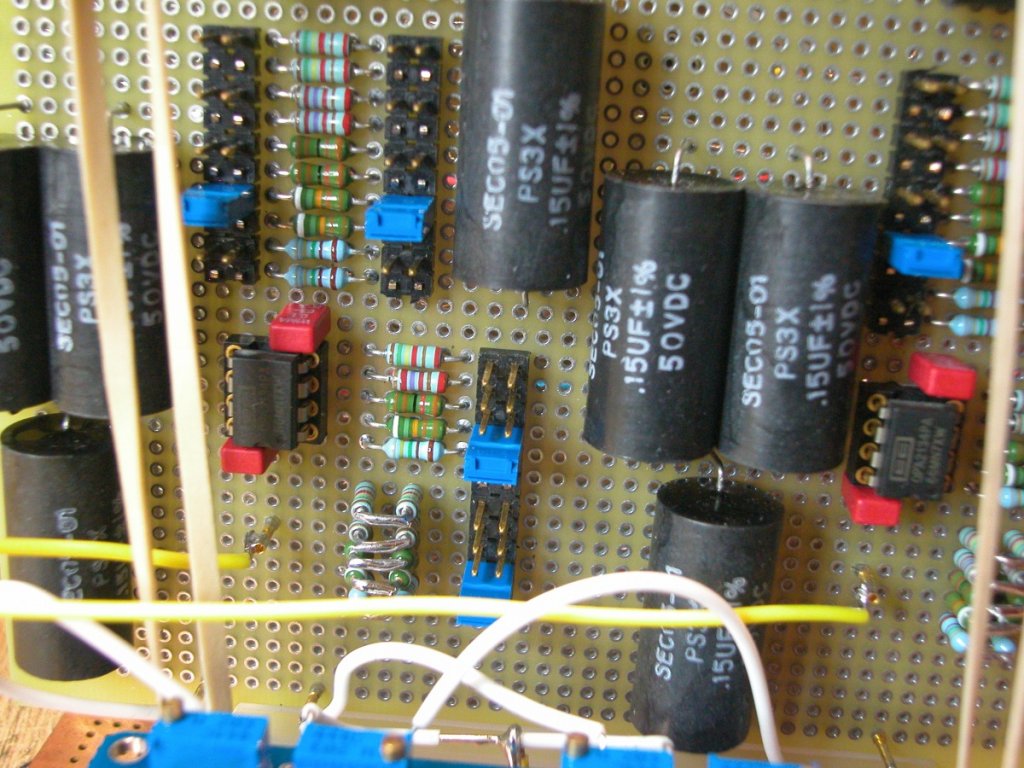

I have made passive high pass filters before.... good film caps and  vishay foil resistors inside a tiny metal box with RCA's in and out (inline). Not very advanced, but measurable on paper.
I've also previously made (have) an active 24dB Linkwitz/Riley filter, with 0.5% polystyrene caps and similarly matched resistors......adjustable cutoffs via jumpers.
....that's just my history.....I'll contact you for current recommendations regarding these (CIA) units.  :)
