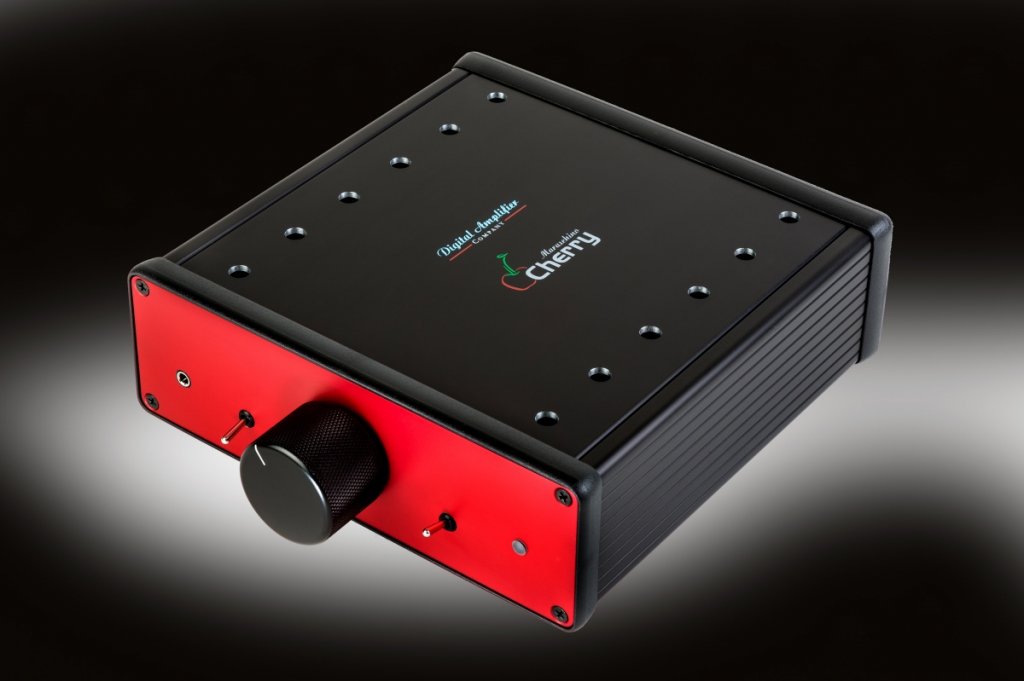

The NAD M27 is 7 channels.  The Cherry Amps are 2 channels (also offered in higher powered Monoblocks, same specs otherwise).  Cherry MEGA specs based on 1800W transformer and double cap upgrades.  The Parasound A51 amp is 5 channels.
Just the specs first....  We can compare other factors later, such as subjective sound quality and price.
Power Output, continuous power per channel into 4Ω, all channels driven
    Parasound: 400W
    NAD: 180W
    Cherry Maraschino Stereo: 400W
    Cherry Classic ULTRA Stereo: 675W
    Cherry MEGA Stereo: 800W
THD+N, 10W into 8Ω
    Parasound: unknown (rated < 0.2 % at full power)
    NAD: 0.005%
    Cherry Maraschino Stereo: 0.02%
    Cherry Classic ULTRA Stereo: 0.005%
    Cherry MEGA Stereo: 0.001%
SNR, A-weighted
    Parasound: 112dB
    NAD: 118dB
    Cherry Maraschino Stereo: 120dB
    Cherry Classic ULTRA Stereo: 116dB
    Cherry MEGA Stereo: 120dB
Damping Factor
    Parasound: >1100 at 20Hz only
    NAD: >750 at 50Hz-1kHz
    Cherry Maraschino Stereo: >400 at 0Hz-1kHz, >300 at 10kHz
    Cherry Classic ULTRA Stereo: >180 at 20Hz-1KHz
    Cherry MEGA Stereo: >400 at 0Hz-1kHz, >300 at 10kHz
Frequency Response
    Parasound: 5Hz to 100kHz (AC coupled)
    NAD: 3Hz to 100kHz (AC coupled)
    Cherry Maraschino Stereo: 0Hz to 100kHz (DC coupled)
    Cherry Classic ULTRA Stereo: 1Hz to 60kHz (AC coupled)
    Cherry MEGA Stereo: 0Hz to 150kHz (DC coupled)
Input Impedance
    Parasound: 94k
    NAD: 47k
    Cherry Maraschino Stereo: 40k
    Cherry Classic ULTRA Stereo: 20k
    Cherry MEGA Stereo: 20k
Input Sensitivity
    Parasound: 1.4V
    NAD: 1.3V
    Cherry Maraschino Stereo: 3.2V
    Cherry Classic ULTRA Stereo: 2.4V
    Cherry MEGA Stereo: 3.2V
Weight
    Parasound: 80 lbs
    NAD: 31 lbs
    Cherry Maraschino Stereo: <3 lbs
    Cherry Classic ULTRA Stereo: 42 lbs
    Cherry MEGA Stereo: 42 lbs
