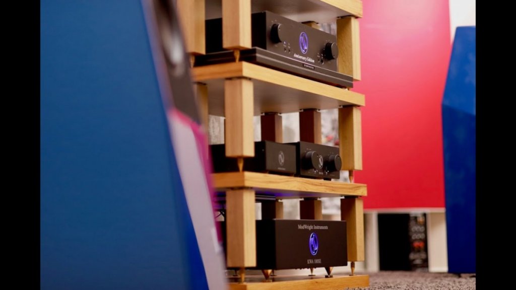

So grateful to Ron Brenay of New Record Day for such a fantastic review of a complete ModWright System driving Wilson Sabrinas!:
PH 9.0 tube phono stage.
SWL 9.0 Anniversary Edition tube preamp.
KWA 100SE Mosfet SS power amp.
Please check out the review as well as the rest of Ron's work!
https://www.youtube.com/watch?v=FM2nxM7qDfk
