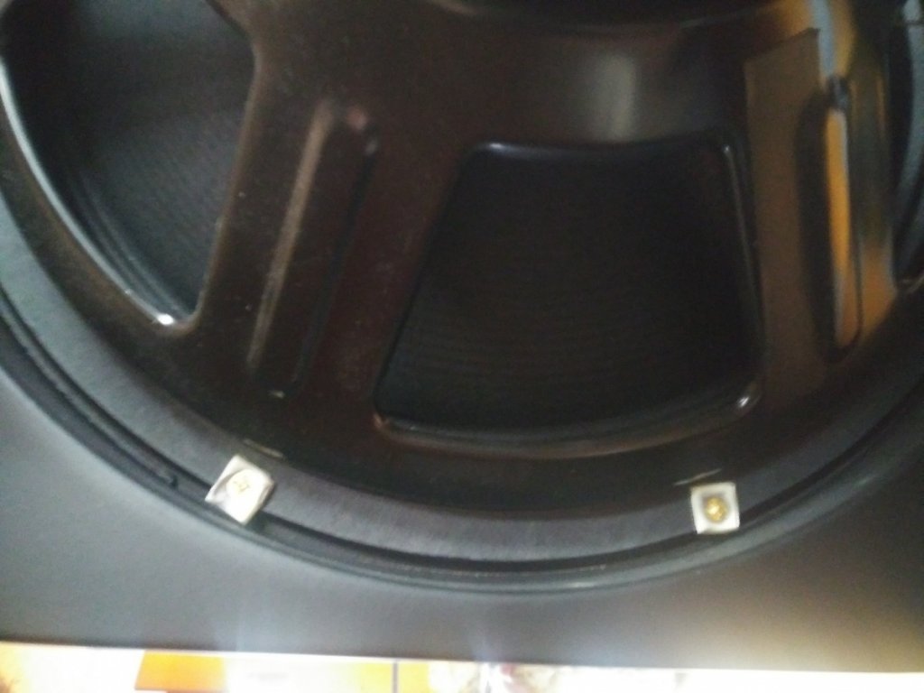

I have the M3 Turbo S... Therefore, in the true spirit of our hobby- never leaving well enough alone, I will also be trying brass screws and listen for what changes may occur.
I won’t be removing the grille cloth, making the conversion that much easier. I’m also going to try and find some rectangular brass washers of some sort, to more evenly spread out the screw torque across the driver basket rim. Something like these:
https://www.nationalengfasteners.com/products/category/193-rectangular-washers
It seems a lot of expensive speakers make heroic efforts to really fasten the driver to the baffle, so maybe there is something to it.

Hi Tim, I can send a photo, but I did not do it for looks so I can tell you that it is not pretty. My M3's are flat black and so it clashes with the brass and white gasket (Herbies product). If I were doing it for looks (which matters less on the back of the frame) probably best to pre paint the screws and isolation gasket.

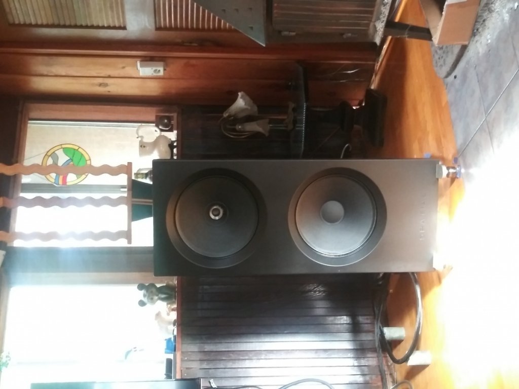

As per request here are a few photos:

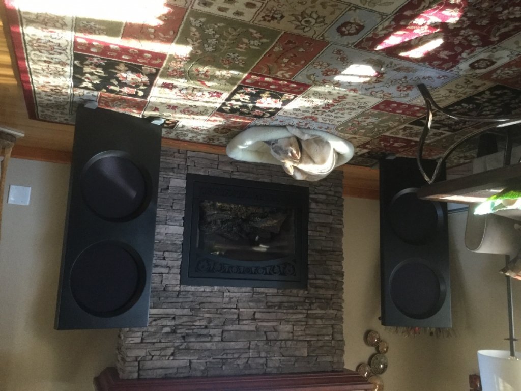

Ric, my M3’s are right in the middle of the living room, so removing the grilles is just not domestically feasible.
However, I will be doing the brass screw thing as soon as I get the supplies. As an aside, due to the open baffle design, you can see my dog thoroughly enjoying the approximately -6db null between the speakers. (Measured very unscientifically with a RadioShack SPL meter.
Maybe a moderator can turn my picture right-side up...
ric
  • Posts: 373
Still trying to think of a way to have the grills removable. That way aesthetically pleasing when not in use. Hope your dog doesn't exercise by doing leg lifts!

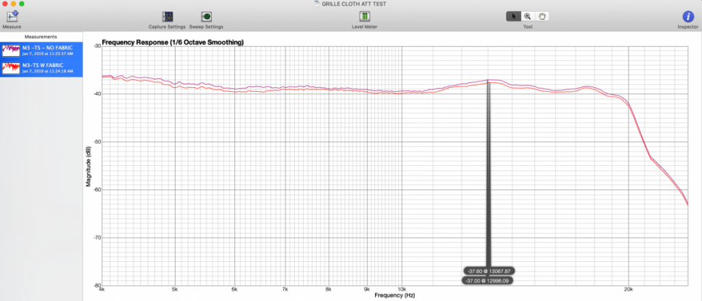

2) Grille cloth removal - Ric's hearing must be world class, since the cloth is almost perfectly transparent acoustically . The cloth only attenuates the compression driver's output by 0.60dB as shown below. More importantly, the attenuation is exactly the same across the range, so the result would be that the range from 1kHz to 20kHz is now 0.6dB louder. 30-40% improvement in sound?
