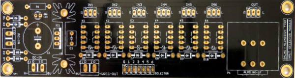

This thread is timely as it encourages me to finally put this together. I have had the board, and parts for awhile. I will be using a stepped attenuator in place of the Alps pot.
https://www.diyaudio.com/forums/group-buys/291429-gb-salas-select-mesmerize-type-input-selector-volume-control.html
