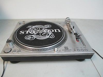

So ive been trying to get into vinyl forever, and i finally got the chance to get a turntable, which was given to me for just a couple of hours of raking leaves, that turntable being the stanton str8-80.
Problem is, because this is a DJ table, the tonearm is underhung making it impossible for proper cartridge aliment. But i found that it was possible to change the tonearm setup in this table for an "s" shaped arm. Im asking how antiskate works because the str8-80 doesnt have antiskate, but the tonearm assembly im putting on it does. Would i be able to do this? Is antiskate a passive thing? Or does it have to be powered in some way, because if it needs to be powered i wouldnt be able to hook up the antiskate.
The stanton str8-80, short arm and has no antiskate
