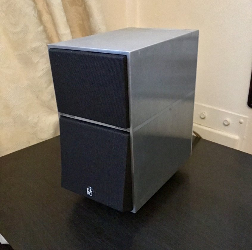

Hi everyone, I just thought I would document my progress by posting images and info on here regarding my latest Bang & Olufsen classic speaker project. I’m in the middle of modifying multiple pairs of Beovox CX-50 for use in a high end Dolby Atmos 7.1 cinema system. The first picture below is of them before mods are done. Jeff helped advise with the circuit construction...
B E F O R E
A F T E R

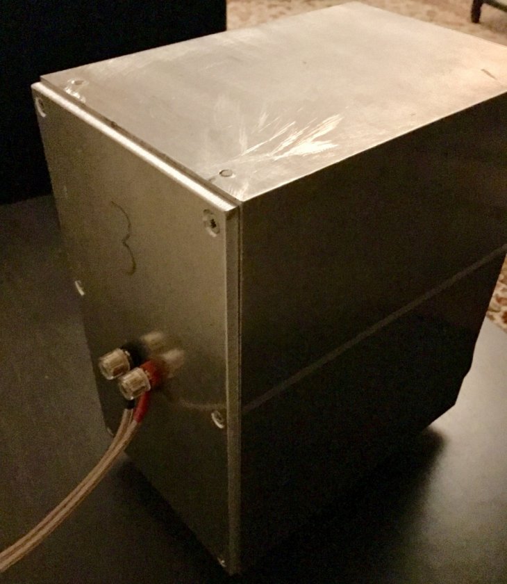

The CX-50 uses a bombproof (heavily braced) aluminium cabinet with a thin plastic rear cover.

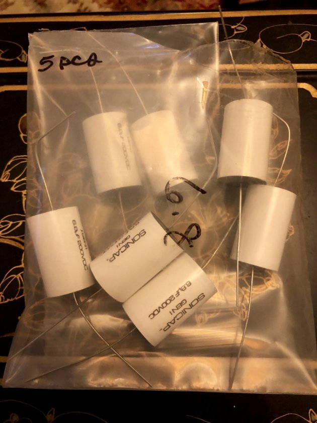

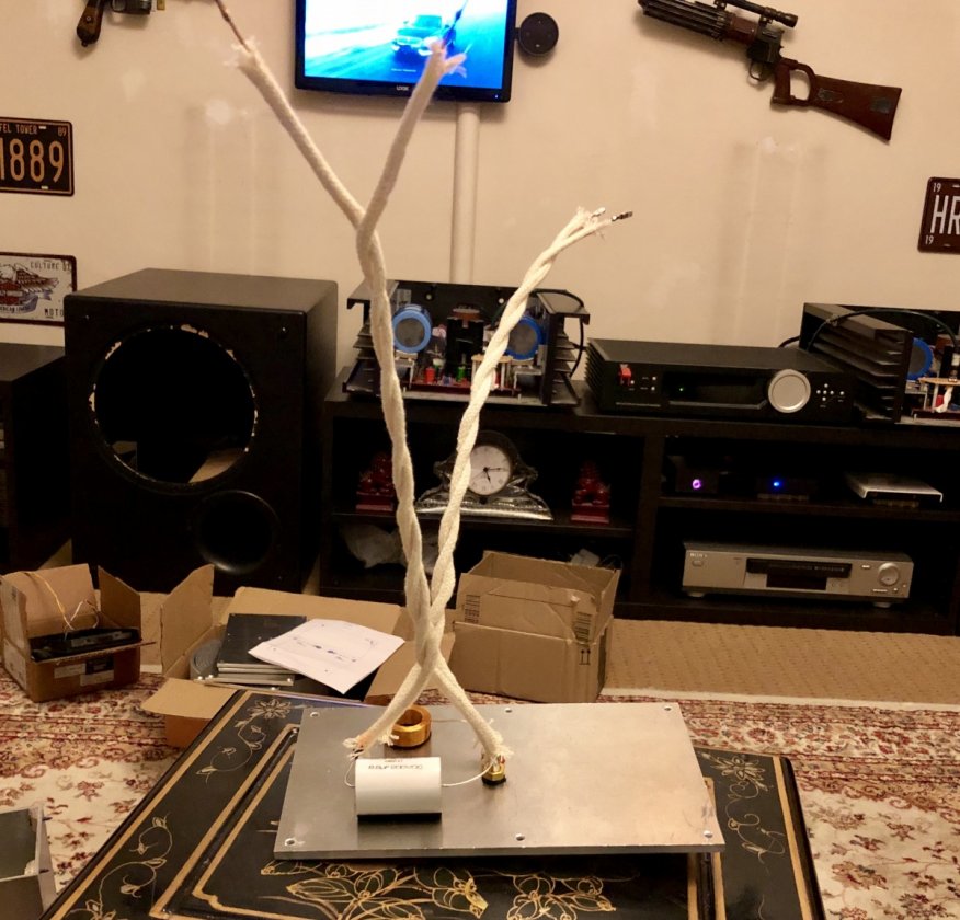

SONICAP PLATINUM GEN 1 FILM CAPACITORS (6.8uf)...

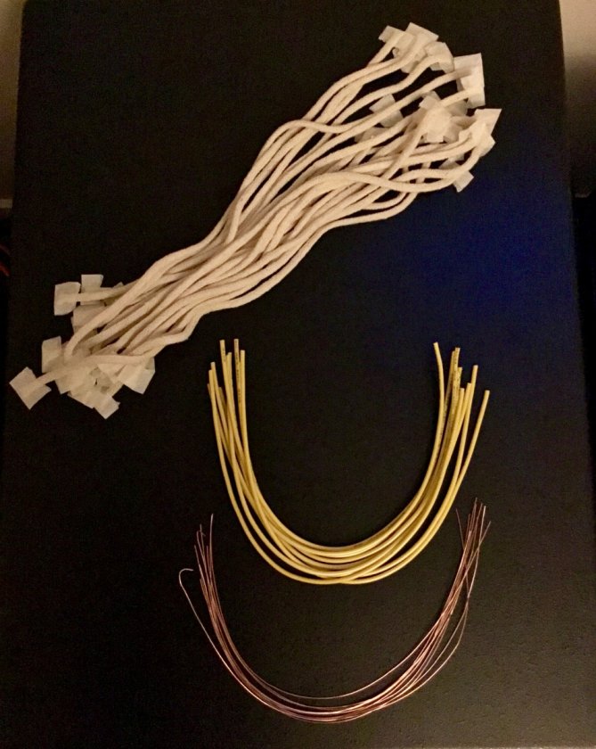

Pure Cotton washing line cut into multiple lengths for use as sleeving. Neotech 16awg solid core copper wire for the bass mid drive unit (going to strip off the pvc sleeve). I also used some 6N Jupiter 23 awg copper wire for the tweeter unit which I already had laying around the house...

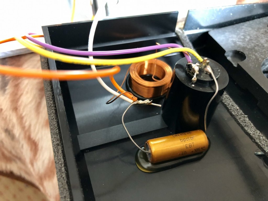

CIRCUITS BEFORE MODIFICATIONS...

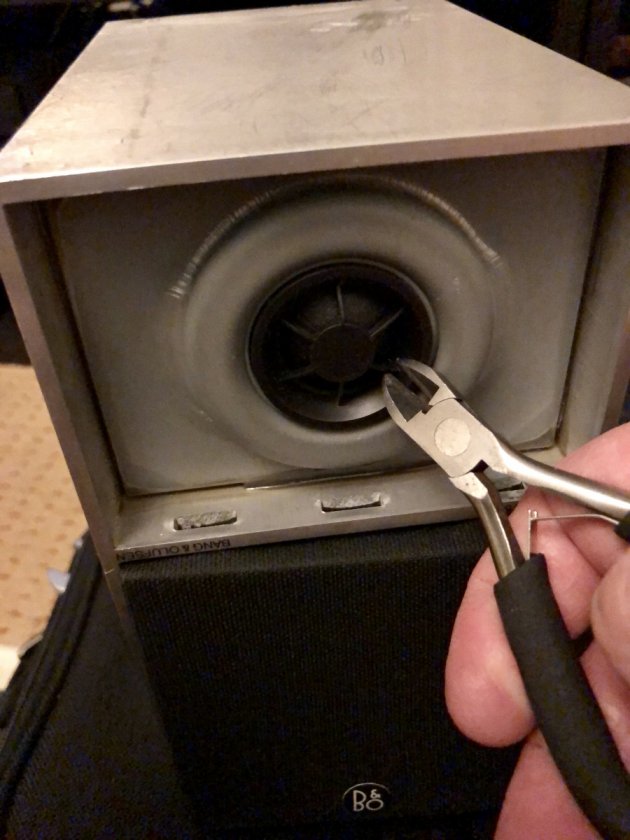

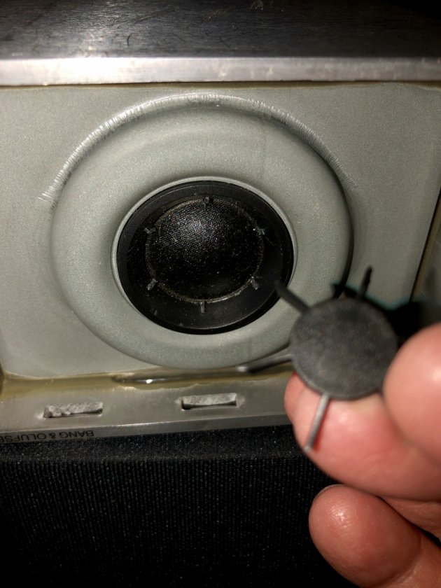

TWEETER HAS AN OBSTRUCTIVE SHIELD COVER (DETRIMENTAL TO PERFORMANCE) WHICH I CUT OFF...

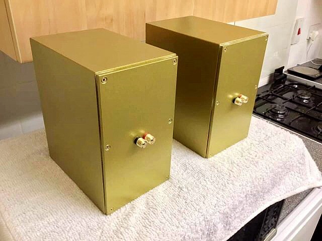

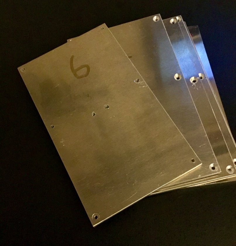

REPLACEMENT SOLID ALUMINIUM PANELS FOR THE REAR OF CABINETS...

MODIFIED CIRCUITS ON NEW REAR PANELS...

FITTED REPLACEMENT REAR PANELS...

The tweeter cap was to stop bad beaming and make off-axis volume on par.

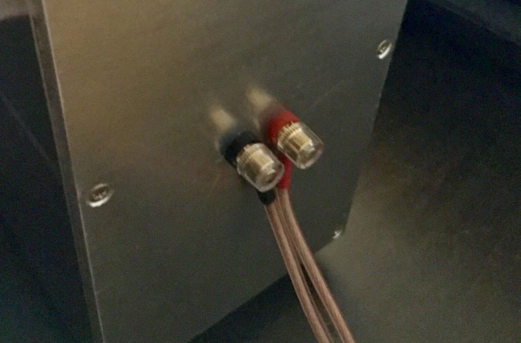

REPLACED THE CRAPPY ‘2 DIN’ CONNECTOR SOCKET WITH A SET OF GOLD PLATED SPEAKER BINDING POSTS...

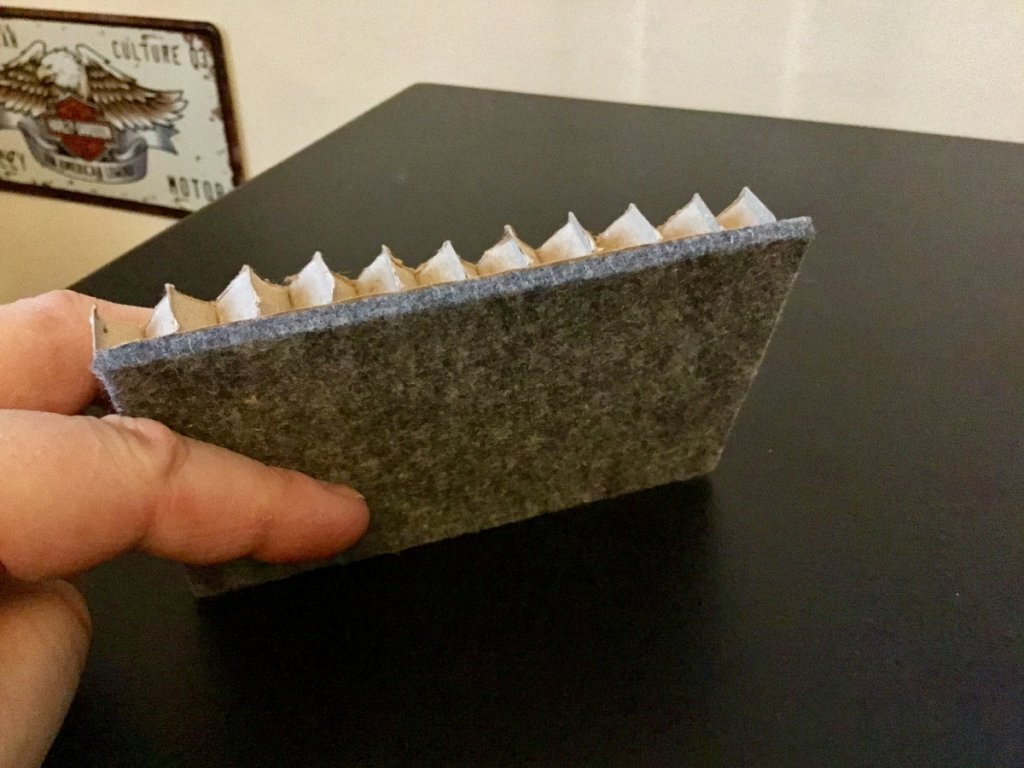

I’M SITTING THE SPEAKERS ON TOP OF “DIY VIBRATION ISOLATORS” THAT I MADE OUT OF OLD PARCEL PACKING MATERIAL...
Folsom, with the cap in place I could hear a slight coloration in the treble region. After removing the cap; the treble opened up and sounded more natural.

Anyway, your project looks great :D  I'm glad to hear it turned out.  I would have not removed that phase plug/lens.  But, it tends to help more on hard domes, or bright tweeters.  If you say it sounds better...you are the ears on the ground  :wink:  At first when you were referring to it as a cap, I thought you meant capacitor  :scratch:
Well done.  I'm surprised you used those low copper brass BPs after being so meticulous with the wire.  However, I bet they beat what you had.
Jeff, advice is appreciated. The tweeters were definitely too bright before I cut off the phase lens. After I did this the treble smoothed significantly. The cabinets are hermetically sealed (more or less); which prevents the problem of the open sleeve copper wires oxidising. How long should I burn in the Sonicaps?
I hear improvement up to ~350 hours.
