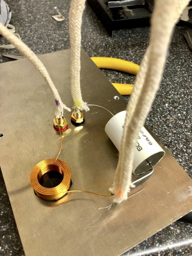

Sorry I didn’t draw a modded schematic. The best I can do for you is provide the following photo shown here...
OSIB16
  • Posts: 390
Re: BANG & OLUFSEN BEOVOX CX-50 SPEAKER PROJECT
« Reply #22 on: 26 Jul 2020, 03:13 am »
PURPLE = 18 GAUGE TWEETER
WHITE = 18 GAUGE TWEETER
ORANGE = 16 GAUGE BASS/MID
YELLOW = 16 GAUGE BASS/MID
((ALL SOLID CORE WIRE. NOT STRANDED)))
((DON’T USE THINNER THAN 18 GAUGE WIRE FOR TWEETER, OTHERWISE TREBLE IS TOO BRIGHT))

I have stuck with original circuit board layout. The worst thing you can do is to use silver for the tweeter. As it stands the tweeter suffers with excessive brightness. The best thing is to use 18 Gauge copper (solid core). The fatter you go with copper, the more you can reduce the treble.

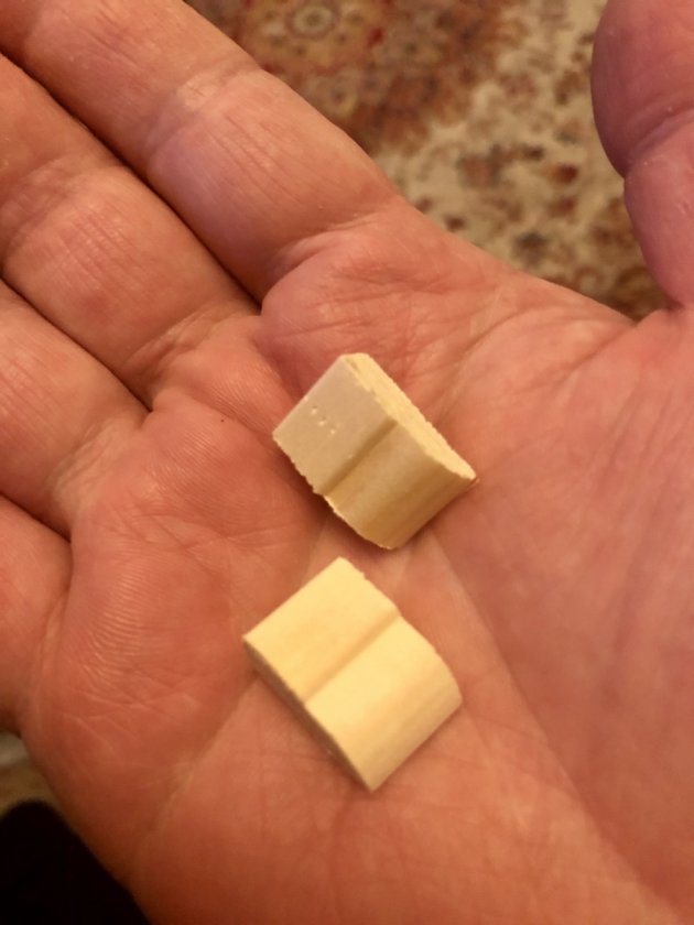

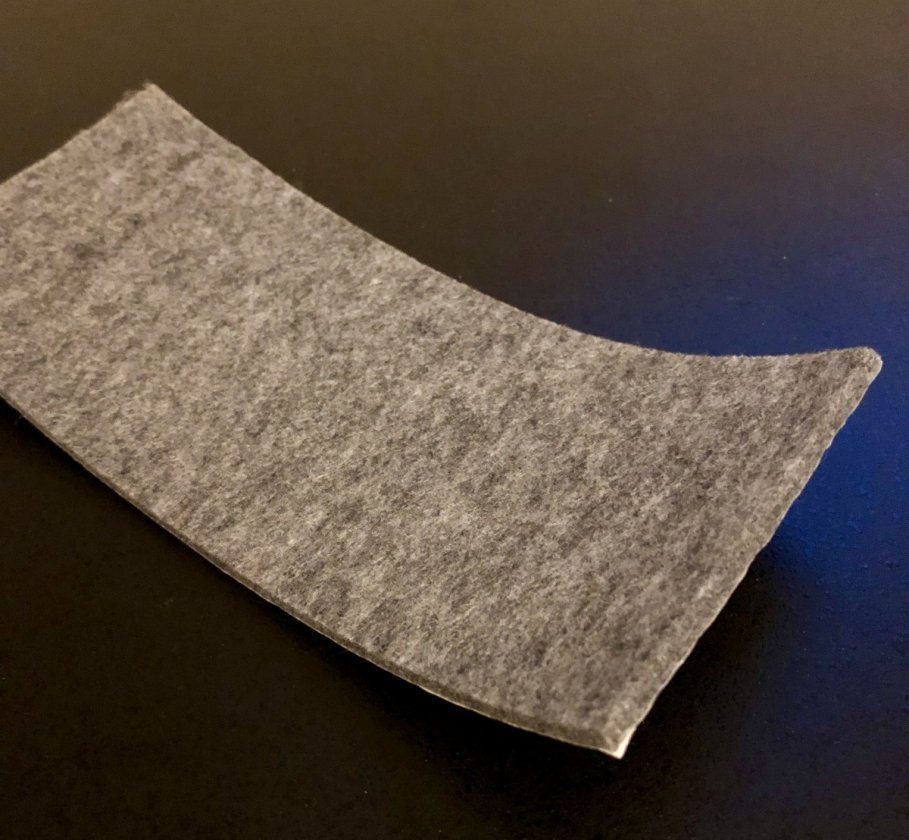

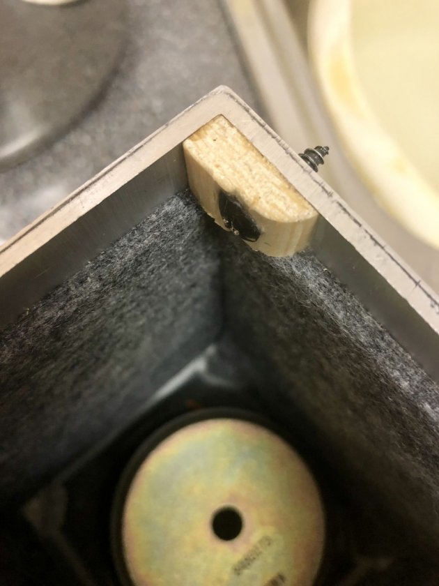

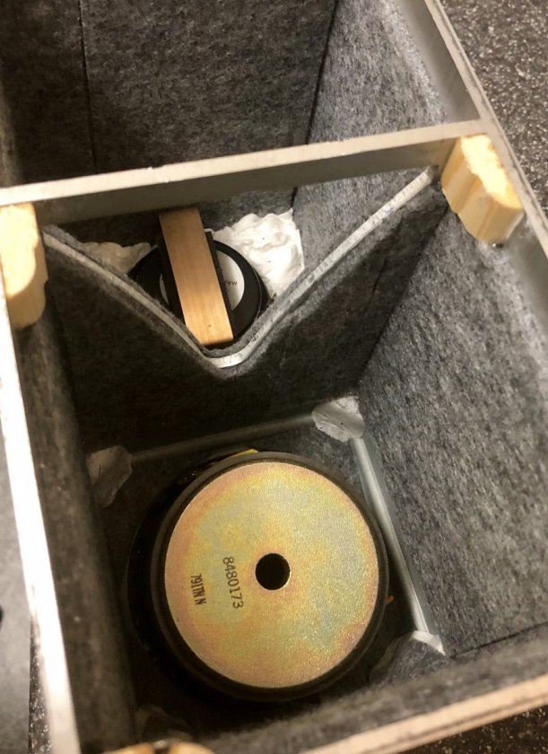

ALL INTERNAL WALLS OF CABINET LINED WITH 4.5MM THICK WOOL (ADHESIVE BACKED)...
WOODEN BISCUITS GLUED AND SCREWED INTO EACH CORNER. THE REAR SPEAKER PANEL SCREWS ONTO THESE TO SECURE IT TO THE BACK OF THE SPEAKER...
Jeff, just stumbled across this and it brought back memories as I used to sell these speakers. A couple of comment if I may...
Instead of damaging the cabinets with external screws for your biscuits, I would have recommended exposing an threaded .5-1" hex spacers in each corner which would also allow you to use machine screws. It is not clear that you did this but I would also use a gasket between the back panel and the enclosure. Hope you are enjoying them!

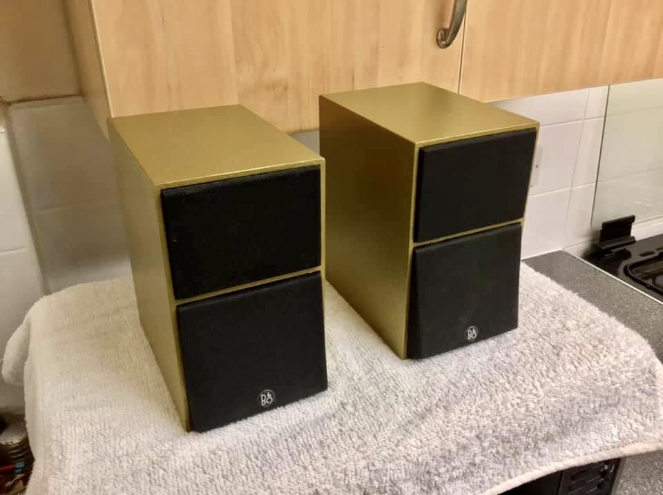

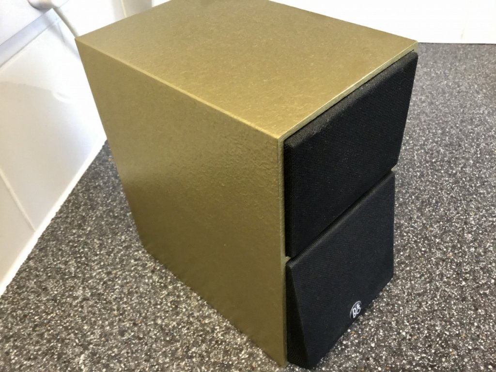

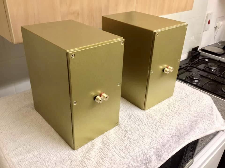

Hi Marks, this was my CX-50 speaker, project. Thanks for the tip for attaching the rear metal panels. I’ll bear it in mind for the future. Luckily I only paid approx £50 for the speakers on EBay which is pretty cheap. Anyway; I cut the protruding screws off, and filled any small dents with a decent filler. Then I painted the cabinets. Below is the finished product which works great and are a vast improvement over the originals. By the way I also used a gasket tape equivalent between the rear metal panels and the cabinets, which stops any vibrations.
