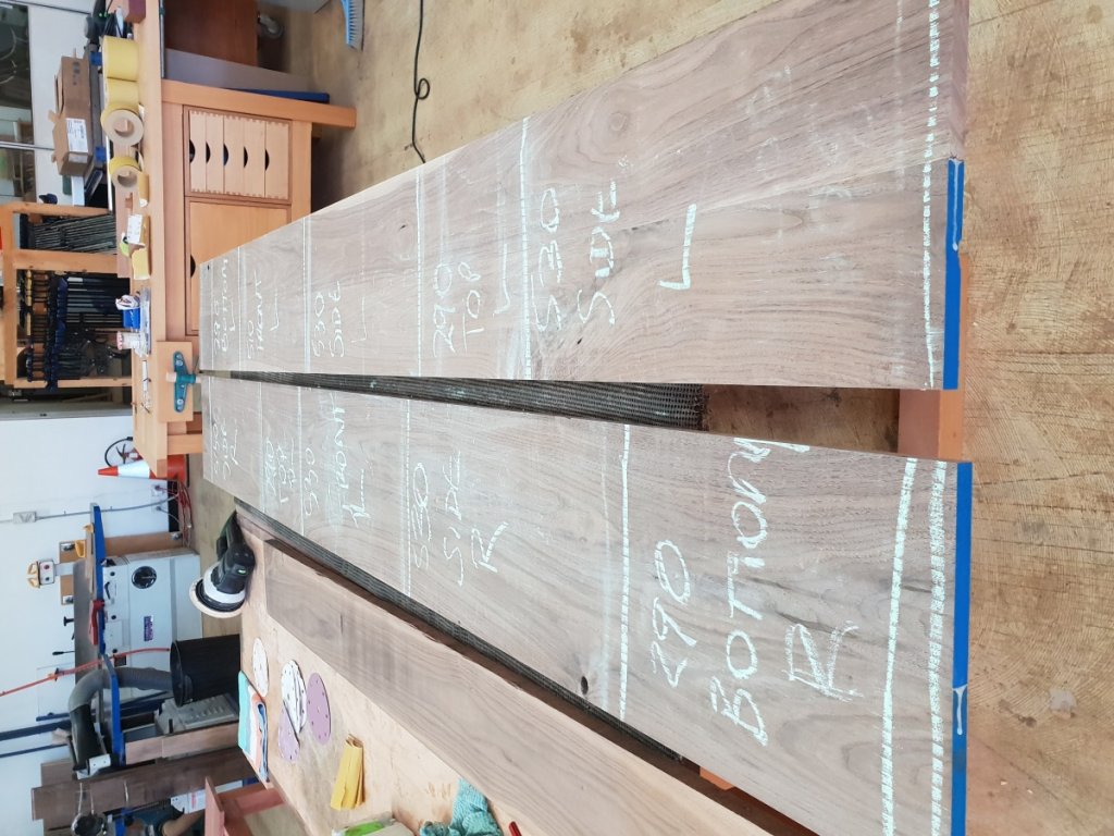

« on: 15 Dec 2018, 10:48 pm »

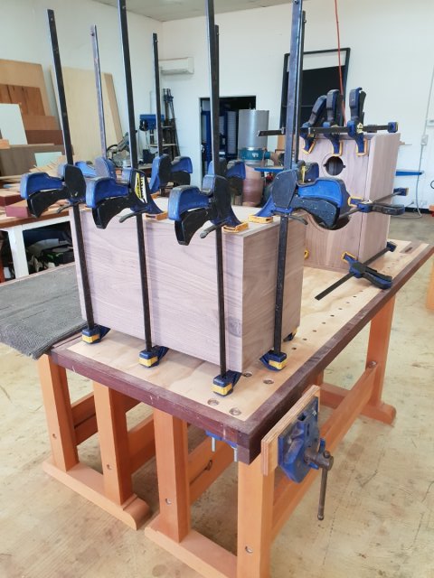

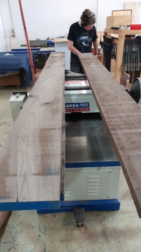

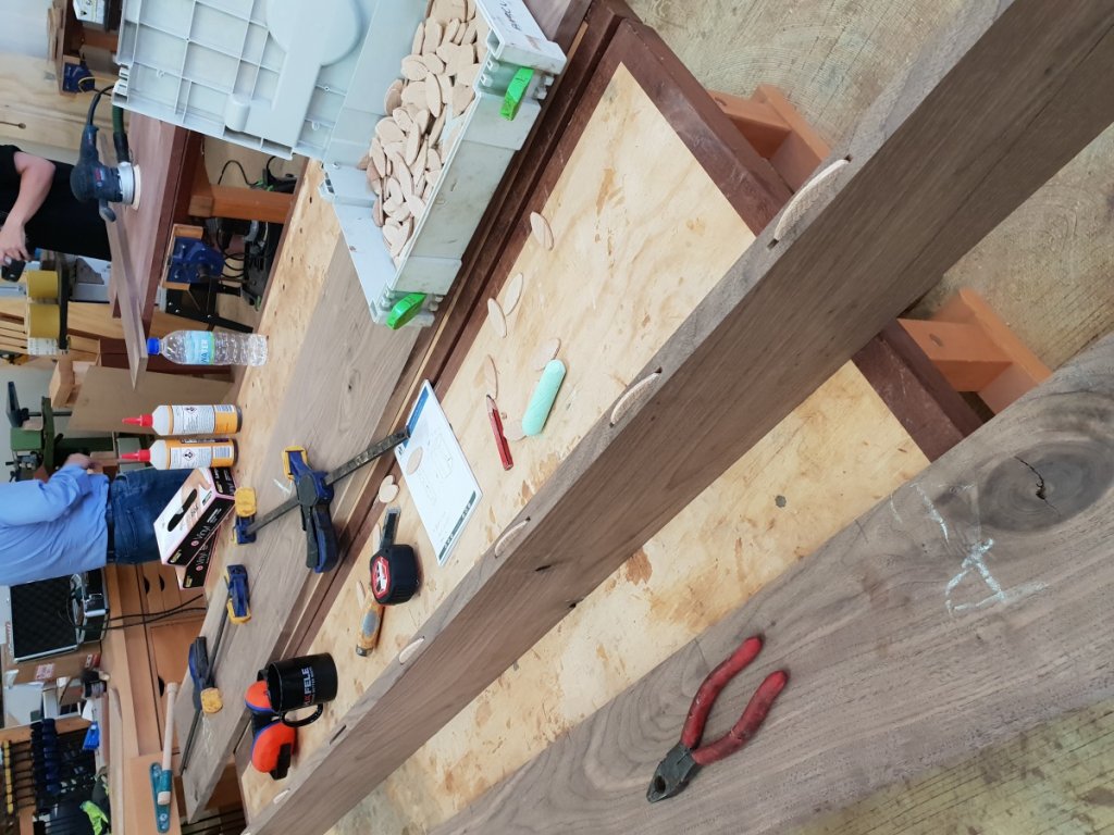

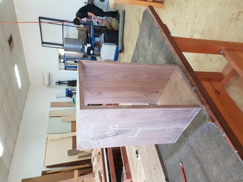

Hi Guys,
New speaker build and I thought I'd create a post and show pictures of my progress.  Using 1 inch American Walnut and will plane down to 3/4
inch to remove imperfections.  The speakers will be 20 inch (h) x 11 inch (w) x 13 inch (d).  I will use tung oil to apply finish.  I'm hoping I will finish January.
Cheers Rod

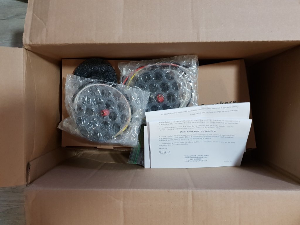

« Reply #3 on: 24 Dec 2018, 12:19 pm »

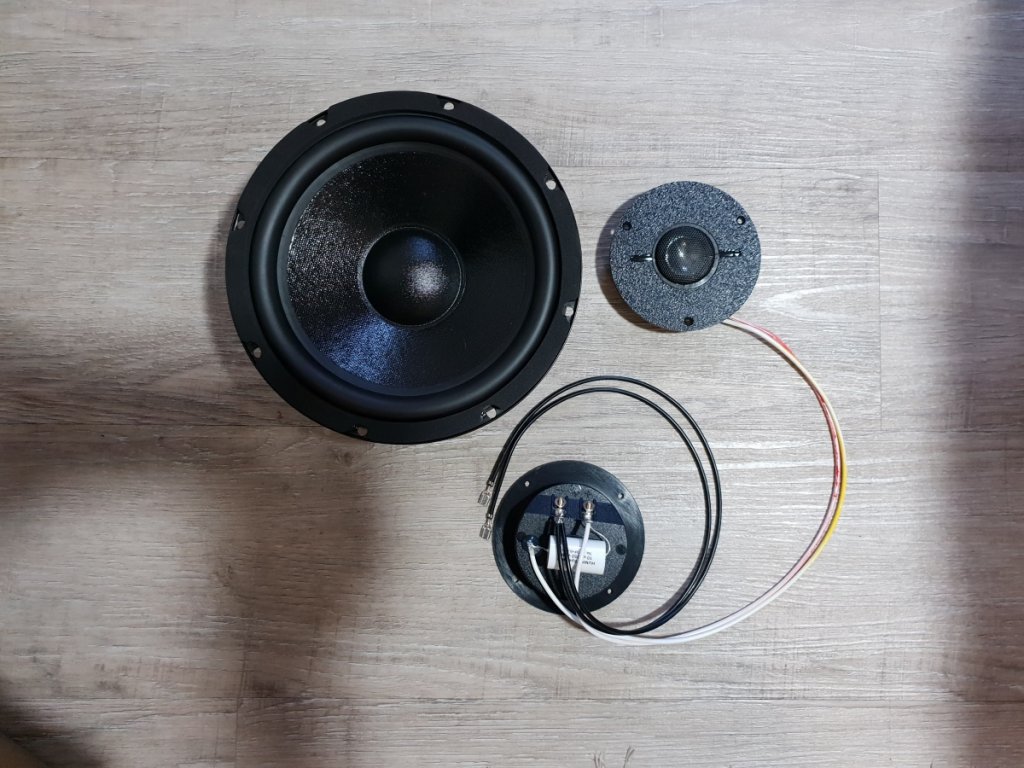

Hi Guys,
I sure wish I'd made the title of my speaker build 'recommend amplifier, or preamplifier, or dac' I might have generated a lot of interest lol.
Anyway, new photographs of my speakers that I'm building at the moment.  Human Speakers components safely arrived in Perth, Western
Australia.  Ready to finish the cabinets in the new year.  Cheers Rod
S Clark
  • Posts: 7560
Re: Human Speaker K81 Speaker Build
« Reply #4 on: 24 Dec 2018, 02:16 pm »

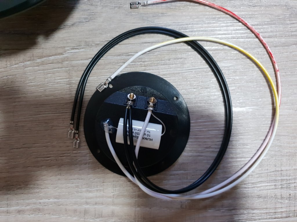

The crossover is one cap and the woofer runs full range?

Hi Guys,
Some information from the Human Speakers website.  I chose this speaker kit because its a bit different, I liked the story of the company and was recommended by an audiophile friend from the USA (I value this persons advice and knowledge).
http://www.humanspeakers.com/diy/81.htm
My speaker parts are rugged and purist. They are designed to complement each other's range and clarity. The woofer, in this cabinet, is flat from 37 Hz (-6 dB at 26 Hz, -12 dB at 18 Hz) to 1800 Hz, where the tweeter takes over (most tweeters couldn't handle a crossover this low) and finishes the job out to 26 kHz, beyond human hearing. A minimalist crossover design prevents stored energy from smearing the musical detail and provides excellent transient response./quote]
After much agonizing over the various choices available, I opted for a very simple crossover - just one carefully-selected capacitor to protect the tweeter from low frequencies. This is possible because the woofer and tweeter actually roll off on their own at the designed crossover point of 1800 Hz./quote]

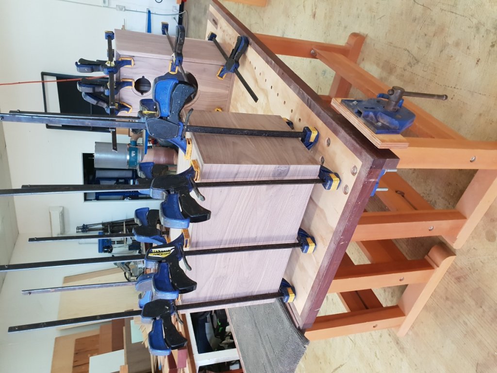

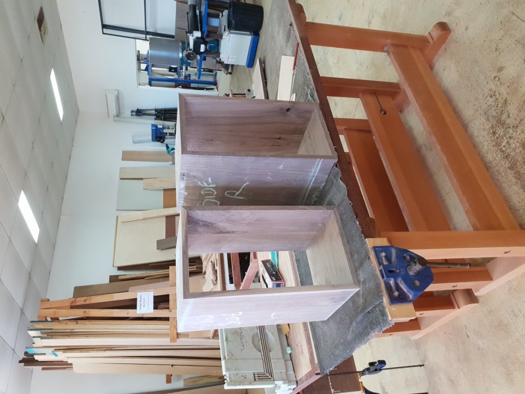

Rocket

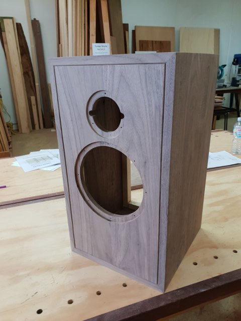

« Reply #11 on: 11 Jan 2019, 12:20 pm »

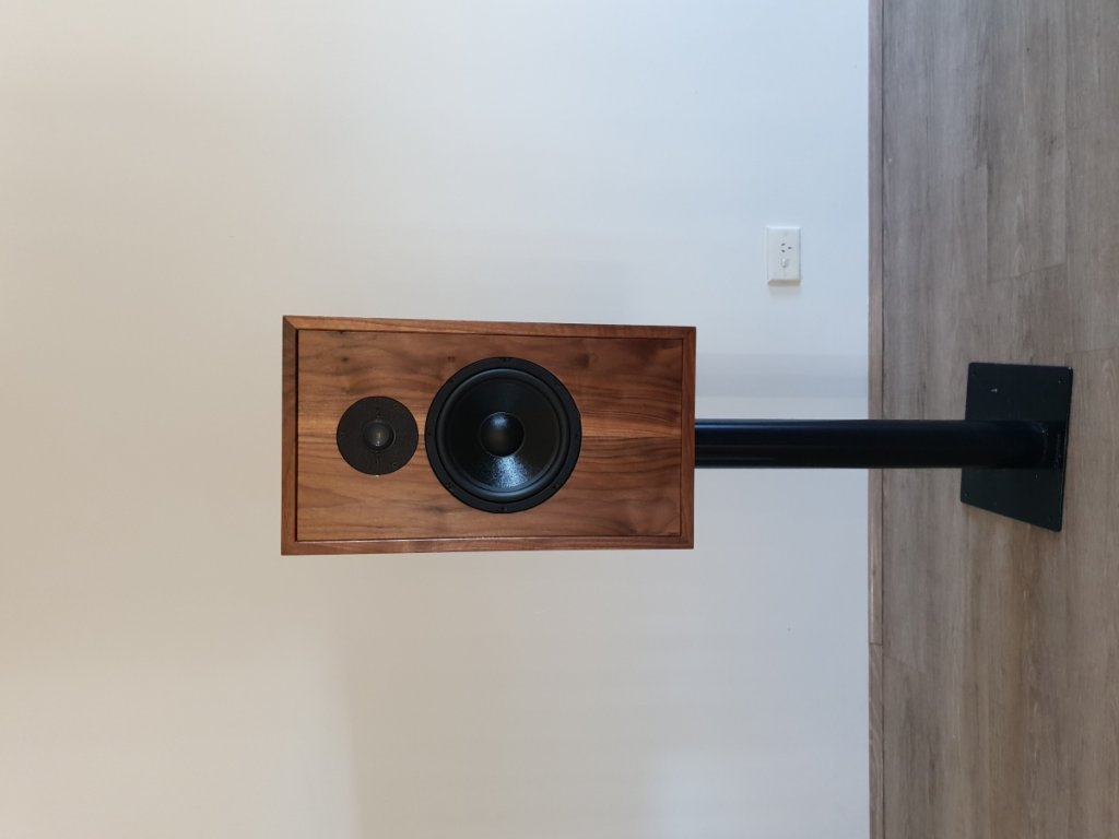

Hi Guys,
Latest update on my build.  Speakers are ready for tung oil and will be finished tomorrow.  I damaged one of the tweeters and waiting on a replacement one.  This is the best speakers I've built so far and hoping the kit is a good as the cabinets.  Btw going to use a Red Wine Audio Isabella Preamplifier and PS Audio HCA2, Eastern Electric Dac plus and Goldnote Turntable.  Not cheap and cheerful and hoping the system sounds fantastic.
Cheers Rod
JakeJ
« Reply #12 on: 11 Jan 2019, 01:55 pm »
Solid black walnut cabinets?  Wow, those will be some sturdy speakers.  With internal bracing they will be like bricks.
I gave your pictures a twist.
Of course it will, how could it not?
Boys got skilz  8)  I like that thin line around the baffle, nice touch!

Agreed!  And I like that line too, it frames the baffle like a picture.

Looking REALLY good. There's just something about "classic" speaker boxes I love ; I think it's their proportions and simplicity that holds true. Walnut always looks great. Can't go wrong.

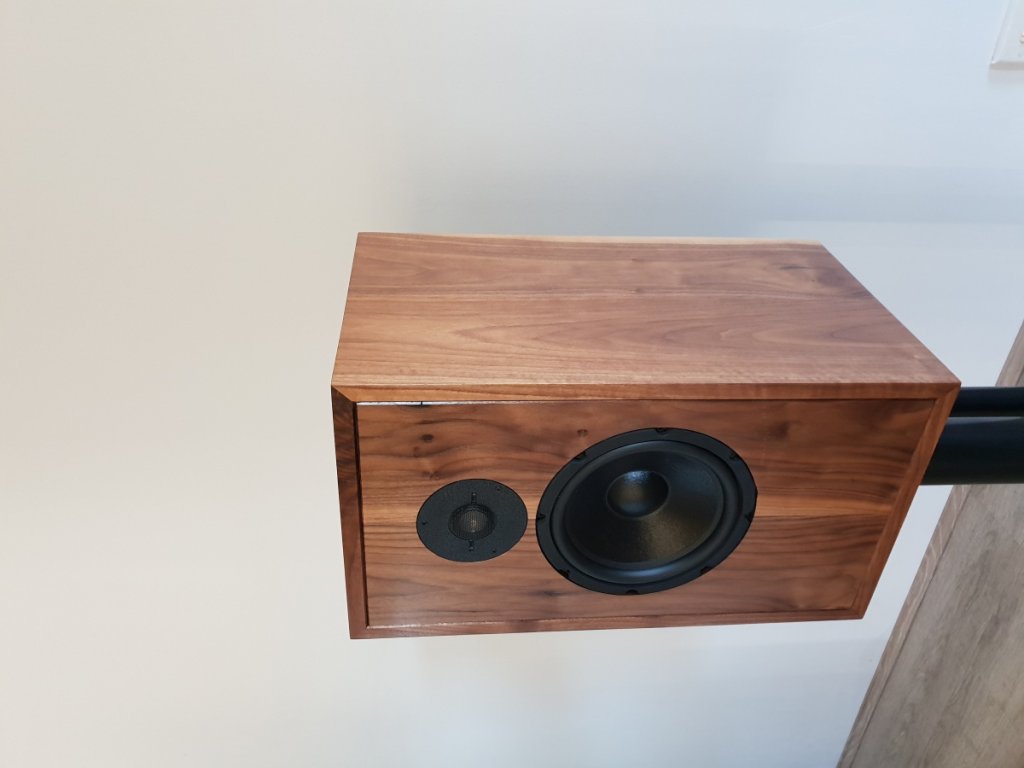

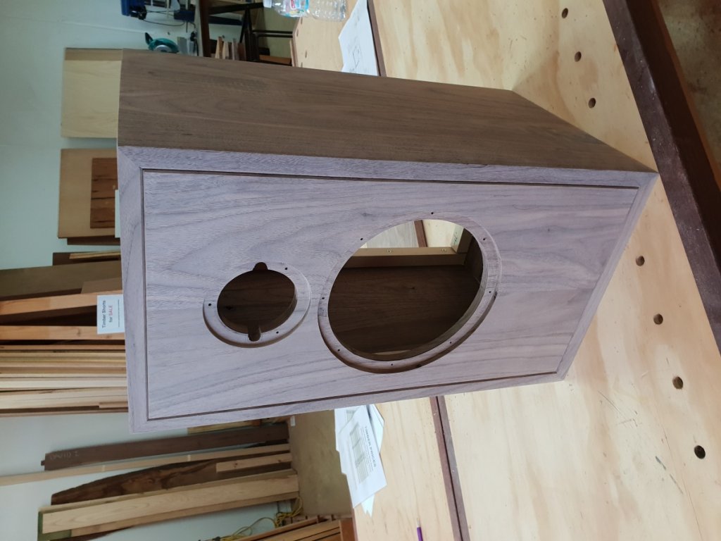

Rocket
« Reply #16 on: 12 Jan 2019, 12:38 am »

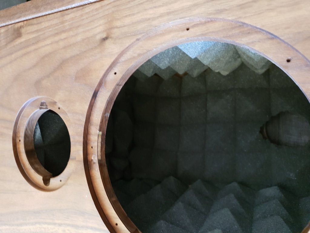

Hi Guys,
I made a mistake when I was hand planing the baffles and the gaps were a bit uneven.  A friend advised routing the edge on the baffles and the cabinets.  Did a great job of hiding the problem and gives the cabinets a bit of class.
I'll post some more photos once I applied the finish.  Should look great.
Cheers Rod

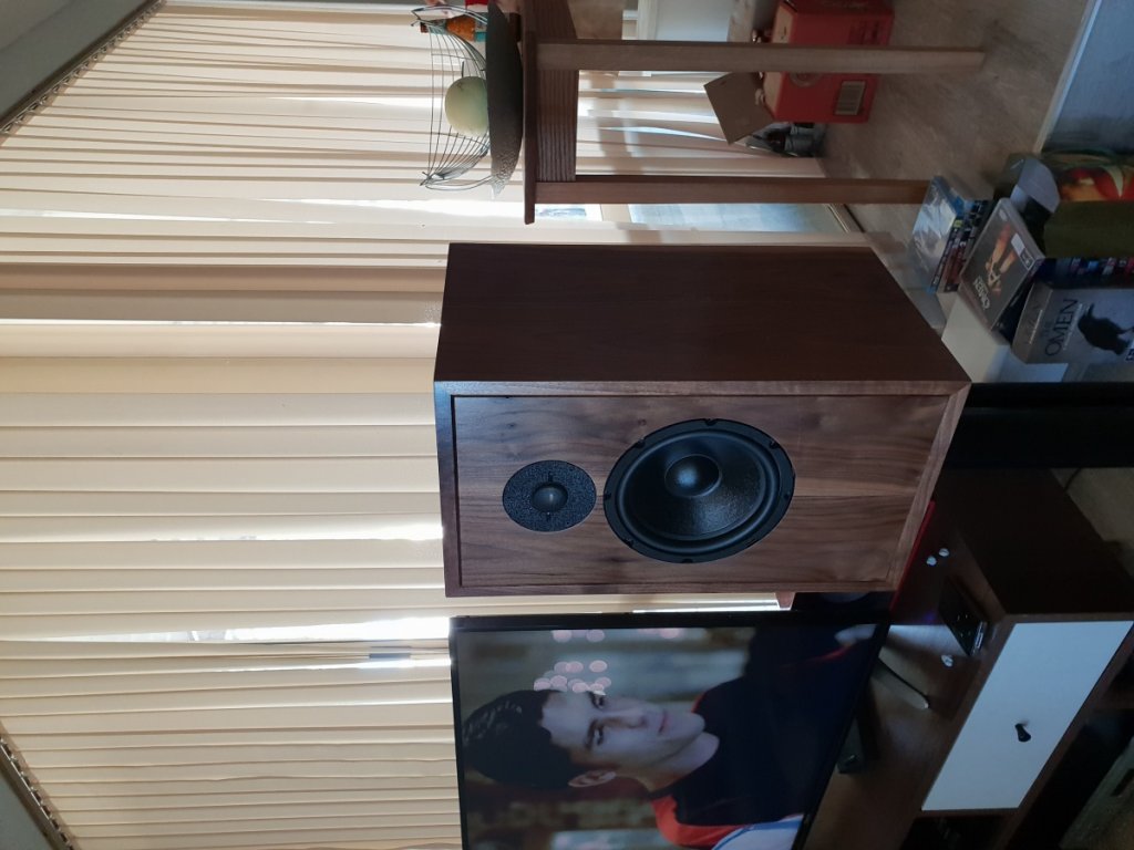

Rocket
« Reply #17 on: 27 Jan 2019, 11:13 am »
Hi Guys,
I've assembled the speakers as far as possible.  Unfortunately I damaged one of the tweeters and waiting for a replacement one from Human Speakers.  Hopefully, next week they will be up and running in my system.  The speakers came out better than I expected. I made one mistake routing one of mid/bass drivers but its almost unnoticeable.  Dimensions 22" (h) x 11" (w) x 13" (d).
Cheers Rod

Very nice!
richidoo
« Reply #19 on: 27 Jan 2019, 04:23 pm »
Yeah, looking real good Rod!
DIY always has a few minor flaws... They remind you of your accomplishment.
What finish did you use? It looks very natural.  :thumb:
