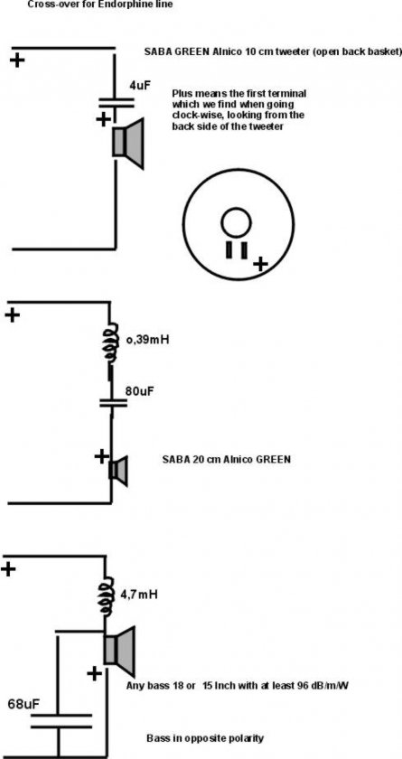

Re: Understanding this crossover system
« Reply #20 on: 3 Dec 2018, 04:00 pm »
That's perfect thanks.
Now to understand the low pass crossover.
I will make a guess. The inductor itself is low pass and the capacitor is there to bypass the driver of any high frequencies.
That's somewhat correct.  As frequency rises, the impedance of the capacitor decreases.  Without taking into account phase shift, think of the capacitor as a variable resistor in parallel with a 8 ohm resistor (the driver).  As frequency rises, the resistance of the variable resistor decreases.
At 292 hz, a 68 uf capacitor has an impedance of 8 ohms.  So, if we treat it as an 8 ohm resistor in parallel with another 8 ohm resistor, you get the equivalent of a 4 ohm resistor.  At 877 hz, the impedance of the capacitor is 2.66 ohms.  This in parallel with the 8 ohm driver is 2 ohms.
Given a fixed inductor value, the voltage drop across the inductor will increase and the voltage drop across the parallel capacitor/driver will decrease as the signal frequency increases.  The voltage changes occur twice as fast as they would without the capacitor.
The same voltage will always pass thru the capacitor and the driver at ALL frequencies.
In reality, the impedance of a 8 ohm resistor in parallel with a 68 uf capacitor at 292 hz is 5.66 ohms with a -44.9 degree phase shift.

I have returned to this topic as it has proven extremely valuable and my speakers
now sound just 10% short of perfect. Thanks so far.
My last focus is on the midrange driver which is a Supravox alnico T215 RTF 64. I find the driver performs great at its lower frequencies and doesn't need a filter there, so I removed the series capacitor.
I am therefore left with single quality inductor in series. Over extended listening there is a very slight raggedness to the upper frequencies of the Supravox so I would like to lower this low pass filter frequency a little.
Here are my questions
1. With just a single series inductor what type of filter is this (first or second order, Butterworth? etc)
2. If I add a parallel capacitor to it,  what type of filter do I get and presumably the low pass frequency is lowered.
Thanks

S Clark
  • Posts: 7566
« Reply #28 on: 14 Apr 2021, 01:28 pm »
"I find the driver performs great at its lower frequencies and doesn't need a filter there"
How did you determine this?  By ear? By measurement?  Removing the cap means the mid will reach well down into the woofer range and result in superposition addition (and cancellation when out of phase).
1. Remove the cap and you have a first order on the top range of mid and nothing on the bottom.  The overlap with the woofer will be unpredictable.
2. Put the cap parallel and you have next to nothing on the mid.  The inductor passes lows, the cap will pass highs and the mid will see the sum of both- or play sort of a screwed up full signal.

« Reply #32 on: 14 Apr 2021, 03:13 pm »
On the woofer, the second order crossover has an inductor in series and a cap that bypasses.  The inductor blocks high frequencies going to the woofer.  The bypass cap passes high frequencies and blocks low frequencies, letting the highs pass the woofer.  The textbook effect is a 6 dB reduction in highs by filtering by the inductor and another 6 dB reduction by letting highs bypass at a chosen crossover point.
If you put both in parallel to each other and in series to the mid, one will block lows and pass highs and the other will block highs and pass lows... kinda cancelling the effect of each other--- obviously depending on values chosen as to which frequencies are affected.  As designed, with a cap and coil in series, they work together to allow the passage of a mid range frequency (high treble blocked by coil, low bass blocked by cap).    But I may be misreading what you are proposing....

given that the driver will have an impedance is this what the call an LR filter?
Yes, L for inductance, R for resistance.
I think you may be.  :)
The inductor is in series as now (6dB reduction of highs) and the capacitor would be parallel to the driver and therefore bypass it (further 6dB reduction of highs). Is this a Butterworth second order (12db) low pass?

« Reply #35 on: 14 Apr 2021, 04:28 pm »
Yes, not sure how Butterworth is defined, but it is a traditional second order, 12dB filter.

The single inductor of 0.39mH and the 8 ohm driver gives a low pass of about 3200Hz.
With the added cap I would like to bring that to about 2000Hz, (and from 6db to 12dB slope) but the calculators I have found suggest that the inductor is not in the required range, so I may have to start over with both components - it gets a bit expensive experimenting with quality components :(
I have tinnitus and I think it is triggered by 'distortions' at about 4000 Hz so there is an added reason to pursue this.

If available, check the impedence of the driver at the crossover frequency.  It may not be 8 ohms.
See in the graph below, the impedance changes as frequency changes.  This is a mid made by Peerless/Tympani, a respected driver.

Quote from: Bumpy
I tried also with the capacitor in place and SQ suffered.
This almost always occurs in the mid.  It is a critical position.  While it can, and will, degrade mid performance, many times the alternative is worse as it is necessary to control the response of the mid.  If you are able to omit it, consider yourself lucky.
Given that the driver will have an impedance is this what the call an LR filter?
It would not be called a LR here.  By definition, impedance is frequency dependent reactance, not DCR.
Butterworth describes the characteristics of the rolloff (Q=.707).  Does your rolloff approximate this Q?
I'll try some calculations and see what I come up with. The single inductor of 0.39mH and the 8 ohm driver gives a low pass of about 3200Hz. With the added cap I would like to bring that to about 2000Hz, (and from 6db to 12dB slope) but the calculators I have found suggest that the inductor is not in the required range, so I may have to start over with both components - it gets a bit expensive experimenting with quality components :( I have tinnitus and I think it is triggered by 'distortions' at about 4000 Hz so there is an added reason to pursue this.
When switching from a single pole to a two pole mid LP, you should also consider the tweeter cap value.  The issue that you site, is it better, worse, or the same when the tweeter is connected?
With this fly by the seat of the pants design approach, you should not be using expensive parts.  However, as mentioned before, they do need to stay the same for each position as you adjust values.  While it may not sound wonderful as a whole, the best sounding topology with cheap parts will also sound the best with better parts.  I would recommend using film everywhere, and air core inductors.
What are the consequences of allowing the driver to be open to very low frequencies. Obviously this will present a higher impedance, but how will that manifest itself?
The higher imp results in rolling the driver off (woofer).
If the boost or cancellation is not detrimental to the response, you only concern is excessive cone excursion (mid).
