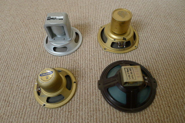

Having Tinnitus (years of riding a noisy Harley) is a real challenge. Firstly one can have no idea what specific frequency triggers it, though in my case high frequencies are suspected. Secondly its also a phycological response so just concentrating hard to analyse sound triggers it, and sometimes just remembering you have tinnitus triggers it!
Nonetheless I have the option of four suitable tweeters namely Siemens, Grundig (small and big) and Saba Greencones. All are vintage paper cone, alnico magnets so both tonally and in sensitivity they are well matched to the other two drivers.
My choice ATM is the Saba Greencone it is the smoothest and less likely to trigger the Tinnitus.

« Reply #45 on: 25 Apr 2021, 03:14 pm »
[quote author=Jeff link=topic=161048.msg1855466#msg1855466 date=1619293022
Now, you are looking at a different tweeter before further fleshing out the XO?  I'd would have assumed you would have selected the best candidate before starting...
[/quote]
Correct,  I had all these tweeters in place during my early evaluation and each was listened to for extended periods as single drivers. The Siemens (biggest magnet) was the most dynamic and full of life, and the Saba was the smoothest overall (smallest magnet) and showed up best as a flat response on REW.  I do realise that magnet size does not always correlate with 'performance' and that these vintage driers extend nowhere near the upper reaches of modern tweeters. But they are open backed, which of course is a bonus for OBs :)
I had originally chosen the Siemens for its sense of realism, but it demonstrates that interactions with the mid range and crossovers also have a big bearing in overall SQ.
