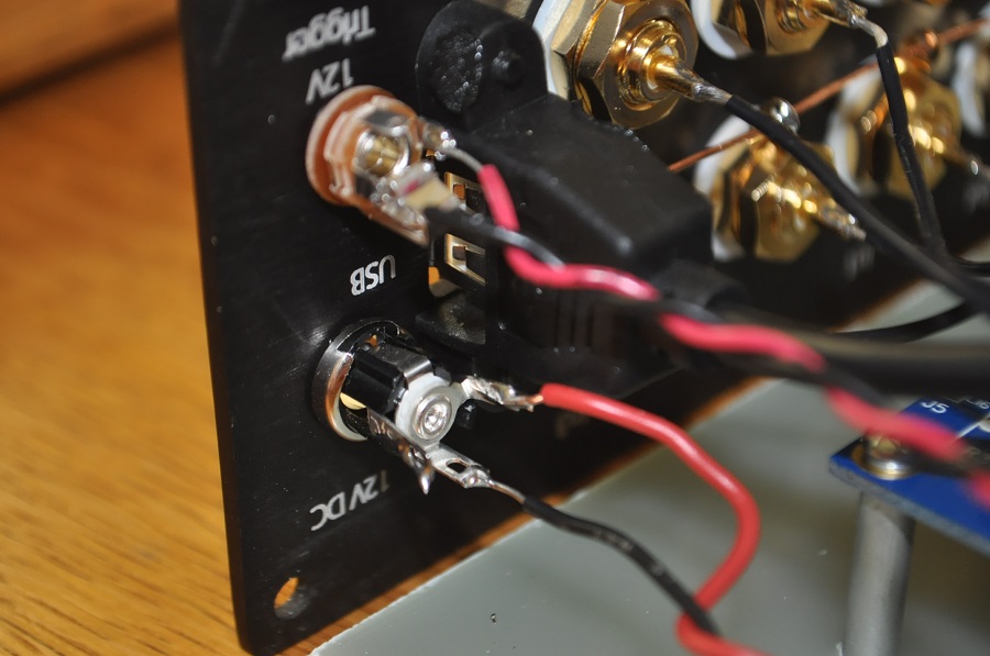

  Put this together. Chasing a hum. All 3 tube amps hum. I may try a d Class unit I have on the FR drivers next. Twisted pairs on 12v

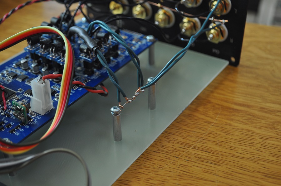

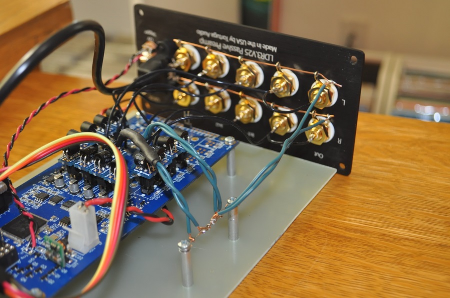

It's all but 100% certain that hum is being caused by a ground loop current somewhere in the system. Our preamps are coupled with all manner of tube amps without hum problems so it's not something inherent in the passive preamp or kits.
Take a few close-up photos of how you've wired up the ground connections including both power and signal grounds. Pics can be helpful in spotting problems.

  I might have this figured out. Trigger jack & power jack wiring needs a re-work.
Also, it appears (as far as I could tell from the photos) that you do not have a power ground wire running from the 12V jack to the star ground bus bar. That's required for calibration to work and many amps are not happy unless that ground connection is made.

« Reply #9 on: 12 Dec 2018, 08:04 pm »
 Quiet as a "Graveyard' now. Power Jack red to plug, black to 'bus', then to ground. Same with trigger. Wonderful and After I'm finished with chores I'll sit and listen. Volume control now has a linear feel to it as before it was as if every notch was 3db.
