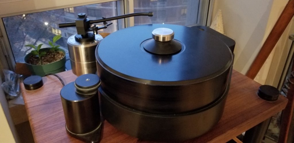

I built this standalone pod for a 2nd arm on my Scheu.  Not pretty but very solid and functional.  No sonic detriment that I could discern as it sounds at least as good as placing the arm on the table's stock mount.

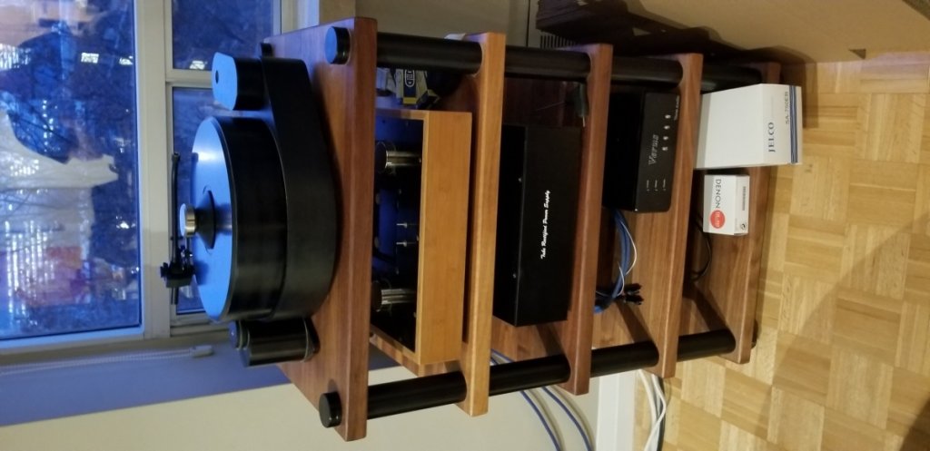

Getting closer.... very close.
So the arm-pod came today and I am impressed with this shiny brick (weighs quite a bit).  Lots of leveling options and a couple height adjustment options.  Drilled for the Jelco base perfectly.   Has enough heft with the bite of the cones into the wood shelf it ain't moving unless you basically pick it up and move it.
My Moerch tonearm arrived at Mr. Moerch's winter residence in California for repair, so hopefully we'll have some good news before too long on that front.  [still can't find where I packed my Dyn DV-20XH]
Two issues to solve before I start spinning.  1)  my tonearm cable is a bit too stiff to insert into the arm-pod without creasing it by my estimation.   I needed another tonearm cable when the Moerch comes back, so my current one will work with the cantilevered arm-board and I'll grab a more flexible cable set for the arm-pod.  2) ran out of outlets in my Furman conditioner, need to do a little house keeping to free up an outlet, minor but somewhat annoying.
Actually there is a minor issue 3) in that my phono stage have 4 switches, 4 tube sockets and two inputs and nothing is labeled.   I traced the circuit mostly to figure out which set of RCAs were for MM and which for MC.   Traced which switch was for MM/MC and which switch is for stepup (10X/20X).   The other two switches are for Mute and Mono/Stereo but I didn't determine which was which.   I also don't know which position is which for any of the above but process of elimination should lead to a solution.  I emailed DIYHiFiSupply and got no answer, nor an response on their forum board.

« Reply #31 on: 14 Dec 2018, 12:05 am »
Looks really nice Josh!     :thumb:
And I really like your rack.  DIY?  If so how'd you do it?
If not, link to mfr?
JoshK
Re: Tonearm height confusion
« Reply #32 on: 14 Dec 2018, 01:14 am »
Its a Canadian company based in Montreal iirc.
https://solidrack.ca/
