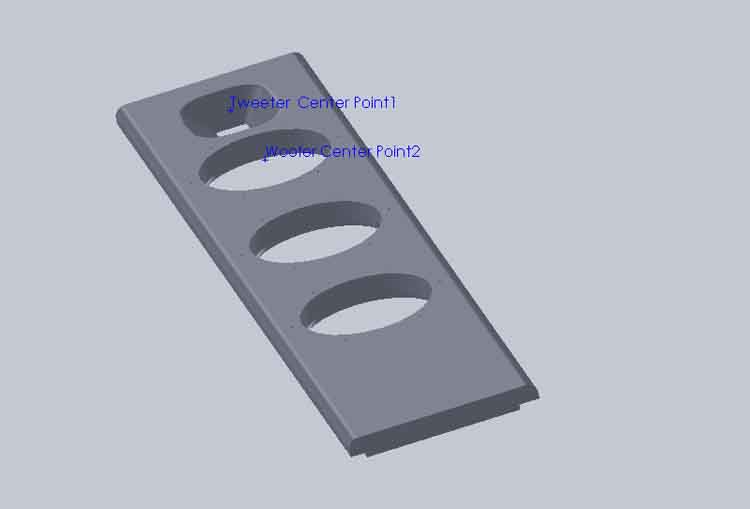

Here, I added enough length to the original model to  position the tweeter center at  37.5" then  spaced a couple M165's below the NQ  at the same spacing as the  Otica's.  After radius's, there's enough room on the rear for a .5" brace  between the  drivers, could space them a bit more  for a  .75"  brace.
jay

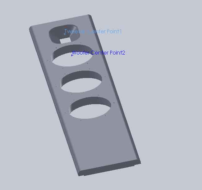

Goofed on that model,   it would be a sealaed cabinet  so the layout would be more like this to give the M165's  the necessary  air space.
jay
