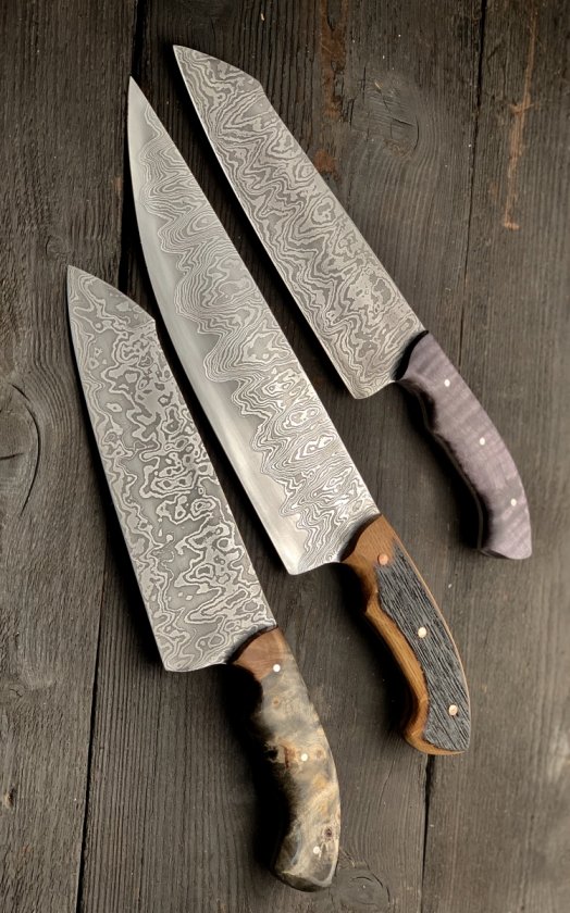

I would also note that the photo upload settings on this site is pretty limiting on resolution/clarity.  It is downsampling the JPEGs a good bit.    Happy to discuss more if you want to PM me.
For example, look at this image here compared to the same image uploaded on Instagram (file sizes are not that different either and both are compressed files):
- vs -
https://inkphy.com/media/BtTP7BjBvKa

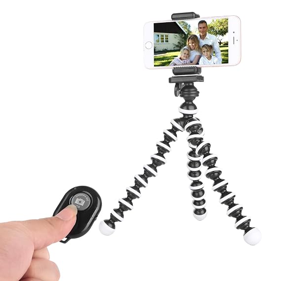

The main thing with the iphone - use something like this, or you will always get crap pictures:
