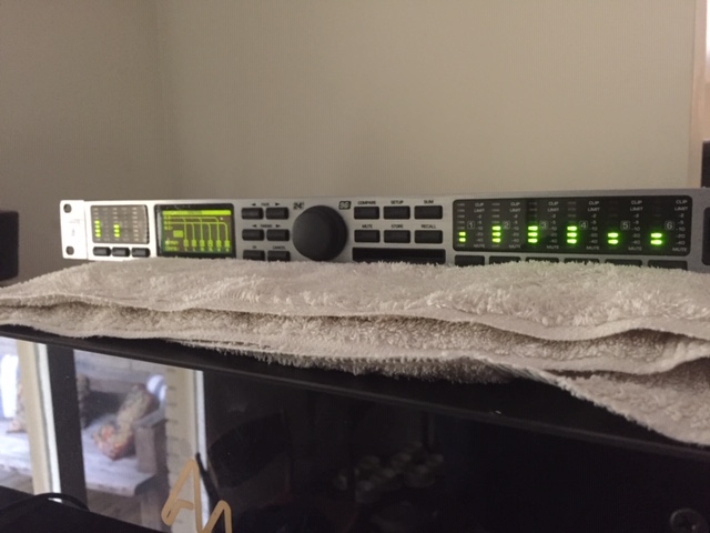

Connected XLR from the ANDAC to the 2496 and both the inputs and outputs lit up like a Christmas tree.
It has never looked like that coming from my Pre-Amp. Even when it worked.

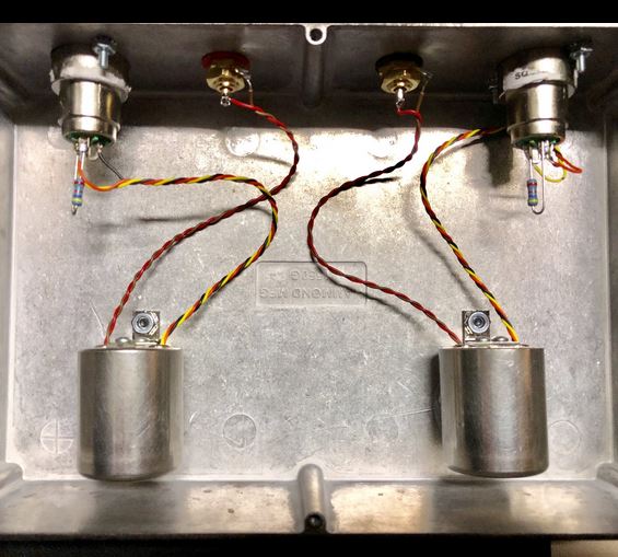

What about building an xlr to rca converter box... something like this.

That's passive by using a transformer, which is fine and is one method to the madness (there are other methods as well, using opamps or discrete circuitry and of course a power supply to support that). Incidentally, you'll notice that your AN dac is transformer coupled and that is how they are converting their single ended (RCA) signal into a balanced XLR signal.
Sure you can do all this, and you will be adding more to the signal path (which may be compromising fidelity), but that is up to you to decide depending on your budget and needs.

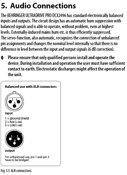

In the Manual:
