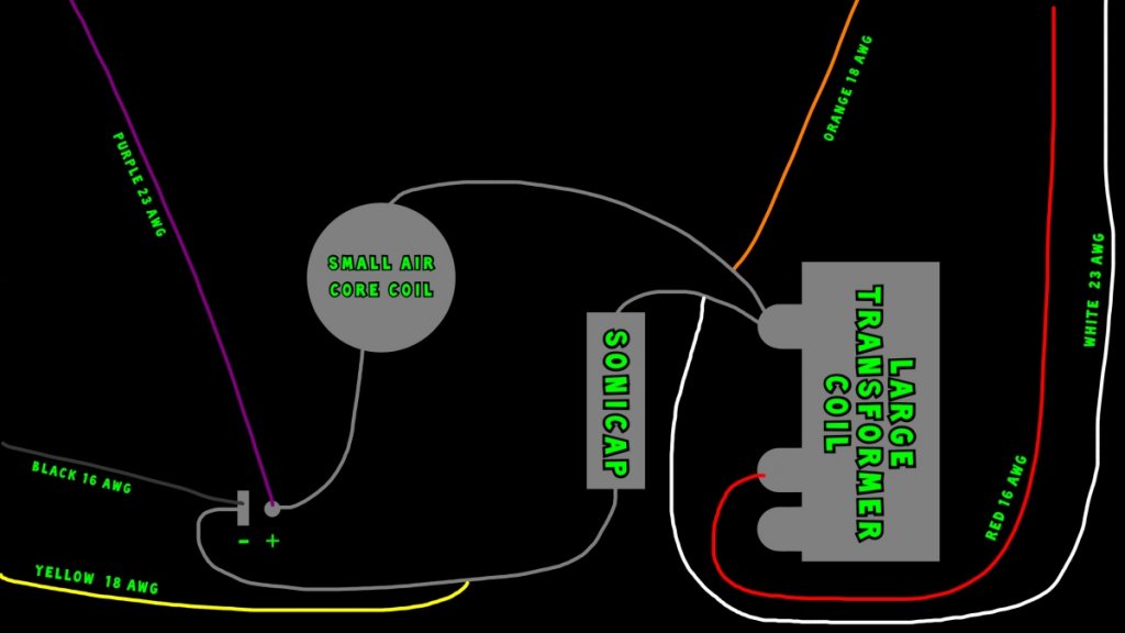

Andy just in case you wanted advice on how to improve your CX-100’s. The image below shows Sonic Craft’s recommended modifications for that model...

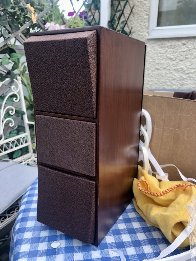

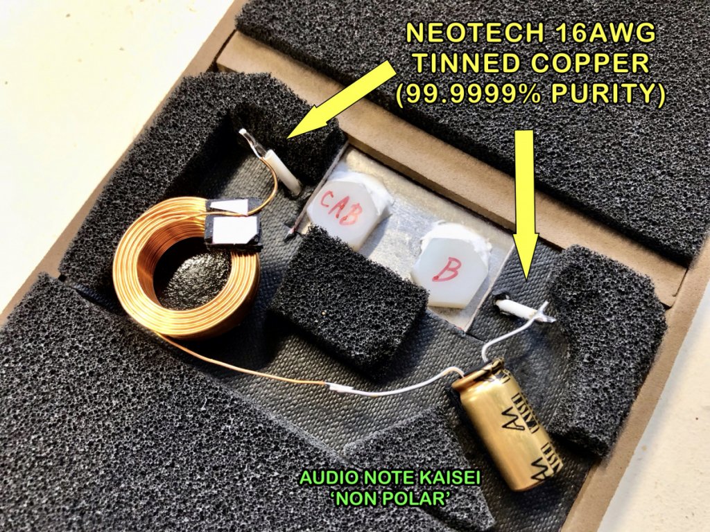

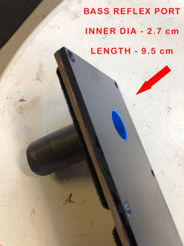

Updates coming soon. So far; I have covered the cabinets of my CX100’s with a simulated wood finish shown here (painted and wood stained). I have also changed the capacitor to an Audio Note Kaisei. Added bass reflex port and aluminium rear panel…

Thanks. As an experiment, I have disconnected the ‘bottom woofer’ and am not going to rely on it to supply the bass. Instead I am performing some simple surgery on the ‘upper mid/bass unit’ with a Dremel, by cutting the metal basket frame  holes larger to hopefully let more air out.  The bass port will be positioned directly behind the Mid/Bass unit.

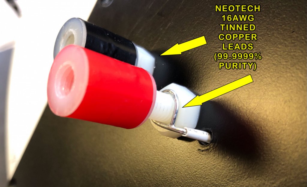

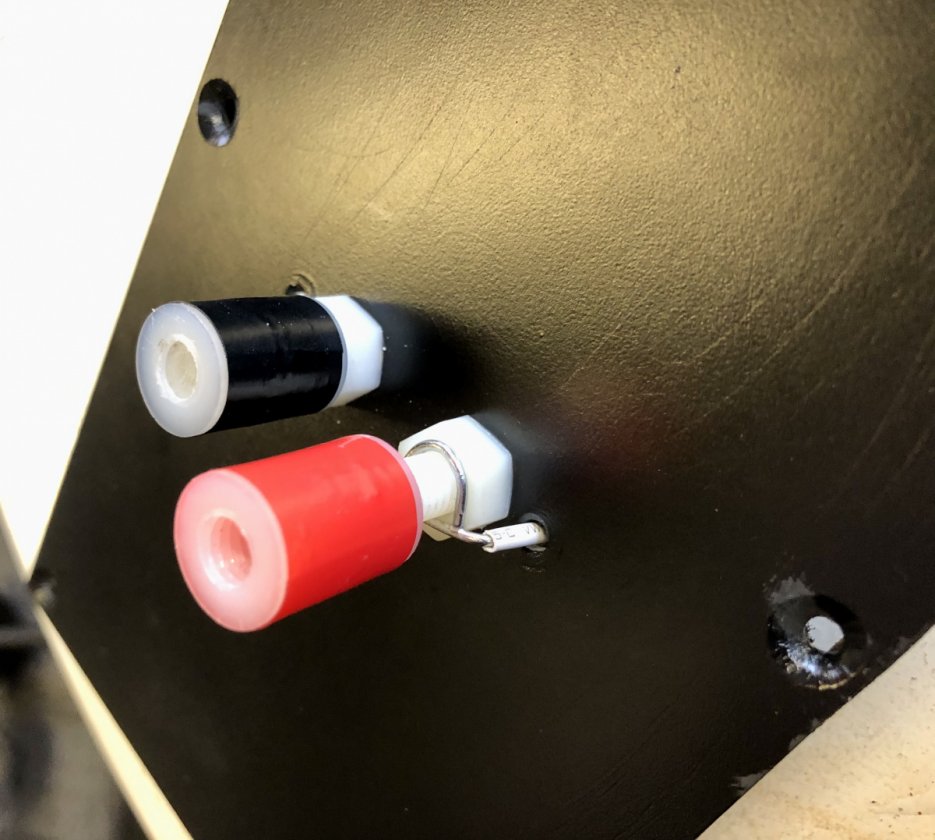

Correct. By the way; here is my speaker binding post method for the ultimate performance. It allows you to clamp your favourite speaker cable directly to the circuit board of the CX100.

Nice. Going to machine some TeCu posts this weekend to finish the Polk project and make some for the CX's also.
So was your port length and ID only calculated for the mid-bass?
Once you disconnect the woofers they effectively become a PR, no?

Hopefully I can rely on bass from the modified Mid/Woofer unit combined with the reflex port tube
