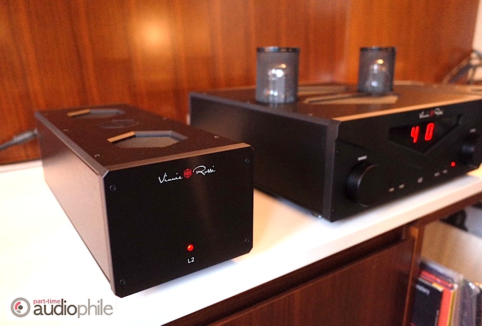

Just when I thought the RMAF 2018 Show Coverage was completed, Brian Hunter of Audio-Head just
posted:
https://audio-head.com/vinnie-rossi-l2-signature-preamp-and-monoblocks-rmaf-2018/
Quote from: Brian Hunter / Audio-Head.com
The slide guitar-infused Plowin’ Mule track by Doug MacLeod posted almost ghost-like focus for each instrument in the music field. It was certainly hard to tell where the speakers were placed, and if pressed to gander a guess, I would have implied a location much further back, behind the somewhat close, actual placement of the 40.2s. A fun party trick? An expensive hollowed gesture to scare trick-or-treaters? I say nay. Raw craftsmanship from two brands that gel together for power when needed and grace unyielding. Best imaging and focus of the show for me.
And he shows a hot top-view pic of the L2 Signature Preamplifier & Monoblocks, wired neatly with all Triode Wire Labs cabling:
Photo Credit: Brian Hunter / Audio-Head.com
Thanks for your post, Brian - and for coming in for a fun listen to our room demo!
Vinnie

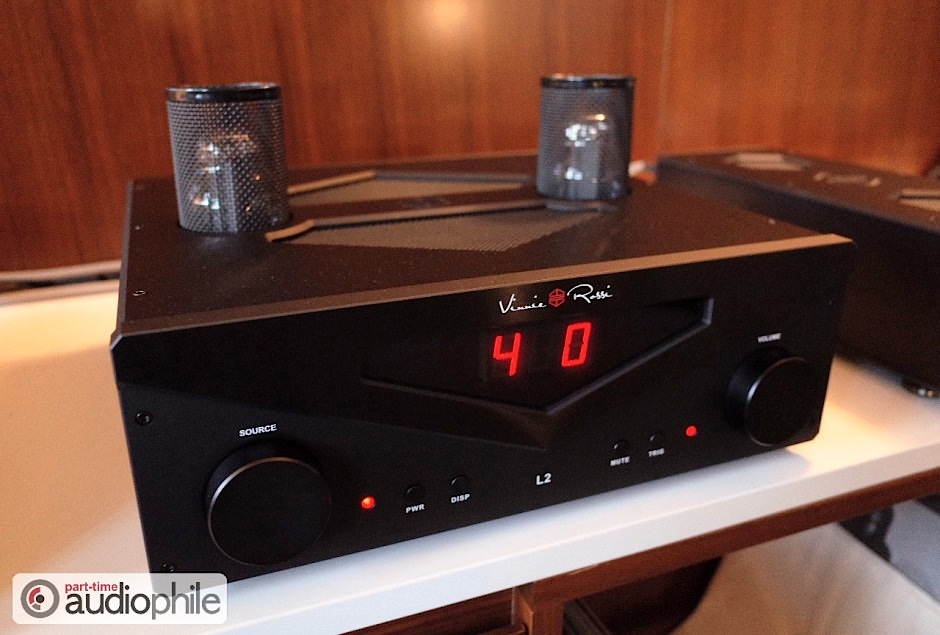

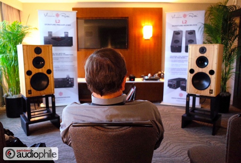

Eric Franklin Shook of Part-Time Audiophile already covered the Vinnie Rossi / Spatial Audio room, and today he
posed his full coverage of the Vinnie Rossi / Harbeth / Triode Wire Labs room:
https://parttimeaudiophile.com/2018/10/24/rmaf-2018-vinnie-rossi-triode-wire-labs-harbeth-more-than-the-sum-of-its-parts/
Quote from: Eric Franklin Shook of Part-Time Audiophile
Insight was available by the boatload. Bass attack, fast, but not bloated or overly thumpy. Mid-range, what I consider to be signature Harbeth, but turned upward and wider that I know from my previously smaller Harbeth experiences. Treble was where, for me, things shined. The insight came from imaging that hung afloat in the middle of the room like an apparition.
Photos by Eric Franklin Shook / Part-Time Audiophile.com
Many thanks again, Eric, for all your coverage of our rooms!  :wave:

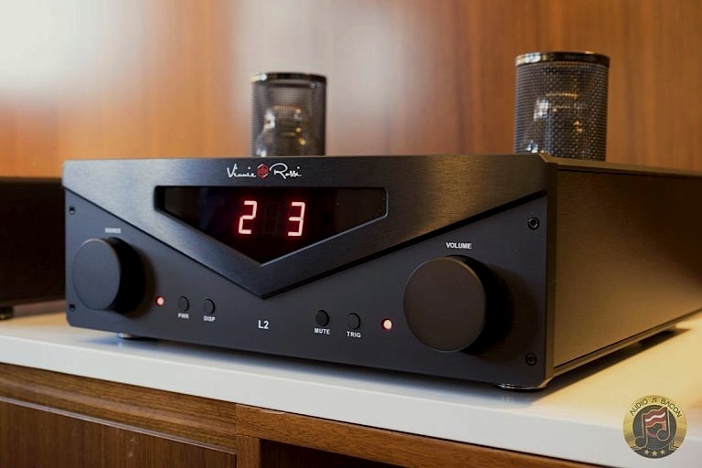

https://audiobacon.net/2018/10/30/rmaf-2018-photo-tour-coverage/2/
Quote from: Jay Luong / Audiobacon.net
If you ever wanted to hear a pair of Harbeth 40.2 speakers ($17,990/pr) disappear in a room, pair them new Vinnie Rossi gear and Triode Wire Labs cabling. Vinnie Rossi debuts his L2 Signature Preamplifier with DAC and Phono (21,985) and Monoblocks ($14,995/pair) at RMAF 2018.
Along with eye-opening clarity, imaging, and soundstage depth, these L2s were some of the best looking pieces of audio gear. That CNC-machined aluminum chassis is just sick.
Photo credit:  Jay Luong / Audiobacon.net
Thanks again, Jay!
Vinnie
