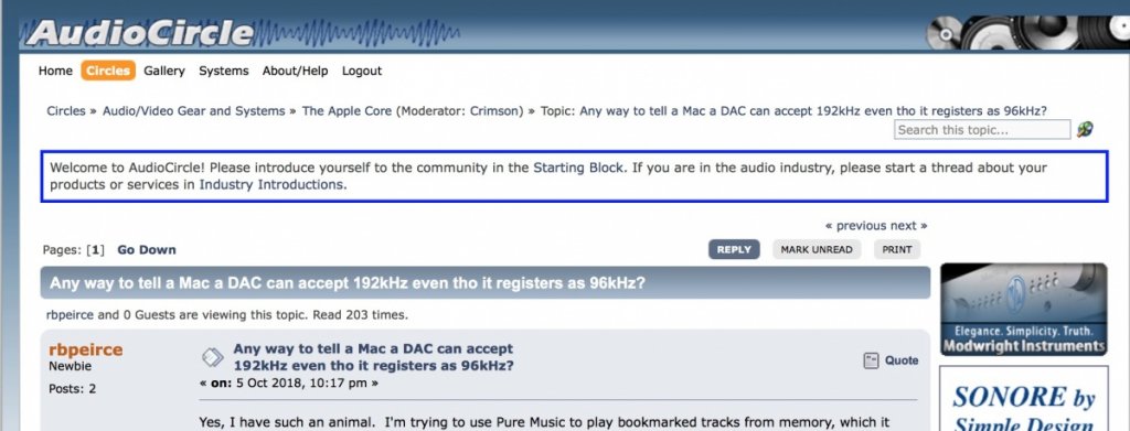

There is no notify button:
Sorry for the inconvenience.
Please read this, then please file a bug report here.
