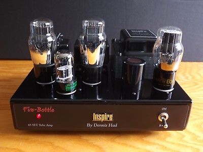

In 4 ohms it will delivery only 1W or less.Not exctly a bargain as a Sino amp and it need a preamp to drive it.
Photos show some caps are 10% precision.
It's made in America, not China.  By Dennis Had, founder of Cary Audio (now retired from there).
Oh nice, I needed you to remind me of that.
This pedigree made his amps valued.

Awe c’mon, look at this delicious piece of fruit. You know you want it! Ha, I know I do.
Does anybody know of any other 45 set amps besides the DH that are reasonably priced?

My problem is I really like stuff that looks good. I figure all this great gear sounds good to these old ears.
And this little DH amp looks great!

Dennis is become smarter with age, this 45 amp have two power on switches, one for filament, other for grid/plate.
