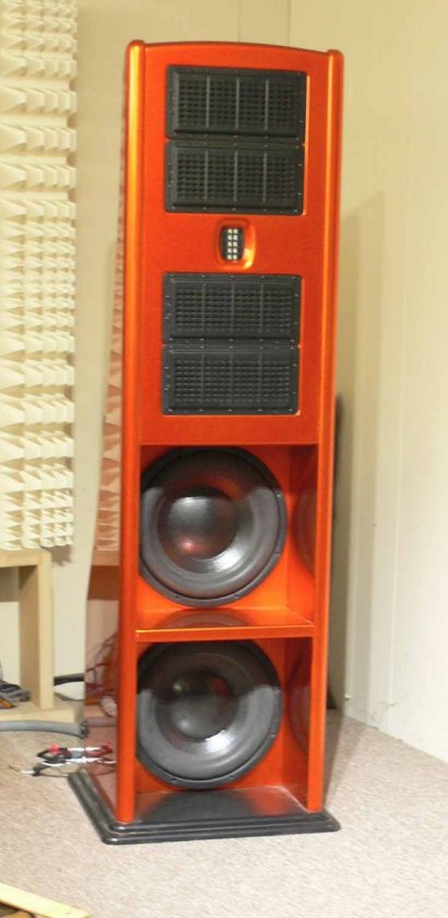

Totall :(y depends on wha  the customer  wants.
Our lacqar guy  is retty good but he is limited to  basic colors with a choice of shjeen but, no metallics  etc.
We also use a  guy who sprays exclusively  House of Kolor products but they add up fast  and  most  are  translucent so  multiple layers  are needed to get the desired deffect.
You probably saw these but here's a pic of  the  Super 7's  we recenly built, they are    done in House of Kolor  tangerine Kandy...  so  multiple layers of  primer/sealer  and block sanding , a base coat,  5 coats of  tangerine Kandy, then  2 coats of  the  HOK  Show Clear.  Material cost alone is up there but man,  the   paint is pretty  killer..
Wish pics  would show the depth.
  Lacqar guy did the  satin black bases.

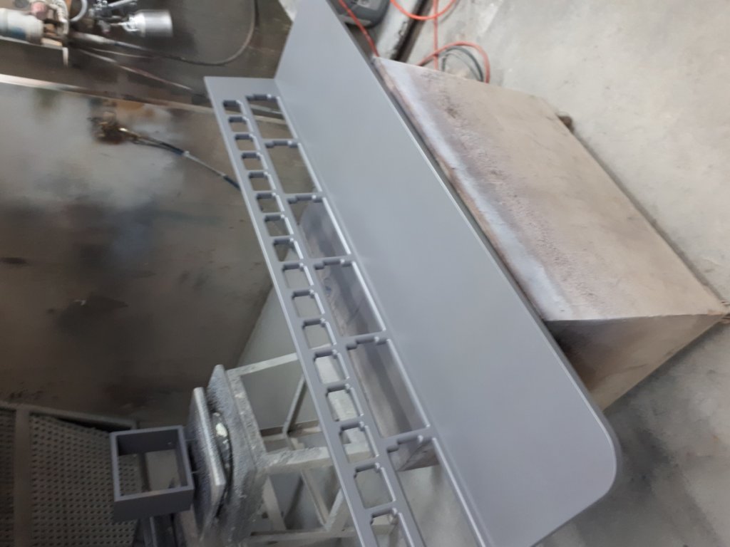

« Reply #84 on: 24 May 2019, 06:37 pm »
Base coats done.   A quick  block sanding  before   final color coats and  clear.

Those are going to look (and sound) INCREDIBLE!
Beautiful work there Jay!

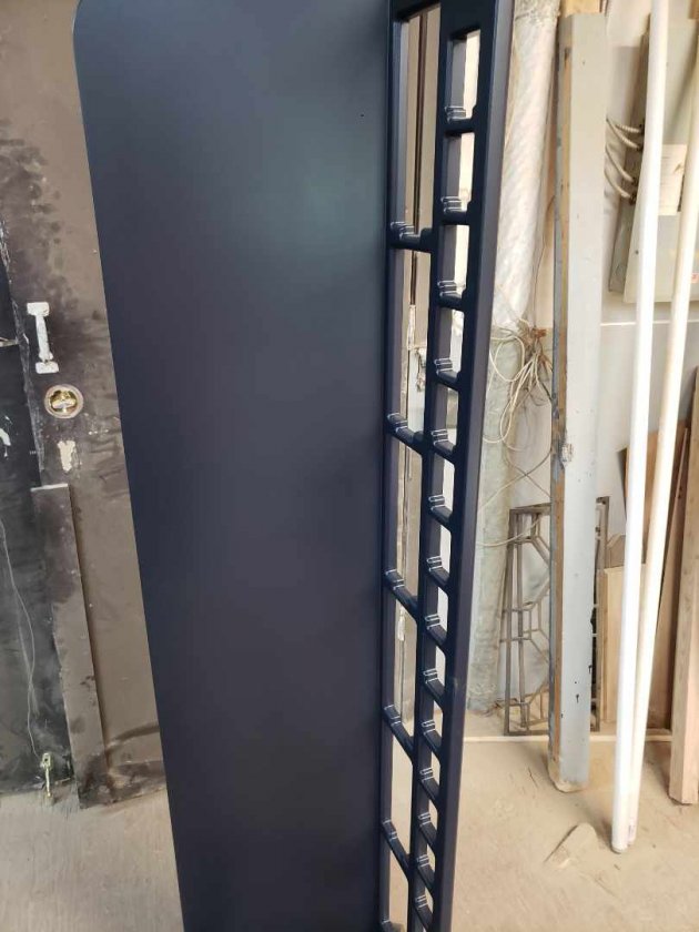

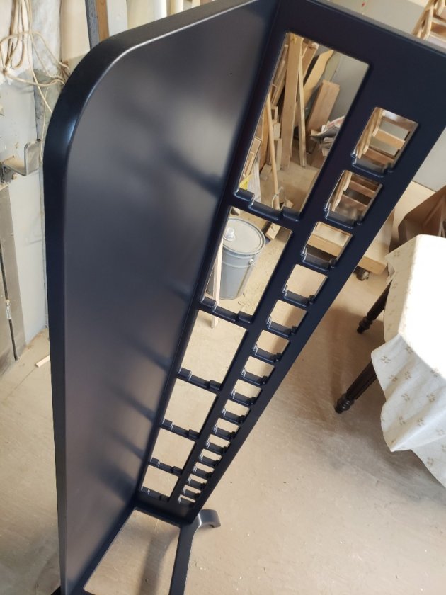

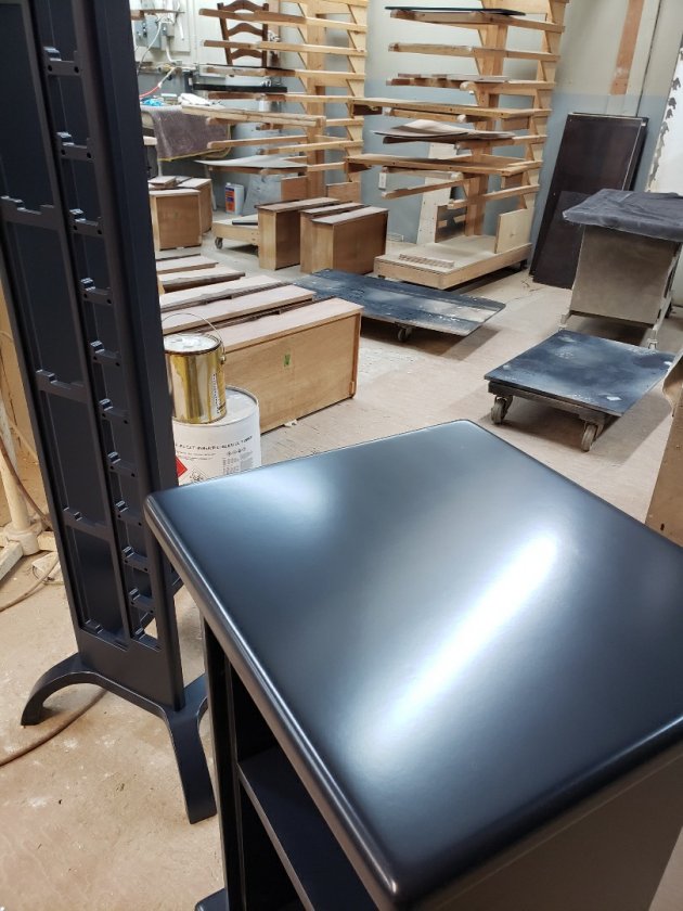

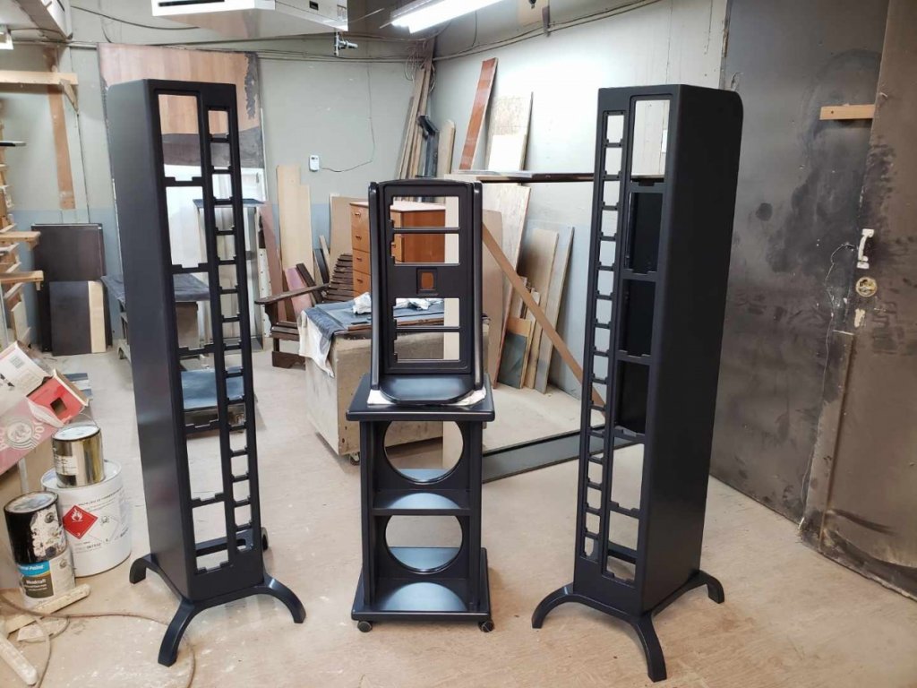

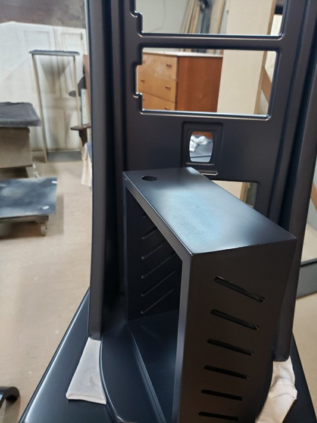

« Reply #90 on: 11 Jun 2019, 01:33 am »
Haven't seen  them in person yet, only   some pics. These are  going to be in a  theater orom so they are top coated with   flat  lacqar to keep reflections down.,  Matching  Super7 monitor and a dual h-frame   for a center channel.
Note,  the customer will be lying the   dual h-frame on it's side to keep the  tweeter  down to ear level for those inthe   theater.   He also has a  pair of triple h-frames  to mate with the  Line forces  :thumb:

Serious question: are you at all worried about them toppling over with accidental brushes/bumps? Or do they need a pretty strong smack to fall over?

« Reply #96 on: 11 Jun 2019, 10:29 pm »
Thanks   guys.  Anxious  to get them to the  customer !
No, they won't topple over, the base is  pretty wide, kind of deceiving.

Hi,
Line force paint is very successful what is its reference?
How deep is the side wing?
Re: Updated Line force (Super LS? )
« Reply #98 on: 22 Jun 2019, 03:23 pm »
Hi,
Color is matched to "Cracked Pepper" finished in 00 flat  lacquer.
Wing is approximately 14"  deep
