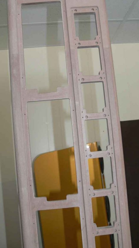

this first pair come out really  nice.  time to get them off to paint

Looks great Jay!   :D
ebag4
Re: Updated Line force (Super LS? )
« Reply #45 on: 27 Feb 2019, 12:42 am »
Wow, those look great Jay  :thumb:!

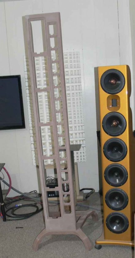

Man, they just dwarf the NX-Ottica.
grimace
« Reply #47 on: 27 Feb 2019, 12:46 am »
Yeah, I feel bad for them...you should probably find them a new home down here in North Carolina  :D

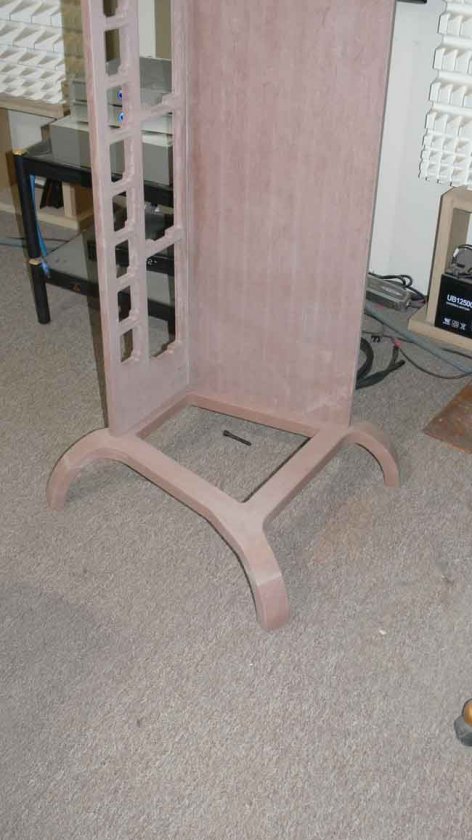

No,  I think we'll offer the flat packs as well.  the composite is expensive as is machining those  bases... not to mention building  custom boxes/crates  for   each pair.   Still chaaper than the   aluminum  pair  Danny originally  had  cut.
Waiting onthe composite   for the first pair to be cut.. hopefully  soon
jay

Thanks   Wade,  your comments  are much  appreciated. Quite a bit of time and effort  goes into  most of these  kits.
Is it still the plan to offer these as flat packs?  Presumably with the right adhesive it would be fairly straightforward to fix the wing to the baffle and then glue those to the base?
Yes, flat packs are available but   there is lead time, especially if we need to order the composite.   It's expensive and   can't   stock a ton of  it.  The good part is   all the   modeling, programming, test cuts  etc  are  out of the way, so it's just  amtter of  getting the  material and cuttinf.
Yes,  a special adhesive  is required, we  are working on  packaging small quantities  with  each  kit.  Only one  joing,  wing to  baffle.   After that,   there are 5 (2 in baffle, 3 in wing)  M8x1.25x60mm  threaded holes that align with  counter-bored  holes (no  golts will be visible)  in the bases.   so,  5 M8x1.25  x60-70mm   per speaker (included) secure the  speaker to the base.

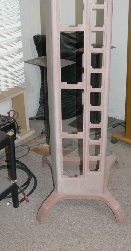

Wish my camera skills were better... a lot of attention to detail went intothese.  All exposed  edges have  tight , clean  1/8 radius (inluding all edges on the base).   Rear side of bbaffle  has   large radius's on all  driver  cutouts, all screw holes pre-drilled  etc  etc.  they  look better in person
