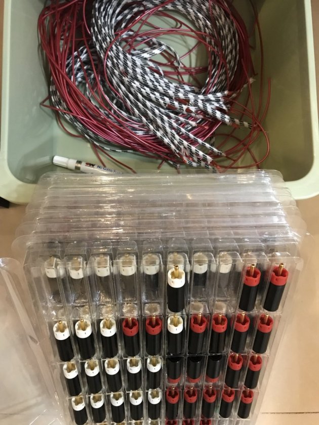

That's so great. BTW, whenever I see you post I'm reminded of the speaker cables you made years ago. I still have them and use them in the mix every so often, great cables!
Tomy that's awesome, hold on to them.  Complete unobtanium the Japanese plant closed and the amount of time I put into a pair of those was insane!  Striping the wire and hand braiding, someone should have turned me into the funny farm.  I need to make one last pair, my own!  AudioCircle also grew up, I got a family and started working at Royal Dutch Shell.  However, the bug never completely leaves you... my drawer next to my desk.
I haven't sold a cable for atleast 7 years though... so don't turn me into the police!  :wink: :wink: :wink:

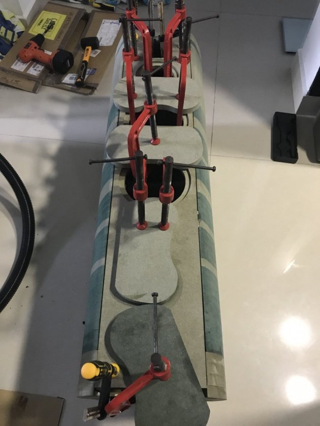

I received a question about how I attached the baffle and what steps I took to prevent moisture splitting the layers.  Below are a few pics and what I did to prevent splitting.
This pic is actually the baffle being glued into place.
This pic shows how each layer was a complete circle and the baffle attached as a separate unit.
To prevent splitting:
1). I used Moisture Resistant HDF
2). I made each ring like an O and not a C
3). I glued the inside of the cabinet
I believe this is overkill but should work.  If I was to do it over I would probably use the C approach to reduce material usage.  The ultimate would be to use a Baltic birch and stabilize it via vacuum and cactus juice.  I’ve seen posts where manufactures use glue and negative pressure to seal the mdf.
Have fun, Translam are awesome!
cremar
Re: Ceramica Translam
« Reply #68 on: 18 Jan 2020, 03:30 pm »
Thanks for responding so quickly!
I was hoping to go with a C shape to save on material.  When you say you glued the inside of the cabinet, do you mean as a sealer?  If so, I was thinking of using shellac...do you think that would work just as well?
HT cOz
« Reply #69 on: 18 Jan 2020, 05:18 pm »
I used a mixture of 50% wood glue and water inside the cabinet.  I don’t think anything would work better for sealing the inside.  It’s probably not worth the trouble to use a different method.  I think C shapes will work, definitely easier and less expensive.
