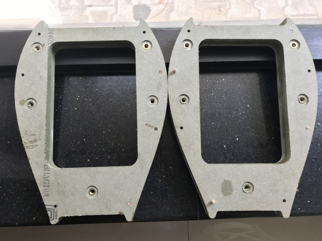

Finished the base section of the speaker and added the M8 screw inserts.  At 25mm these were not easy to screw into the tough HDF.

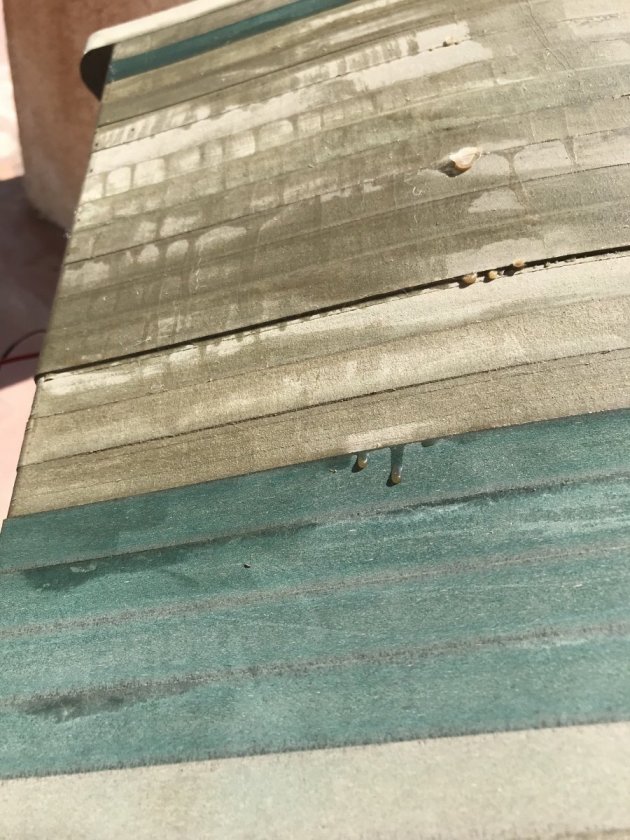

This was my worst joint which needed to be sanded smooth.  I'm not sure what happened to cause the shift could be a lot of factors maybe more than one coming together.
19 minutes later with 60 grit sand paper it is all worked out.

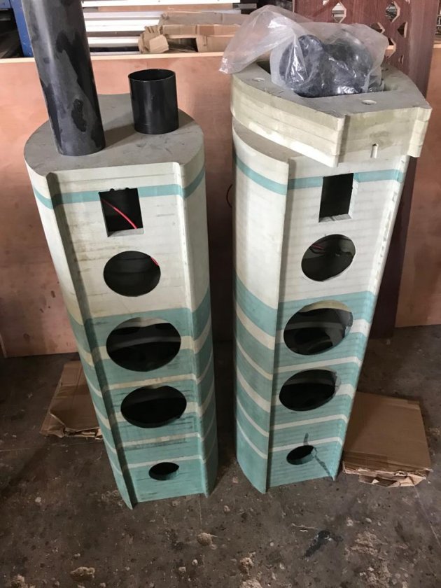

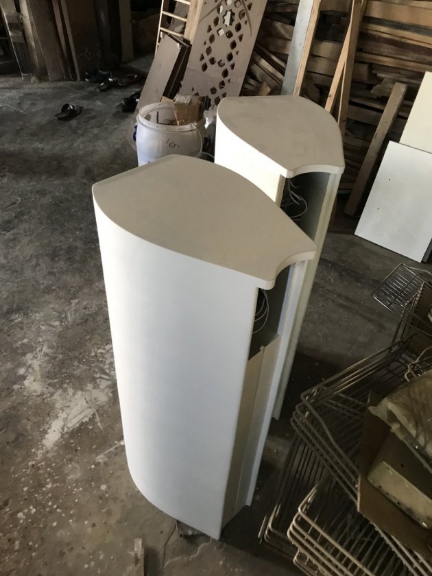

Ready for the next stage: Mount port tube, sand and fill gaps, and pre-paint
I dropped the speakers off at the CNC shop for hole cutting and fabrication of a mount for the port tube.  I know slight cheating but I'm not into buying 220v tools!  :green:

Really enjoying watching your progress. Didn't catch what was so tricky about the bass reflex port though...?
HT cOz
Re: Ceramica Translam
« Reply #43 on: 21 Feb 2019, 11:12 am »
The difficulty is in cutting the exact hole to fit the port. It’s back on track now.

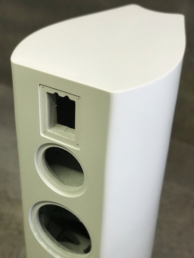

« Reply #45 on: 23 Mar 2019, 01:43 pm »

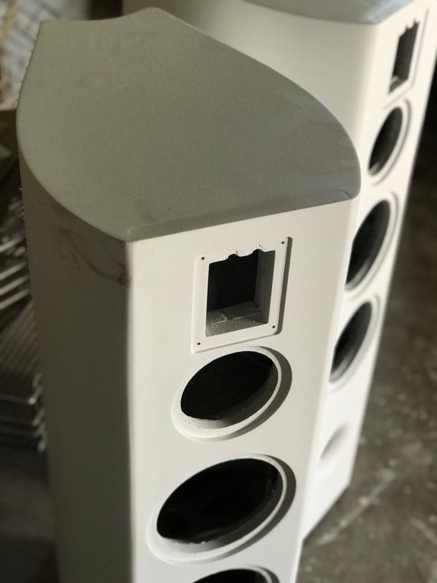

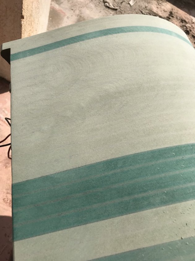

Ceramica work continues, baffle is glued up and first coat of primer is on.  I have to make a choice between light and dark...  :eyebrows:

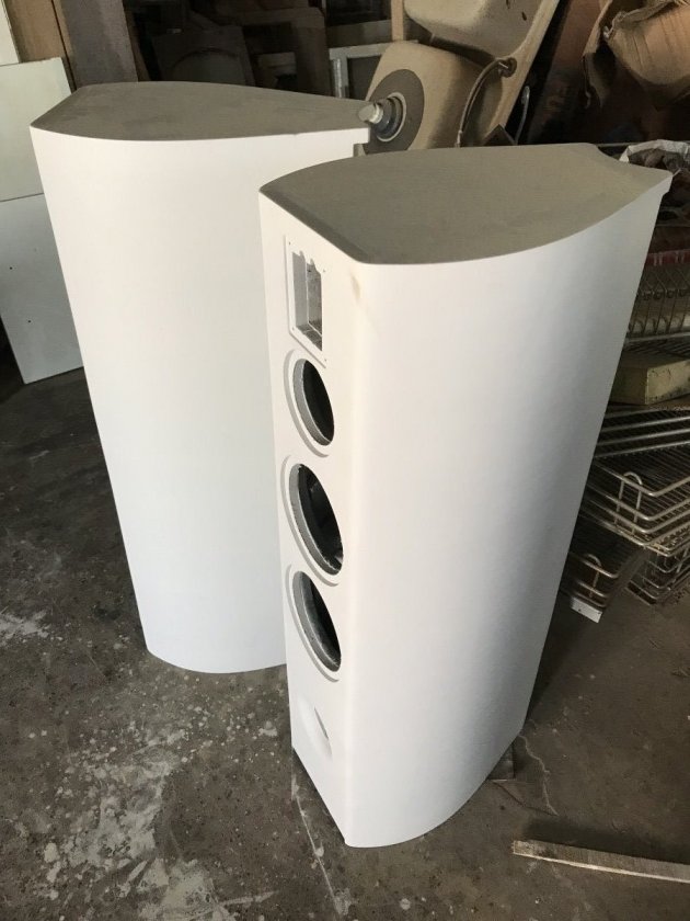

« Reply #47 on: 13 Apr 2019, 06:40 am »

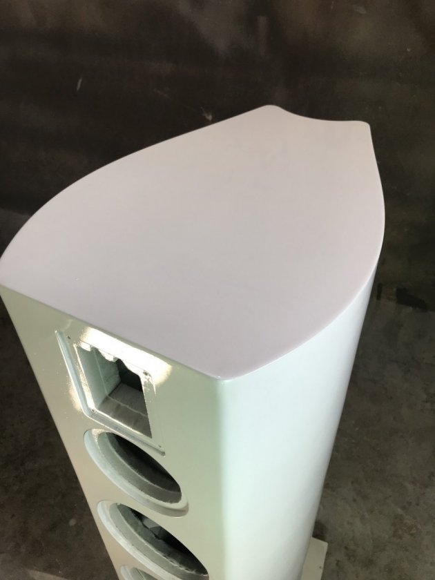

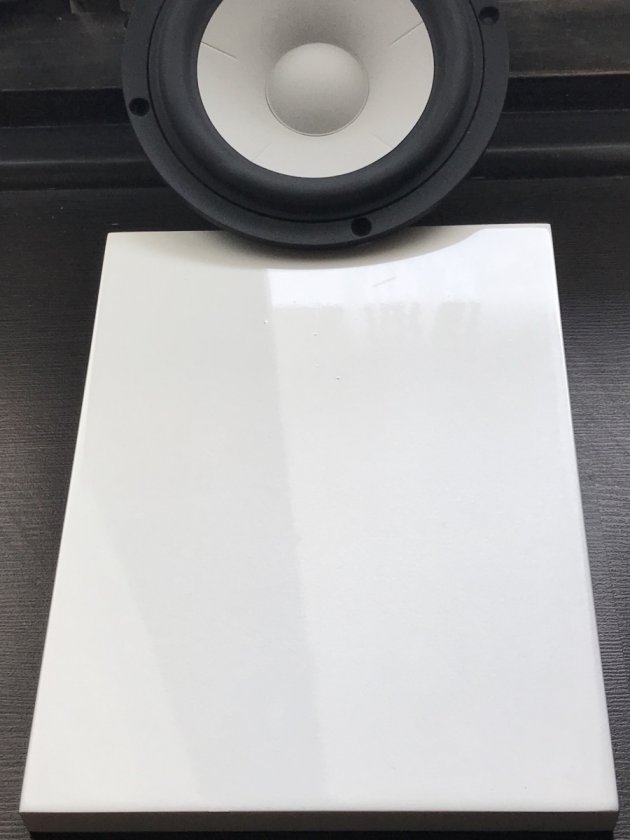

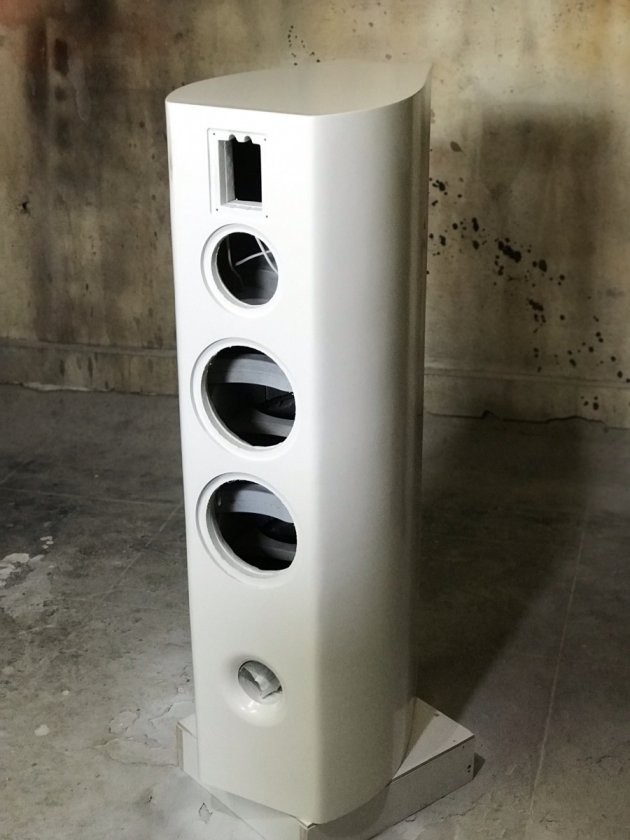

More progress on the build. I’ve selected a very white pearl with high gloss finish. You can see sample below. We’ve done two layers of primer and two layers of paint. White is pretty tough as the dark HDF shows through and especially since all sides are end joints. So I’ve instructed the crew to paint, sand, paint, sand until it’s perfect.

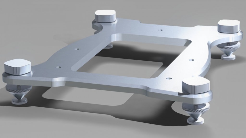

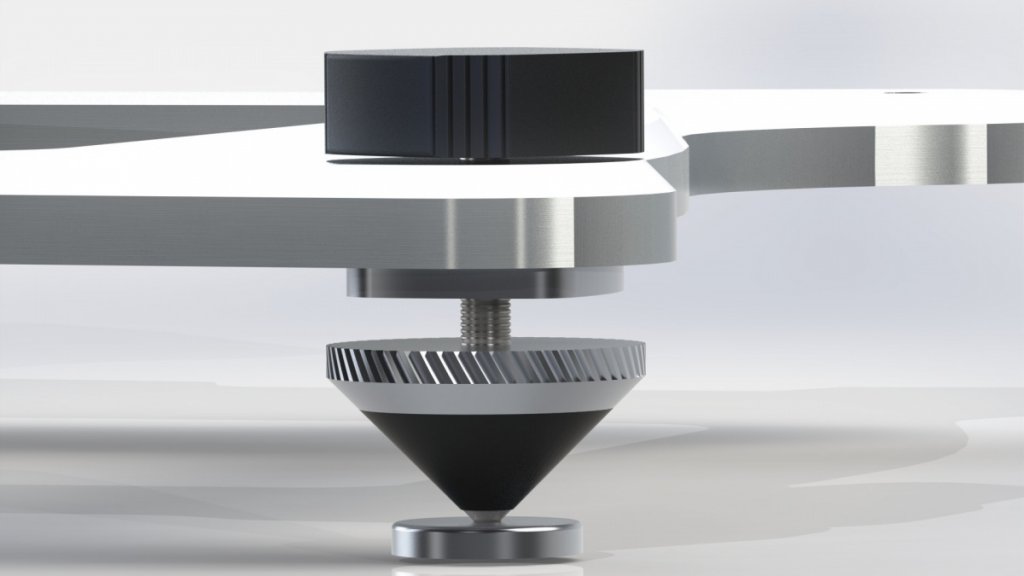

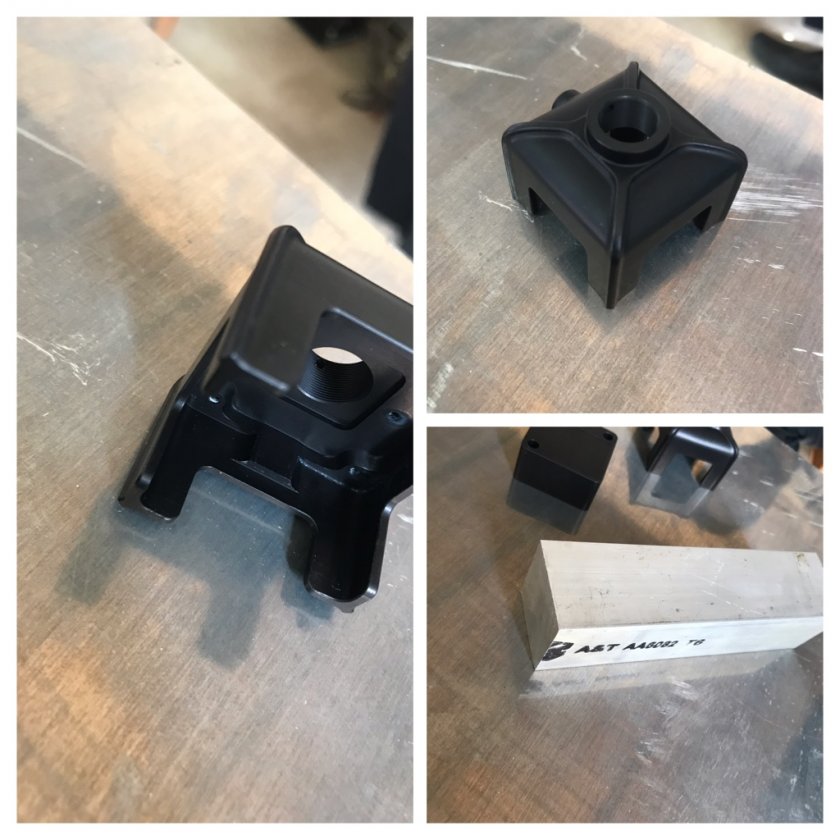

Next up is the speaker bases, they need to be machined from aluminum and it took me a while to find the right people. Finally I found a great group who is a team of five with 2,3,4,5 axis CNC equipment and on-site engineers. This is an example of small camera parts they are building from aluminum stock in the 5 axis machine.  Looking forward to seeing these bases next week.

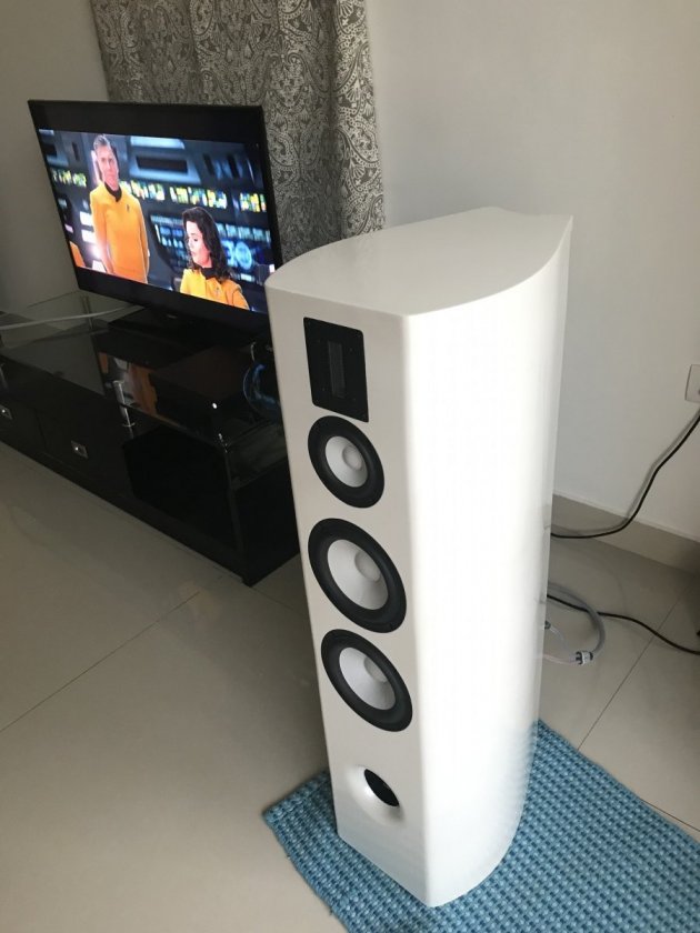

« Reply #48 on: 18 Apr 2019, 10:46 am »

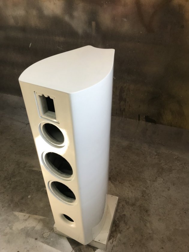

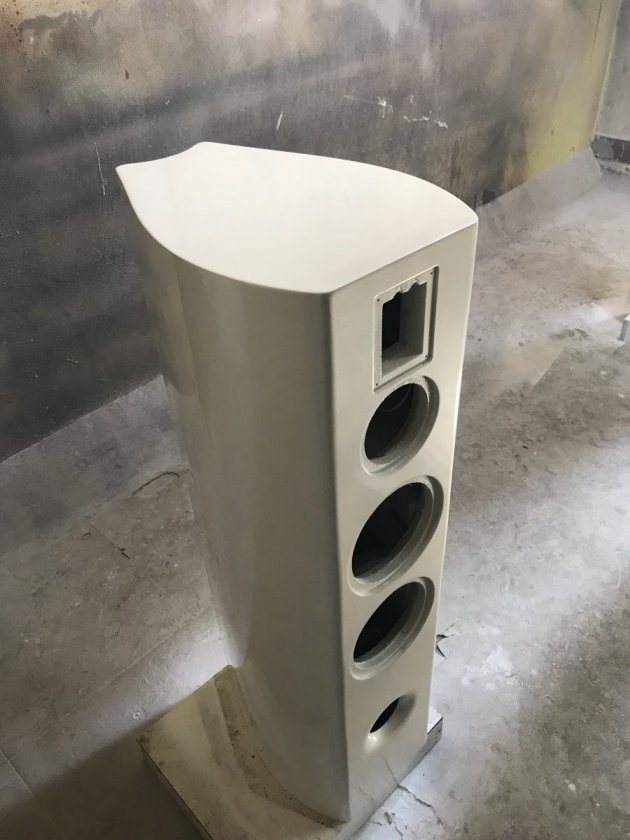

Pearl gloss while paint is finished, next stop final assembly!

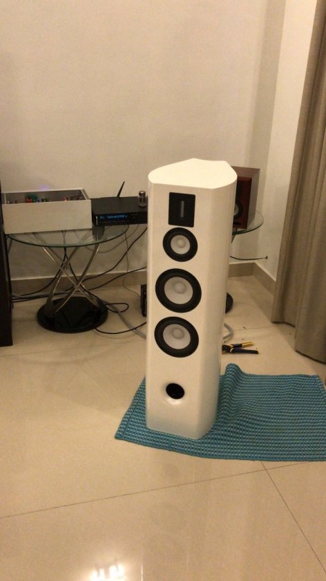

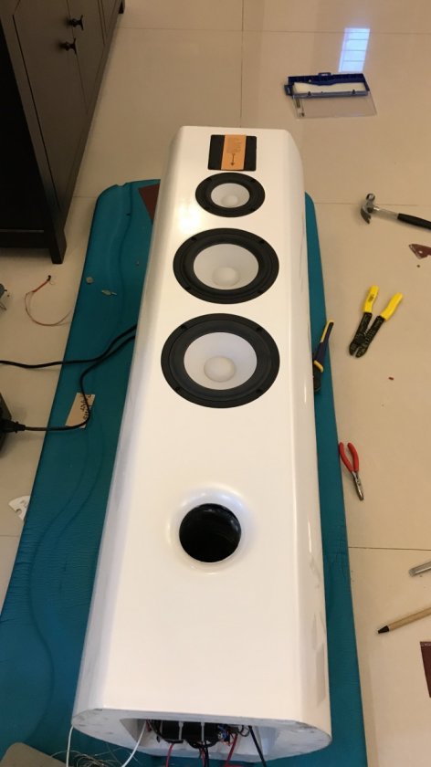

« Reply #50 on: 20 Apr 2019, 03:20 am »

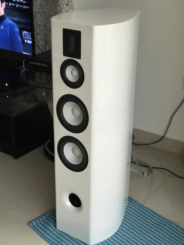

One done and one to go...
HT cOz
« Reply #51 on: 21 Apr 2019, 04:31 pm »
Getting closer, next stop is getting the bases completed.

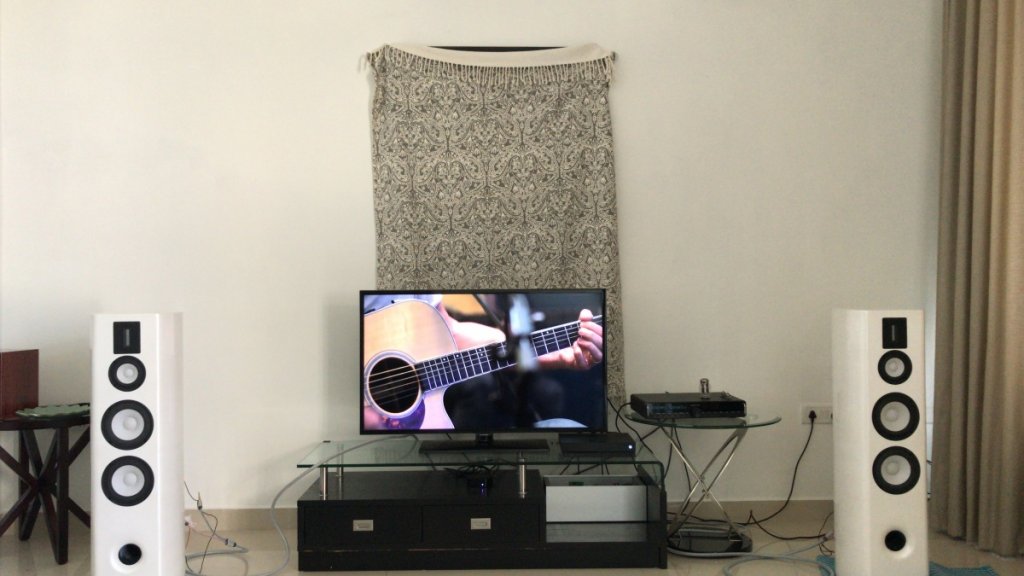

« Reply #54 on: 22 Apr 2019, 04:45 am »
Thanks all!  It is exciting as I’ve dreamed of doing an epic build for a long time.  Last night I noticed that my amp was having problems so I’ve not really listened to them properly.  I’m wishing that I had chosen a different path on my amp. It’s all good though and part of the journey.
Rick has been great and answered all my questions along the way. If you want a kit he is a great resource and provider of high quality speakers.
I wish I could do another to apply all the lessons that I’ve learned. Some real surprises here and there.
