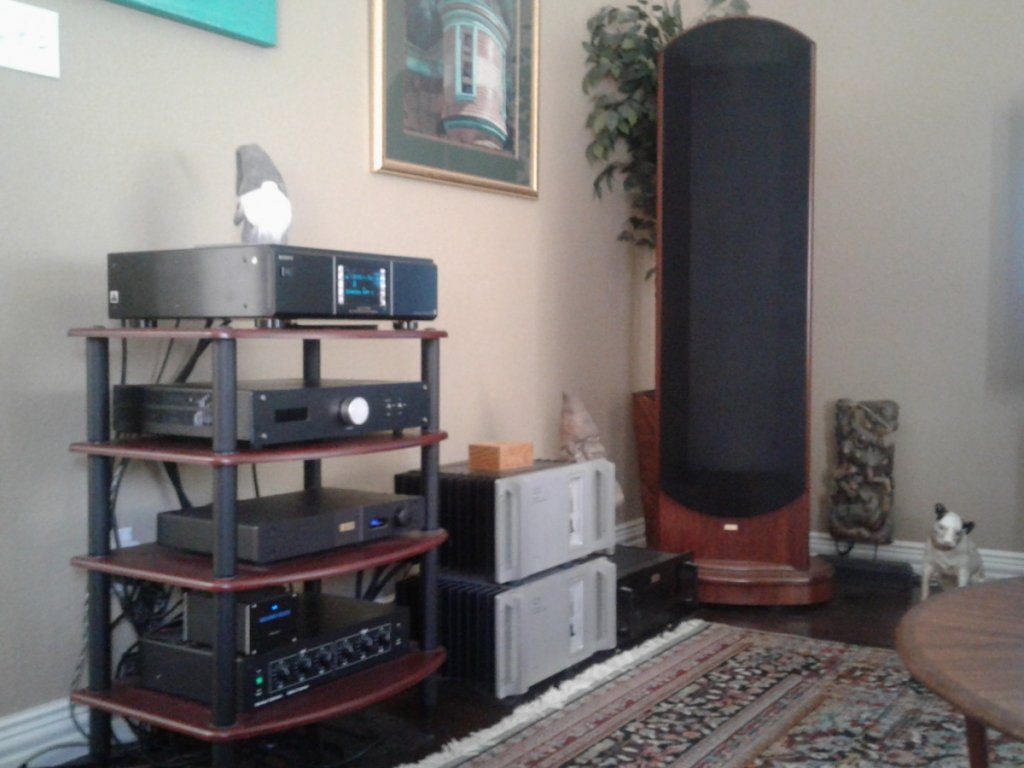

I am a newbie here. I just had the Tortuga board and OLED installed in my vacuum tube pre amp. I must admit that I am silly happy with the results. I guess my next step would be to see if there are any gains by altering the impedance. I'll go with 4 more impedance values, every 20 k ohms. What can be expected sonically as I bump up the impedance?
This is my rig:
